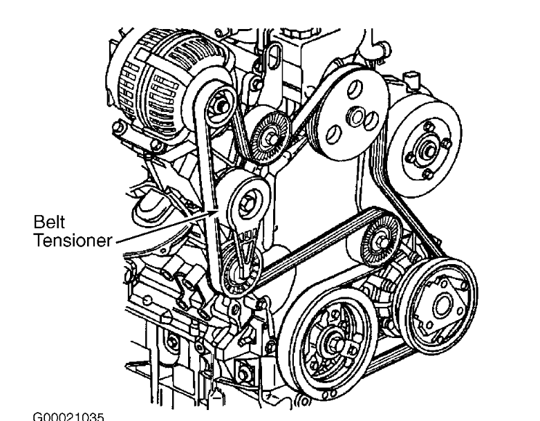

Check to see if your pulleys are lining up an dnot off use astraight edge for this. Then check the belt for bad grooves to many grooves on it. Like not a belt with 7 grooves and 6 on your pulleys. If the belt is frayed at all on either edge replaceit. And it should be anew belt as well. The routing i'm sending is for a 3.4L as you didn't say what engine you have

I need a diagram of the belt routing for this model.

My belt tensioner came apart shredding my belt.I have replace the belt tensioner.I would like to know how to install a new serpentine belt

Hi
The serpentine belt broke and I was looking for information on putting a new one on.
My main question is how to retract the spring loaded tensioner.
I am presuming a wrench on the bolt at the front of the tensioner will do it but want to be sure.
It is a 3.1 litre v6 with the alt on the top left.
I am pretty sure I have found a digram of the routing for the belt ( car was painted and I can't find one on the vehicle ) but if you could provide that as well that would be great

https://www.2carpros.com/car_repair_information/tec_info/2000/pontiac/grand_am/2000_pontiac_grand%20am_drive_belt_routing_diagram.htm
click the link and it will take you all the pictures you may need
locate the tensioner and pull away from the belt

There is a tension bar which you can buy or rent from most auto part stores for like $30. It will make life alot easier for you when you replace the belt.
