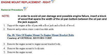

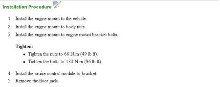

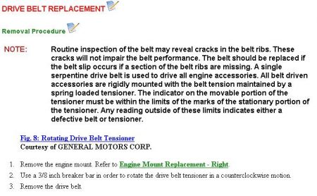

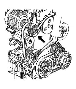

I have a 2005 pontica Grand AM V6. I just broke the belt and bought a new one, I have changed many belts before. For some reason this belt is giving me a hard time, It seems to need to be around the motor mount to go on the pullies. Do I have to remove the motor mount replace the belt? Or is there some way of threading it throught so I do not have to take the motor mount off? Please help Thank you
Jan 26, 2009 at 6:47 PM
ZACKMAN
  • 4,202 POSTS
You do have to remove the engine mount to replace the belt.

PASTOR2
I can get the belt off the pulleys by relasing the tensioner, but cannot get belt up past what seems to be a motor mount. Must I remove this mount or is there some way to thread the belt off that I am not seeing?

MMPRINCE4000
  • 8,548 POSTS
If mount is inside the belt loop, then it must be removed.

SATURNTECH9
  • 30,869 POSTS
Put a floor jack with a piece of wood under the oil pan then pop loose the top engine mounts out.Then you can jack the engine up to get clearance to change the belt.Then you have to release the belt tenisor while removing the belt and putting the new one on.

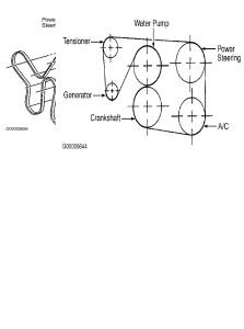

where can i get a serpentine belt routing diagram
Jul 28, 2020 at 12:58 PM (Merged)
BMRFIXIT
  • 19,053 POSTS
this is the link for the serpentine belt routing diagrams
https://www.2carpros.com/diagrams/pontiac/grand-am/2004

2001 Pontiac Grand Am/ 3.4L V6/62000 miles. I bought a new accessory drive belt to replace old one. But to remove old belt, there is a heavy aluminum mounting type bracket bolted between the engine and the body that must be removed.. does the engine have to be supported to remove this bracket safely? Please help with info. thanks. :?: :P
Jul 28, 2020 at 1:03 PM (Merged)
BOOTDOG
  • 665 POSTS
yes you'll need to support the engine before removing the mount. find a stable place underneath the car to support the engine. don't use the oil pan for support. good luck on your repairs

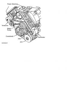

BMRFIXIT
  • 19,053 POSTS
https://images.2carpros.com/forum/automotive_pictures/99387_01GPv6_1.jpg
https://images.2carpros.com/forum/automotive_pictures/99387_01GPv61_1.jpg
https://images.2carpros.com/forum/automotive_pictures/99387_01GPv62_1.jpg
https://images.2carpros.com/forum/automotive_pictures/99387_01GPv64_1.jpg

  • 48,601 POSTS

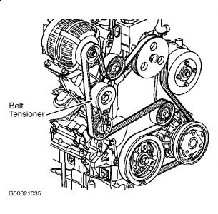

check to see if your pulleys are lining up an dnot off use astraight edge for this. then check the belt for bad grooves to many grooves on it. Like not a belt with 7 grooves and 6 on your pulleys. if the belt is frayed at all on either edge replaceit. and it should be anew belt as well. the routing i'm sending is for a 3.4L as you didn't say what engine you have

my belt tensioner came apart shredding my belt.i have replace the belt tensioner.i would like to know how to install a new serpentine belt

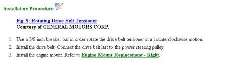

GELMAN
Hi
The serpentine belt broke and I was looking for information on putting a new one on.
My main question is how to retract the spring loaded tensioner.
I am presuming a wrench on the bolt at the front of the tensioner will do it but want to be sure.

https://www.2carpros.com/car_repair_information/tec_info/2000/pontiac/grand_am/2000_pontiac_grand%20am_drive_belt_routing_diagram.htm
click the link and it will take you all the pictures you may need
locate the tensioner and pull away from the belt
Jul 28, 2020 at 1:04 PM (Merged)
LDOOLEY
there is a tension bar which you can buy or rent from most auto part stores for like $30. it will make life alot easier for you when you replace the belt.
