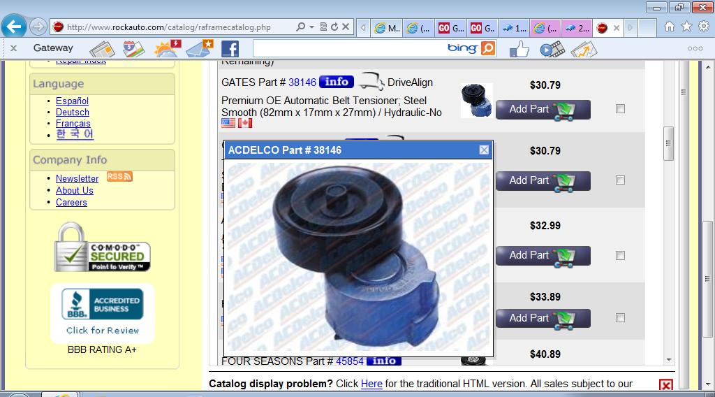

Does it look like the one i posted?
Jul 28, 2020 at 1:08 PM (Merged)
FUNNYF
  • 17 POSTS
Yes, that looks like it.. the main bolt that holds tenisor onto motor broke, not the bolt that just holds pully onto the spring tenisor. HOW DO I GET TO IT to get broken threaded thats broke off in block? thank you!

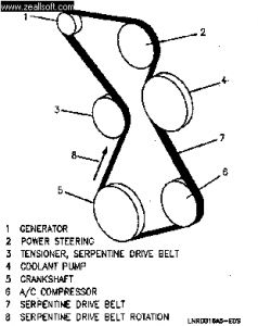

how to change the tensioner belt on the grand am, belt diagram is G00005645.not the belt, the part that ajust the belt
BUDDYCRAIGG
  • 2,262 POSTS
it's pretty easy,
you need to let the pressure off of the belt.
I can not do it on my 96 Grand Am with normal hand tools,
So I finally broke down and bought one
if you have an autozone in your area, they have this kit on sale for 25 bucks right now.
once the belt is of, then i think it just an 18mm socket thats needed to remove the tensioner.
good luck

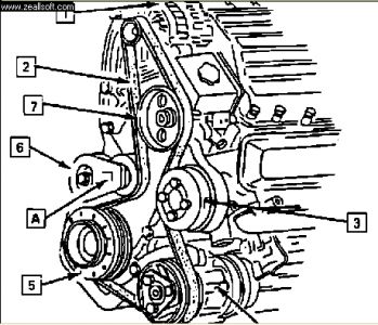

BLAZER91_PA
Other Category problem
1995 Pontiac Grand Am 3.1 139000 miles
serpentine belt diagram and can i replace belt without removing motor mount
BMRFIXIT
  • 19,053 POSTS
https://images.2carpros.com/forum/automotive_pictures/99387_s10_3.jpg
https://images.2carpros.com/forum/automotive_pictures/99387_s100_1.jpg
have to remove the mout
