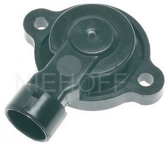

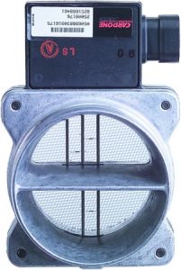

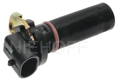

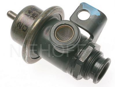

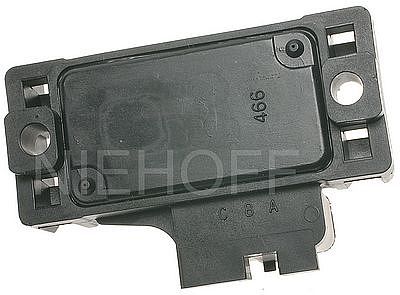

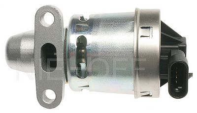

Occasionally, car stops when braking and/or turning and or stopping. Engine can be stsrted right back. Did several things including repairs recommended by dealer after diagnosis. They told me there was excessive carbon deposit at several places and wanted thorough cleaning. I did all those including combustion cleaning, new air filter, cleaning air intake manifold, new fuel filter, etc. Some other mechanic suggested cleaning/replacing IAC (don't know what it is or I may have heard it wrong) which is the only thing left to do. I am really tired of this car now.

ROUGH, UNSTABLE OR INCORRECT IDLE, STALLING Symptom Definition Engine runs unevenly at idle. If severe enough, vehicle will shake. Idle may vary in RPM. Either problem may cause stalling. Engine idles at incorrect RPM. Possible Cause & Correction Check the following items:  Ensure throttle linkage and/or TP sensor is not sticking or binding. Ensure throttle bore is free of foreign material.
https://images.2carpros.com/forum/automotive_pictures/55316_01grandamtps_1.jpg

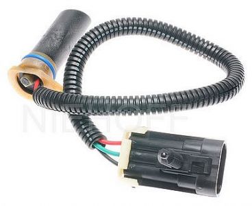

 Check for proper operation of crankshaft position sensor.
https://images.2carpros.com/forum/automotive_pictures/55316_01grandamckps_1.jpg

 Check for proper operation of EGR system.
https://images.2carpros.com/forum/automotive_pictures/55316_01grandamegr_1.jpg
 Check charging system output. Repair charging system if voltage is less than 9 volts or more than 16 volts.  Check for fuel in pressure regulator vacuum hose. If fuel is present, replace regulator.
https://images.2carpros.com/forum/automotive_pictures/55316_01grandamfpr_1.jpg
 Check evaporative emission control system.  Check for proper spark plug gap, and check engine compression.  Check PCM grounds for clean and tight connections. Check Manifold Absolute Pressure (MAP) or Mass Airflow (MAF) sensors for proper operation.
https://images.2carpros.com/forum/automotive_pictures/55316_01grandammap_1.jpg
https://images.2carpros.com/forum/automotive_pictures/55316_01grandammaf_1.jpg
