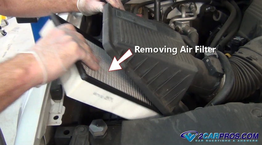

Once the hold down bolts or clips have been removed or released, gently pull up and remove the lid to expose the filter.
installing air filter housing lid
Reach into the housing and grasp it, sometimes it can be stuck in the housing due to the filter seal which is made of rubber and has been pressed into place by the housing lid. If the filter is stuck use a standard screwdriver it pry it loose.
removing air filter

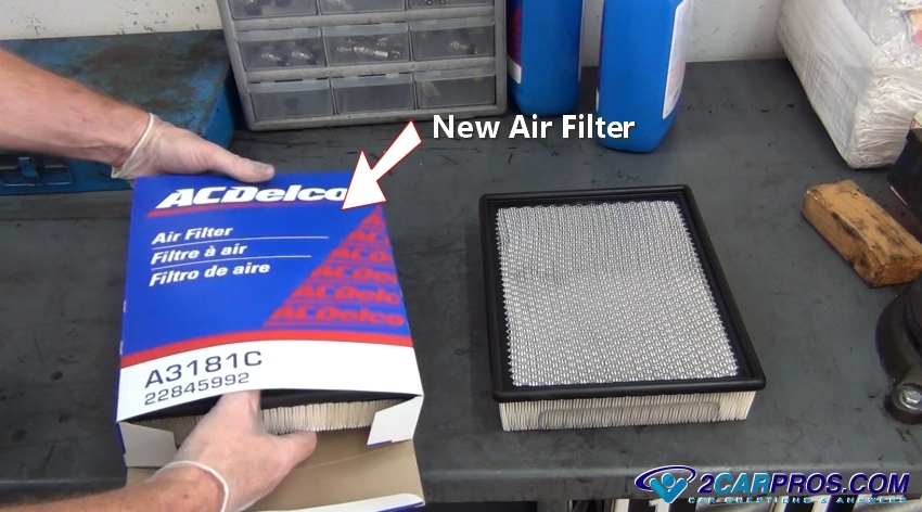

Step 4: New Air Filter Installation
Remove the new air filter from the box and match the old filter to the old unit they should be an identical in length, height and thickness.
matching old air filter to new filter

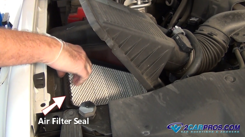

When installing the new air filter use caution as not to bend or disfigure it in anyway, this could cause the filter to not seal completely within the housing. Make sure to hold the lid of the filter upward to aid in the installation.
installing new air filter
When installing the new filter confirm a positive placement by checking the seal point of the filter to the air filter housing, then install the lid or cover. It's important that the seal of the filter is not cut or crushed due to improper installation. It's worth taking an extra few seconds to do the job right or it will leak unfiltered air into the engine.
air filter seal
