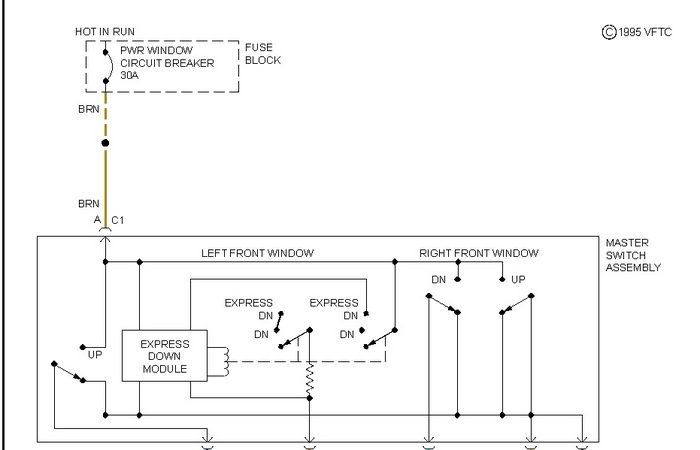

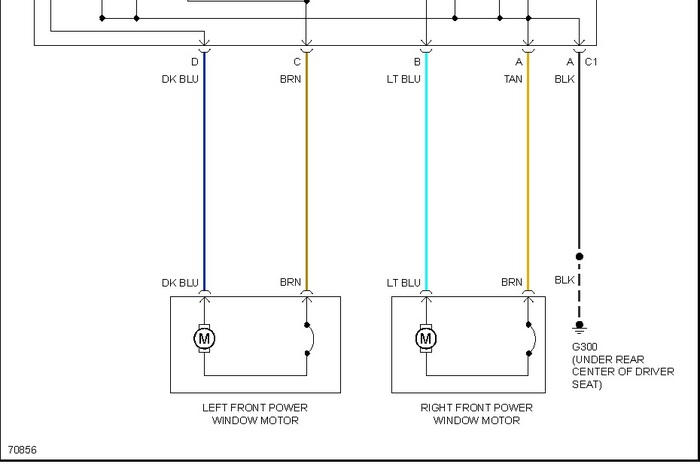

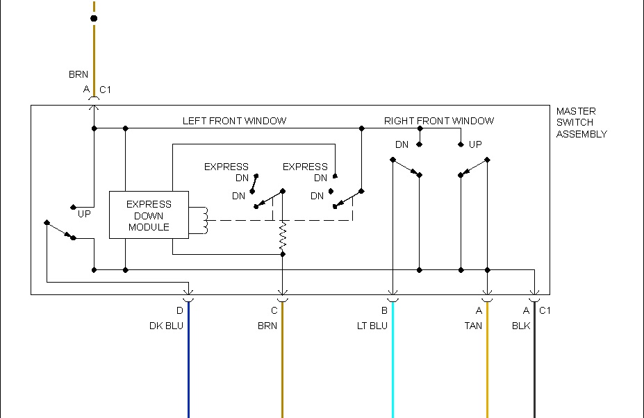

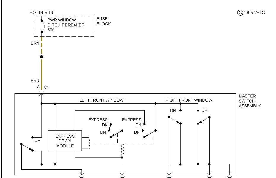

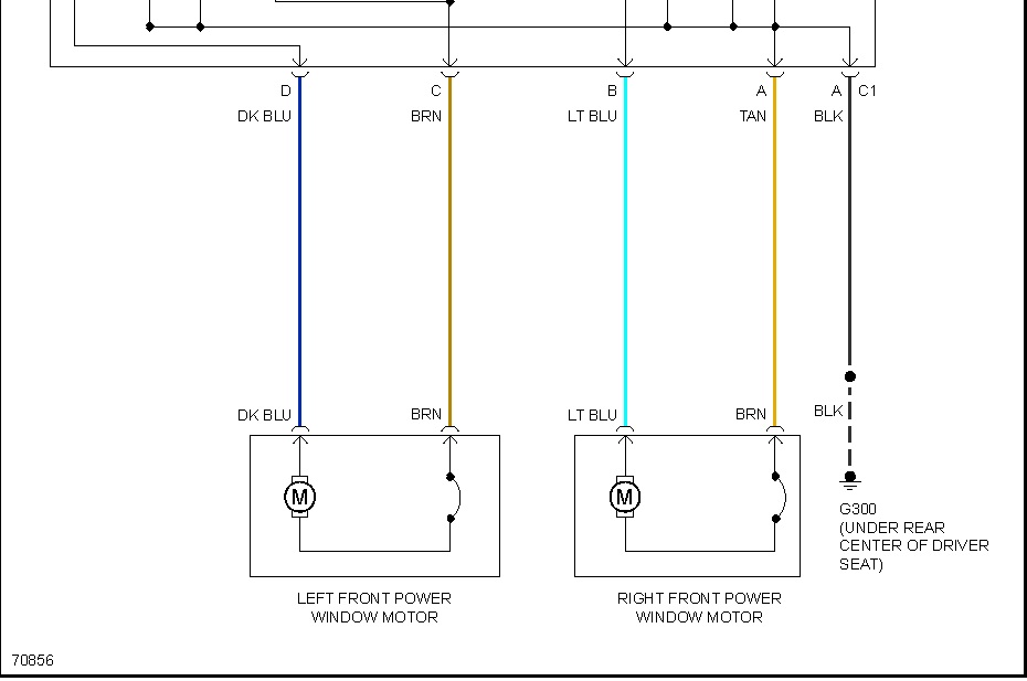

GAYLENE10
  • 1995 PONTIAC GRAND AM
  • 6 CYL
  • FWD
  • 176,000 MILES
Both the driver and passenger side power windows stopped working at the same time. If this is a fuse can you please tell me where it is located. I have looked in dash on drivers side and under hood. I find it odd that both windows stopped working at the same time.
Tuesday, July 14th, 2020 AT 12:41 PM (Merged)
JDL
  • 16,098 POSTS
Check the power window relay in the fuse box. Use a voltage tester and check for voltage where the relay plugs in, should go hot with the key on. I'll double check the wiring info.
JDL
  • 16,098 POSTS
For the two door, everything shows to be wired through the master switch. Wiring below.
