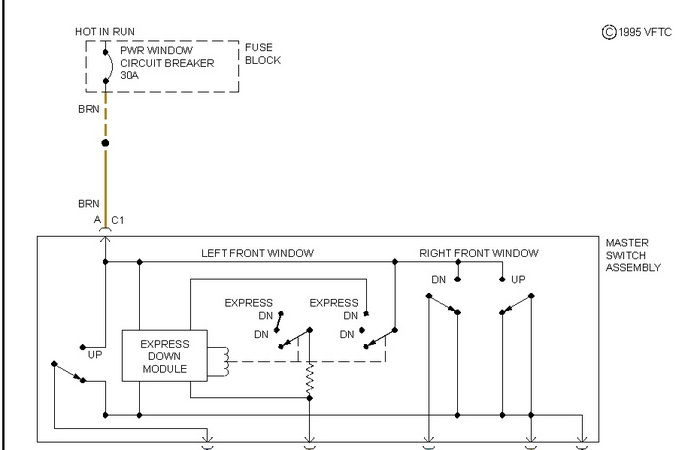

JDL
  • 16,098 POSTS
The info I looked at was for a two door. Yes, check the wiring harness, hinge side of door. Pull the rubber boot back to access wires. Brown wire, top, in diagram, is voltage to master switch, hot all the time, that key is on, voltage comes from power window circuit breaker. The black wire in diagram is ground. If you use a testlite between those two wires, key on, it should lite up. You have to penetrate the insulation. If good voltage and ground, have to check master switch.
Jul 14, 2020 at 5:41 AM (Merged)
GAYLENE10
both the driver and passenger side power windows stopped working at the same time. If this is a fuse can you please tell me where it is located. I have looked in dash on drivers side and under hood. I find it odd that both windows stopped working at the same time.
JDL
  • 16,098 POSTS
Check the power window relay in the fuse box. Use a voltage tester and check for voltage where the relay plugs in, should go hot with the key on. I'll double check the wiring info.
JDL
  • 16,098 POSTS

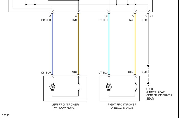

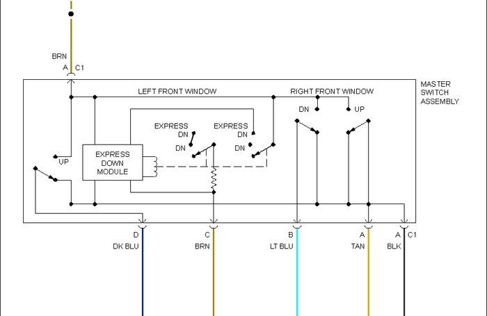

For the two door, everything shows to be wired through the master switch. Wiring below.
