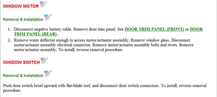

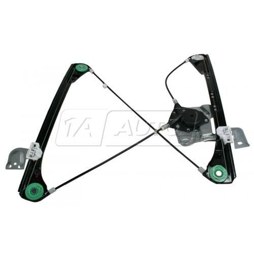

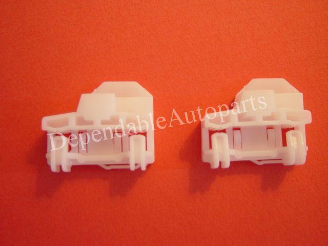

I have attached a couple of things for you. The clips shouldn’t be that bad to change. I have attached a pic of them and the regulator. Also, a video on how to change. I would first take apart to see what you need as you can drive with the door panel off. That way you are sure of the problem. Also, I would purchase a couple of door panel Christmas trees as most of the time they brake when you are taking the door panel off. http://www.youtube.com/watch?v=RFJS6qBaQx8
Jul 14, 2020 at 5:35 AM (Merged)

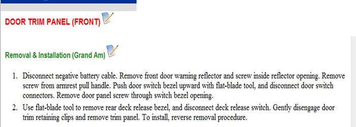

Here is two other things for you
