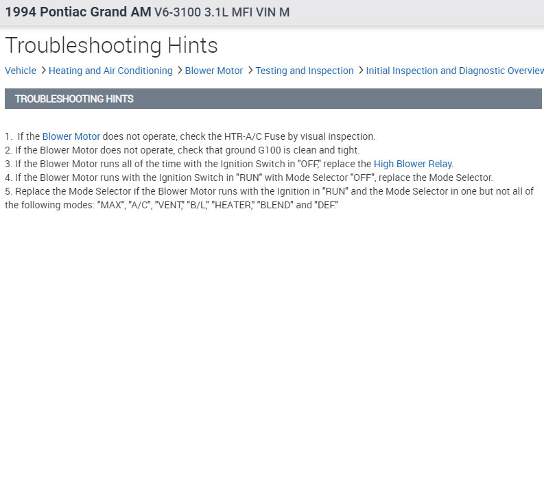

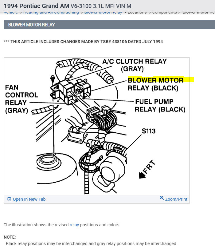

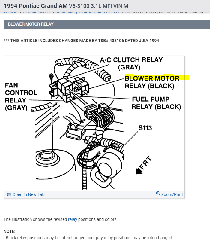

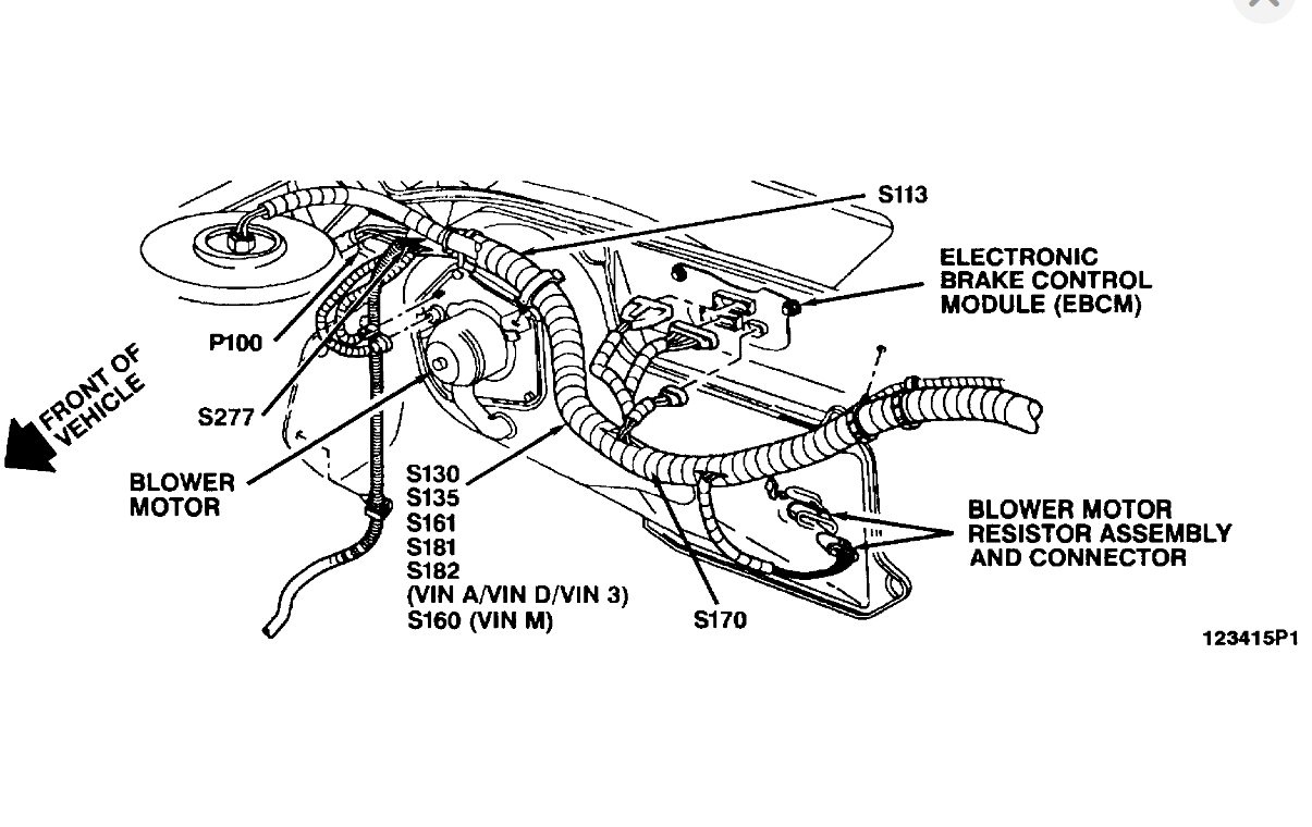

An inoperative blower fan can be due to a faulty switch, bad relay, malfunctioning blower motor resistor, bad motor or wiring issue.
First check the relay.
The blower motor relay is located under the hood (see diagram).
Check for any corrosion or burnt pin(s).
You can also test the relay.
If the relay is good, then make sure the blower motor is getting power. To see if the motor is good or bad you can test it by simply applying 12V power to it.

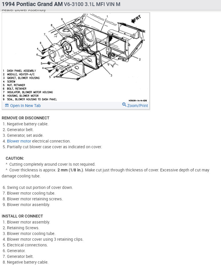

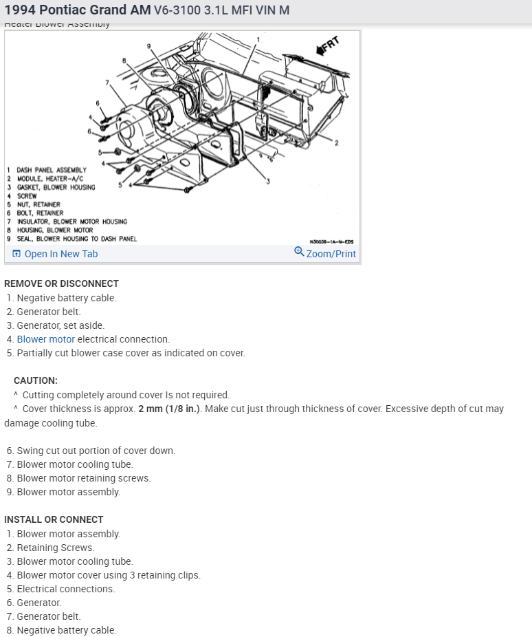

The fan for the heater works intermittenly in winter/ below freezing temps. Sometimes while I'm driving and hit a bump it will come back on after not working. Works fine in summer for A/C.
Also, where is the fan located? How do I go about getting to it? Do I need to take apart the dash?Thanks
Saturday, November 9th, 2024 AT 4:52 PM (Merged)
  • 109,867 POSTS
The fan is located under the dash on the passanger side. And yes, you need to take part of the dash apart to access it. As far as the problem, it could be a bad blower motor relay that is reacting to the temp change. To be sure, you will need to check the fan to see if it is getting power when it isn't working. Also, I would also suggest making a new ground strap from the motor to a ground on the body to make sure it has a good ground.

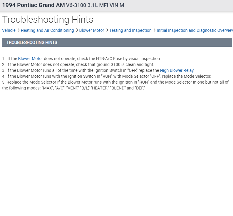

Hi I currently have a 1995 Pontiac Grand am se model with 3.1L automatic transmission and its got 101Miles on it
Recently the blower motor will cut off on its own, some days it will work and other days it wont work at all

BMRFIXIT
  • 19,053 POSTS
Check the wires on the resistor and the motor
if all ok motor no good
JTADDY
Hey Alan,
I had the same problem in my 1992 pontiac grand am. It turned out for me to be the blower motor itself maybe a short or whatever me and a buddy replaced mine and it works like a charm. I ve been there hope this helps. Josh
