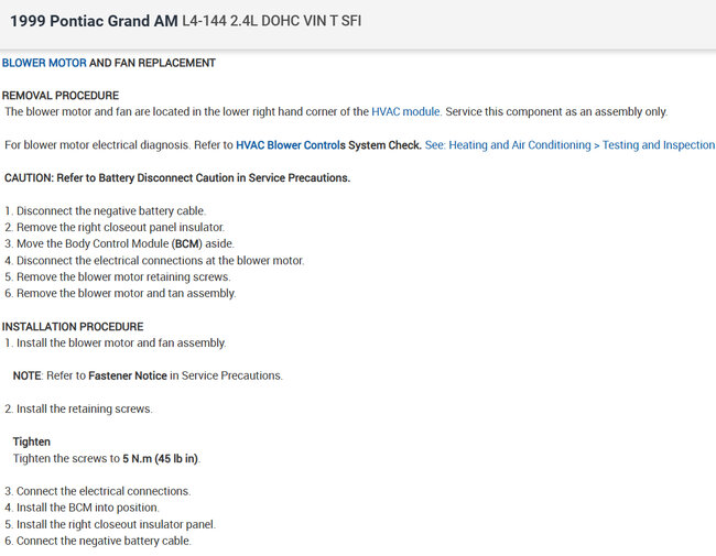

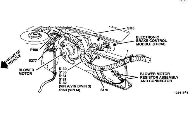

my blower motor in my 99 grand am has been acting up 1 night after i absentmindedly left it running for like 2 hrs, it'll blow when the car hasn't warmed up yet, or even when i take a hard left it'll kick on full power, otherwise it'll turn on for a second then off again. Also if i hit the underboards beneath the glovebox it'll start up weakly sometimes. I'm not too saavy w/ the troubleshooting aspect of vehicles so was wandering if maybe it could be some relay, bad ground, loose connection. any advice would be much appreciated, I live in northern mn and it's been below zero the past 2 days and this weekend might get down to -40 or so w/ the windchill, I need my heat! Thanx for your time

most likely you need a new blower motor
it sounds to me as if the brushes in the motor

you are on the right track it sounds like its the blower motor
its on passenger side
ez to do

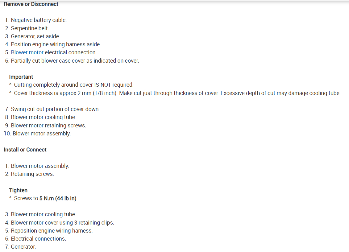

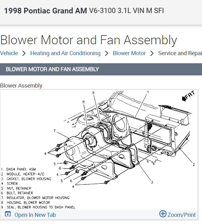

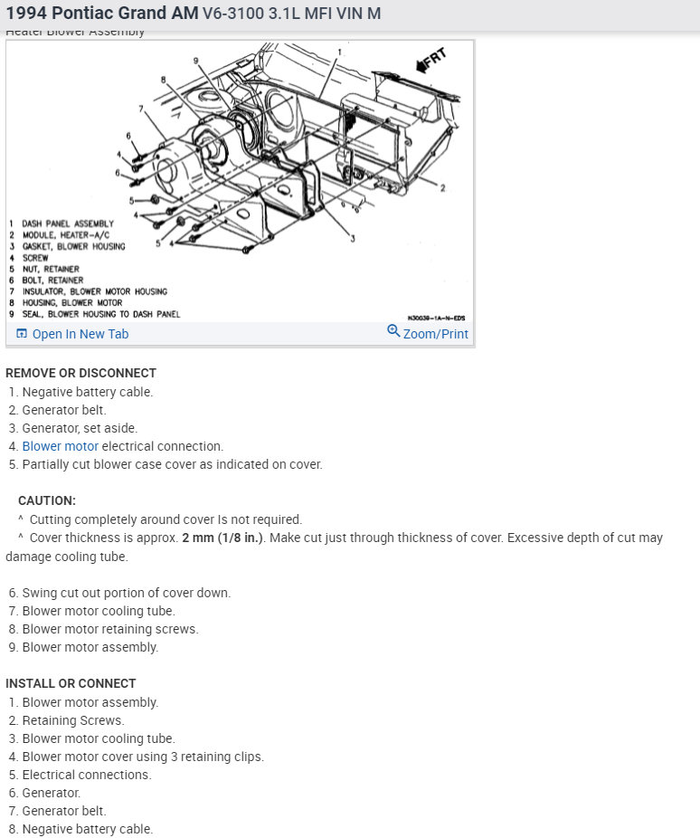

  • 54,861 POSTS

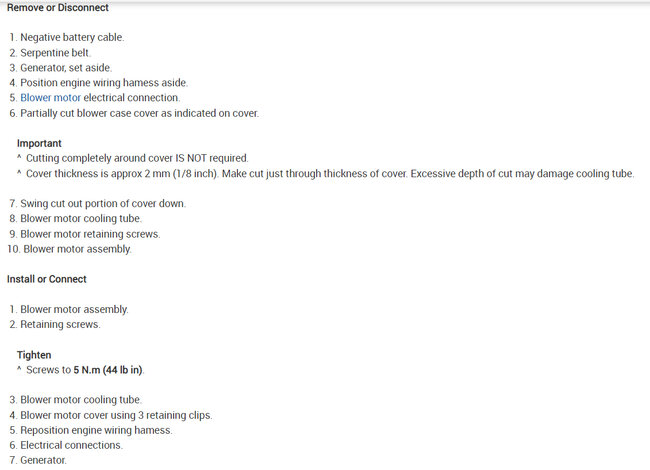

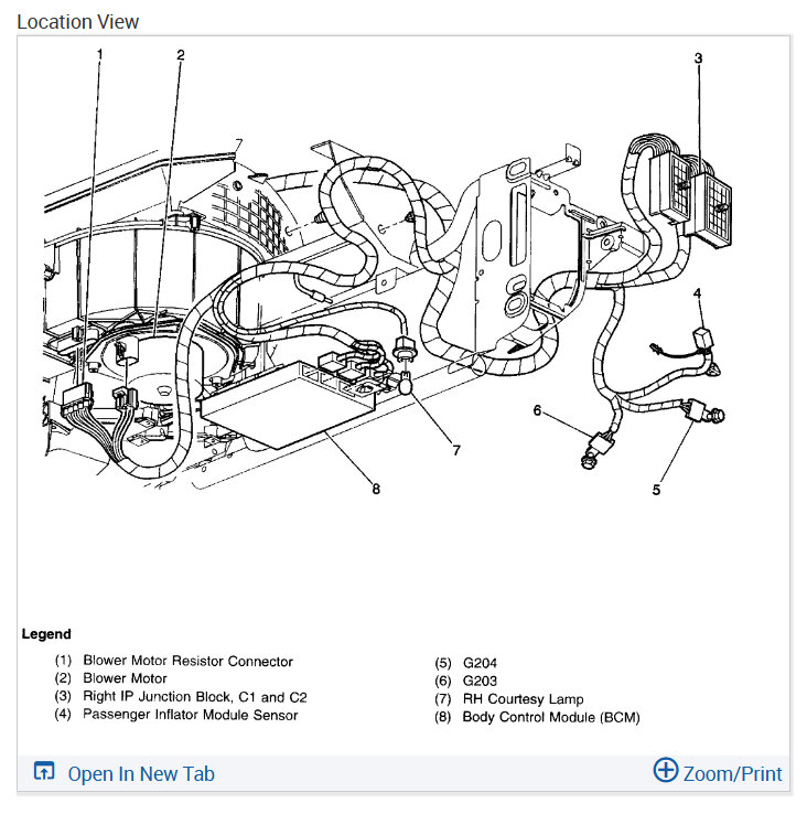

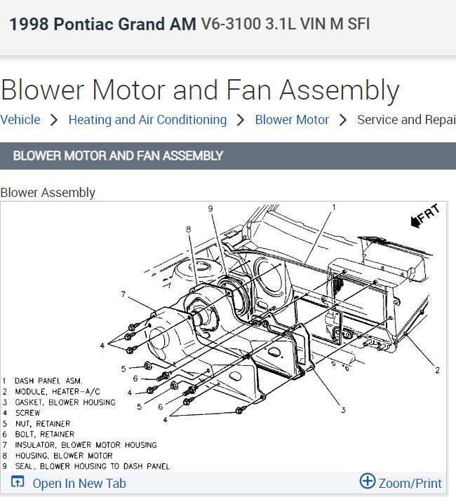

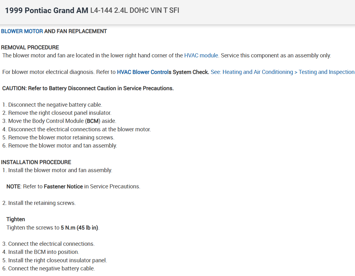

I agree with BMRFIXIT, here is the blower motor location and how to replace it. Check out the images (below). Let us know if you need anything else.

  • 54,861 POSTS
Yes, if the blower motor is not working the heater will not work as well. Here is how to test he blower motor power and ground to make sure the motor is the problem.
https://www.2carpros.com/articles/how-to-test-an-automotive-hvac-system-blower-fan-motor-a-detailed

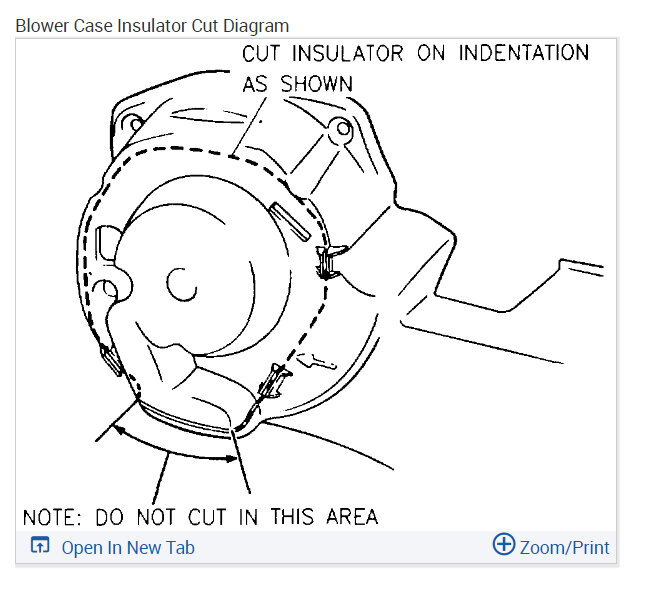

Here is the location of the blower motor and how to change it out. Check out the images (below). Let us know how it goes. You will need to cut the insulation to get at the blower motor.

Have you checked heater fuses? I don't know an easy way to get at the connector. You may have to access the blower motor and follow the wires.
The autozone site has info on getting at the blower motor. Click on( vehicle repair guides) follow the links for y--m--m, then type blower motor in their( parts search box), that page will have a link at the bottom for getting at the blower motor.

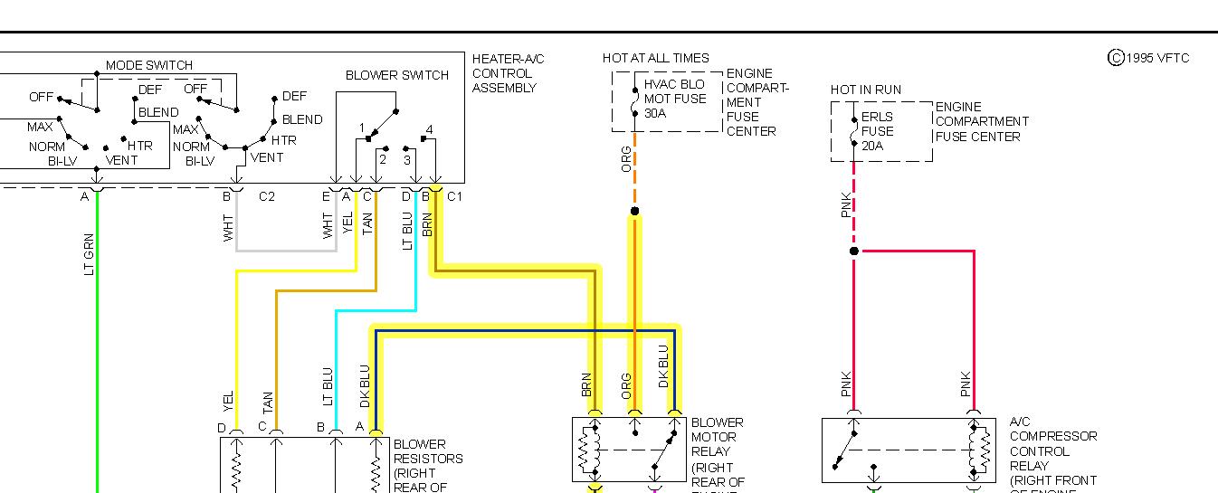

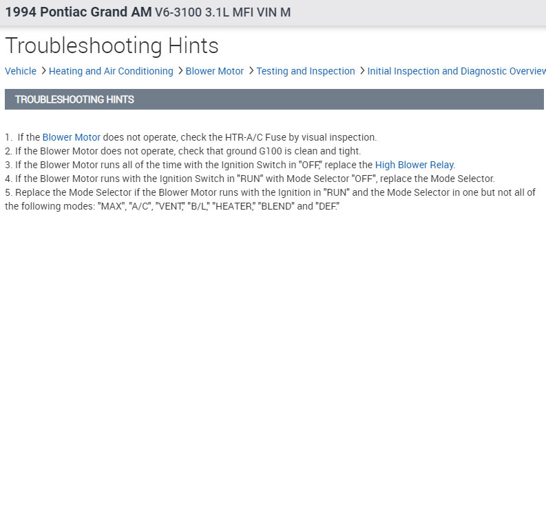

  • 75,992 POSTS
BLOWER MOTOR WILL NOT RUN
Check fuses. Turn ignition switch to RUN position. Check for voltage at function control switch. Switch blower switch to HI position. Check for voltage at switch and at high-speed blower relay. Ground blower motor with ignition switch in RUN position. If blower operates, motor is okay.
Check the blower motor fuse 30amp in engine compartment fuse center and blower relay in right rear in engine compartment-
Do this -you can power the blower motor purple wire and see if it works direct from the battery postitive post-

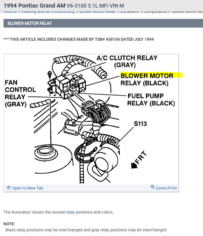

  • 75,992 POSTS
At fuse block check the Heater/AC fuse 25amp. This problem could be the Heater/AC control assembly,blower motor resistor/blower motor relay located it in the right rear of engine compartment. See below
https://images.2carpros.com/forum/automotive_pictures/12900_blower_2.jpg

SQM
  • 6,383 POSTS
An inoperative blower fan can be due to a faulty switch, bad relay, malfunctioning blower motor resistor, bad motor or wiring issue.
First check the relay.
The blower motor relay is located under the hood (see diagram).
Check for any corrosion or burnt pin(s).
You can also test the relay.
If the relay is good, then make sure the blower motor is getting power. To see if the motor is good or bad you can test it by simply applying 12V power to it.
https://www.2carpros.com/articles/blower-fan-motor-works-on-high-speed-only
Let me know what you find or if you have any questions.
