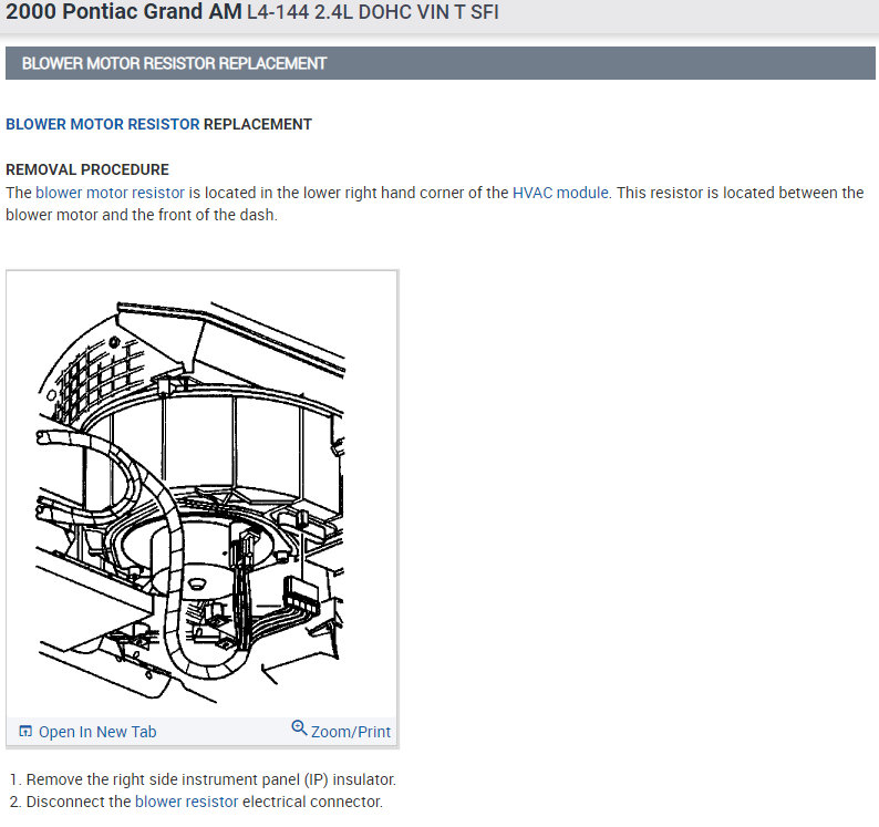

How do I replace the blower fan resistor in this vehicle?
Aug 25, 2009 at 4:51 PM
  • 110,194 POSTS
1.Disconnect the negative battery cable. 2.Remove the right closeout/panel insulator. 3.Move the Body Control Module (BCM) aside. 4.Disconnect the electrical connections at the blower motor. 5.Remove the blower motor retaining screws. 6.Remove the blower motor and fan assembly. Fig. Blower motor mounting

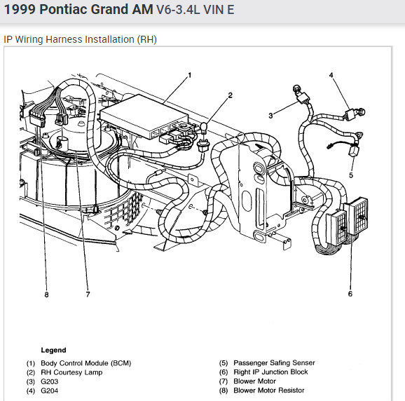

A 2001 grand am where are the blower resistor located
Nov 9, 2024 at 4:49 PM (Merged)

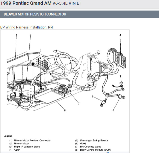

BLUELIGHTNIN6
  • 16,542 POSTS
blower motor resistor is below the right side of dash, pic below

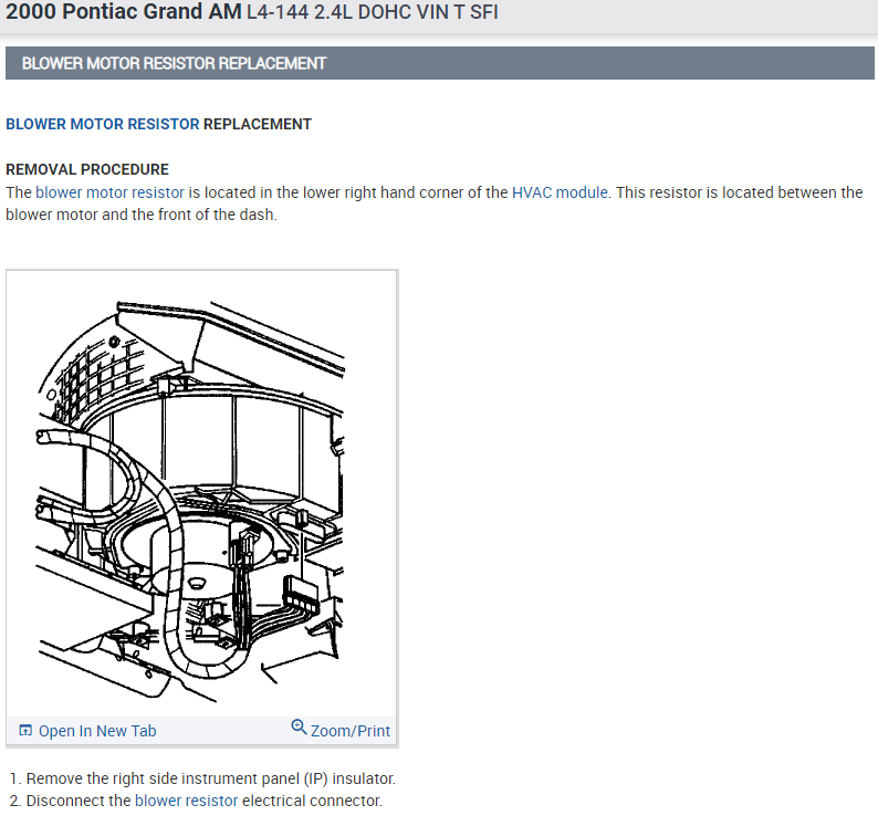

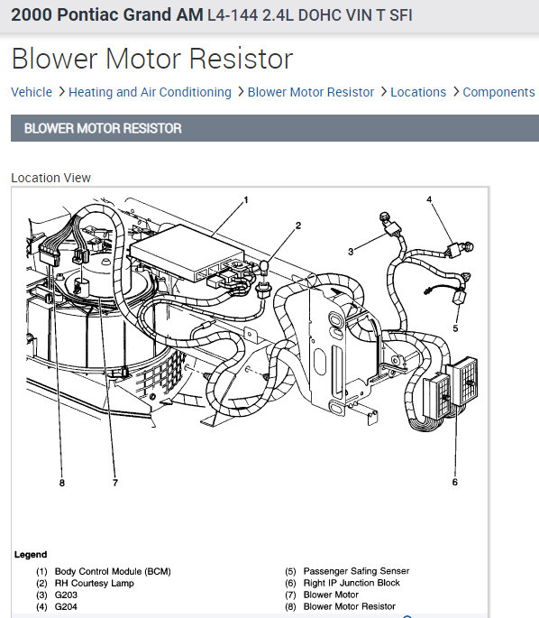

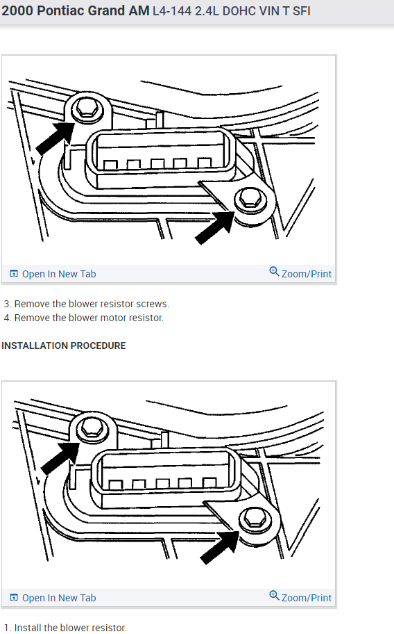

MOONTFA2504
I need help finding the location of the Heater Blower Motor Resistor on a 2000 Pontiac Grand-AM GT. The heater fan only works on the highest setting. I pulled out the glove box, heater control panel, & radio and tried following the wire harness back from the control panel. However the harness splits off with one section going under the rug by the center consol, & the other disappearing back by the firewall. Since I had everything out, I looked under the dash on the passenger side, but I didn't see anywhere where the resistor would fit/go into. I had the same luck under the hood. Maybe I just didn't see where it belonged. I ran out of time so I didn't get a chance to look under the dash on the driverside. The resistor I got from my auto-parts store is made by Standard (part# RU43). The resistor is a Printed Circut Board Card that is mated to a 5 pin male plug with two attaching ears (for screws/bolts). It's obvious the resistor slides into a port of some sort. I noticed that the resistor has an attached foam gasket which is leading me to think it most likely belongs under the hood somewhere.
Thanks in advance for any info you can give me in replacing the resistor, and I hope you folks have a great holiday season. I did send in a donation for the help & again thanks.
Dave

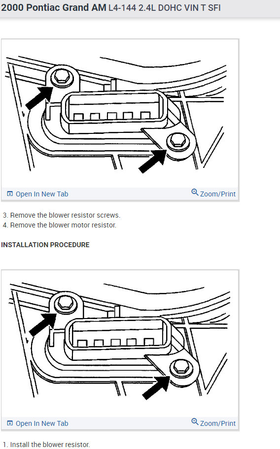

SQM
  • 6,383 POSTS
Over time the blower motor resistor will get burnt on the different speed setting and can only work in one speed.
The blower motor resistor is located under the dash on the passenger side. It is mounted tot he blower motor.
To take off the sensor simply disconnect the wiring and remove 2 screws that holds it in place.
I have attached the diagrams for your reference.

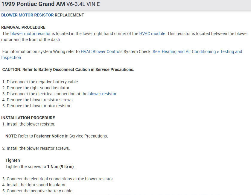

BOB2224
Heater problem
1999 Pontiac Grand Am 6 cyl Two Wheel Drive Automatic
How do I change the blower motor resistor and where is it located at?
BLUELIGHTNIN6
  • 16,542 POSTS
Blower motor resistor is located on the blower motor case itself. Blower motor is located under dash, remove right lower interior panel for access.
REMOVAL/INSTALLATION:
Disconnect negative battery cable.
Disconnect resistor wiring harness.
Remove resistor mounting screws, then resistor.
Reverse removal procedure for installation.

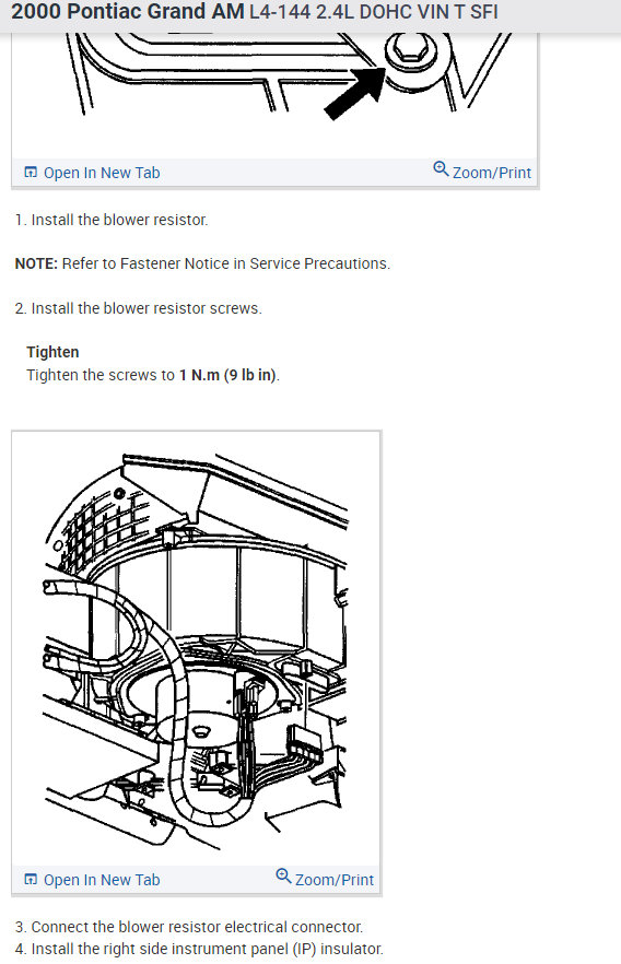

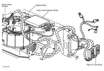

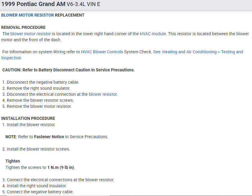

MIKE1971
My heater control inside the vehicle only works on the 4 & 5 setting. I get no air at all on settings 1,2 & 3.
Nov 9, 2024 at 4:50 PM (Merged)
SQM
  • 6,383 POSTS
It does sounds like a faulty blower motor resistor. Which is a very common issues with these cars. The resistor is mounted on the side of the blower motor. See below for the replacement procedure of the resistor.
You might find this article helpful:
https://www.2carpros.com/articles/blower-fan-motor-works-on-high-speed-only
Let me know of any questions.

JGARRETT566
I have a 1999 Pontiac Grand Am, 98000 miles.
I am wondering where the blower motor resistor is on this vehicle because I have to replace it
Thank you,
MERLIN2021
  • 17,250 POSTS
Remove the right lower interior panel in front passenger side, it's screwed to the side of the blower motor...

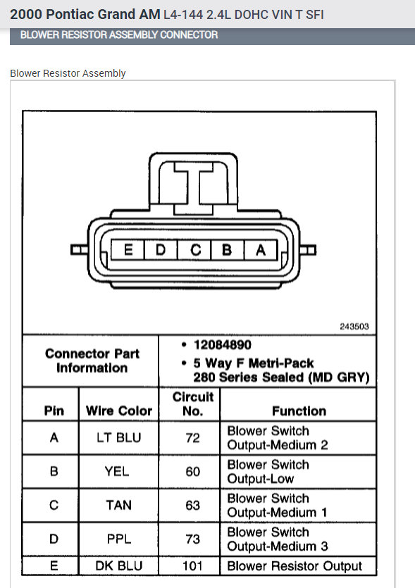

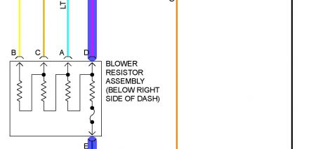

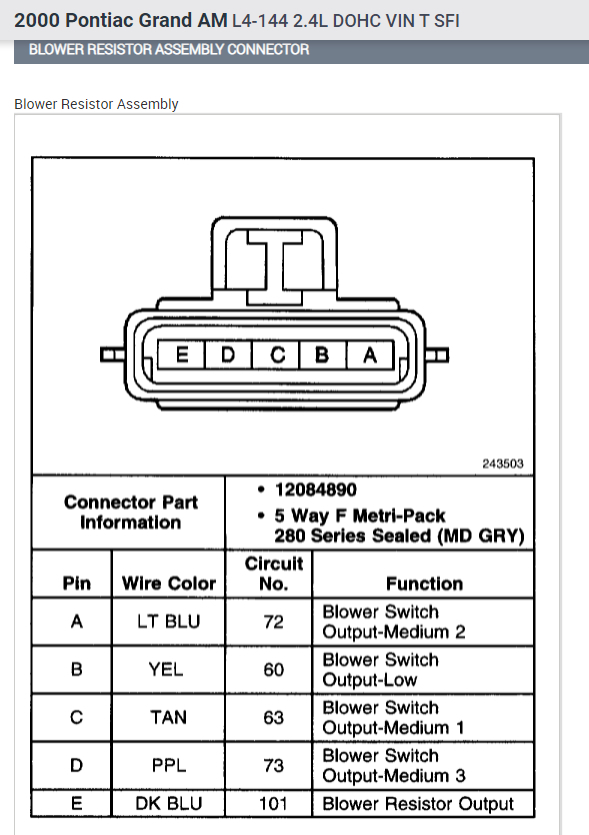

FAIRRACING31
  • 150 POSTS
The blower resistor should be mounted next to the blower motor. The resistor connector and blower connector should be in the same wire lume. I believe the blower resistor has 5 wires to it. DK BLU,PPL, LT BLU,TAN,YEL
