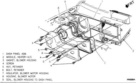

ROBERT HAYES
  • 1996 PONTIAC GRAND AM
Heater problem
1996 Pontiac Grand Am 6 cyl Front Wheel Drive Automatic
HOW DO YOU CHANGE BLOWER MOTOR AND FAN

  • 75,992 POSTS
1996 Pontiac Grand AM V6-3100 3.1L VIN M SFI
With Air Conditioning
Blower Case Insulator "Cut" Diagram
https://www.2carpros.com/forum/automotive_pictures/12900_bmotorp_1.gif
REMOVE OR DISCONNECT
1.Negative battery cable.
2.Generator belt.
3.Generator, set aside.
4.Position engine wiring harness aside.
5.Blower motor electrical connection.
6.Partially cut blower case cover as indicated on cover.
CAUTION:
*Cutting completely around cover is not required.
*Cover thickness is approx. 2 mm (1/8 in.) . Make cut just through thickness of cover. Excessive depth of cut may damage cooling tube.
7.Swing cut out portion of cover down.
8.Blower motor cooling tube.
9.Blower motor retaining screws.
10.Blower motor assembly.
INSTALL OR CONNECT
1.Blower motor assembly.
2.Retaining Screws.
3.Blower motor cooling tube.
4.Blower motor cover using 3 retaining clips.
5.Reposition engine wiring harness.
6.Electrical connections.
7.Generator.
8.Generator belt.
9.Negative battery cable.
