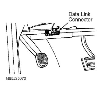

Where will I find the codes displayed on the car or do I have to have a machine to check the codes
Wednesday, January 20th, 2010 AT 7:14 PM
BMRFIXIT
  • 19,053 POSTS
Connect scan tool to Data Link Connector (DLC).
DLC is located below driver's side of instrument panel
https://www.2carpros.com/forum/automotive_pictures/99387_Graphic1_639.jpg

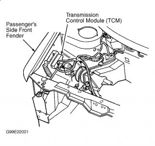

I put a new asd in the fuse bos. The car started this morning and I decided to take it to work. After about 5 minutes the all the guages quit working and the abs, check engine light and alarm set light went on. I took it Advanced auto and they hooked up the machine and cod p1698 came up. I hope this helps
Monday, February 8th, 2010 AT 12:20 PM
BMRFIXIT
  • 19,053 POSTS
DTC P1698 no CCD messages from the TCM
Inspect wiring and connectors between PCM and TCM
https://www.2carpros.com/forum/automotive_pictures/99387_Graphic_53.jpg
