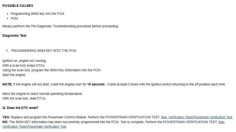

I checked again today the only code is p0633 key is not programmed it always been there since I replaced the pcm. No p0700 or p0882

Attached below is AllData's information on P0633. Basically, it says to get the key programmed. If that doesn't do it, then replace the PCM. Since you've already replaced it, I'd try getting it reprogrammed first.

So do you think the cause of p0882 is because the key is not programmed in the pcm.?

633 is the only code right now. I wouldn't worry about one that you don't have currently. Fix the issue causing the 633 code, and it might take care of the other intermittent stuff. Basically, address the problem that you know you have.
