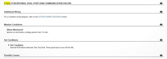

what is the voltage drop allowed for PCM powers and grounds? my PCM loses power. sometime it is intermittent and get two codes p1603 and p0882.
Sep 2, 2017 at 6:51 AM
HARRY P
  • 2,292 POSTS

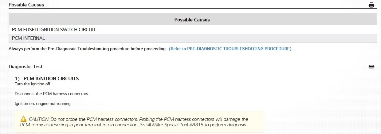

Unfortunately, it appears that Chrysler has not supplied that information. At least not anywhere that I can find it. From my research, the P1603 code is the one to address. It points to an internal fault in the PCM. That fault is also probably the cause of the p0882 code (from the TCM). I am including what information that has been provided in the images below. Hope it helps.

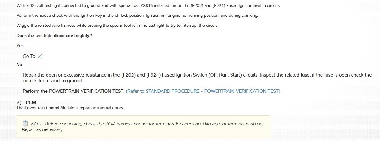

Hmmm Honestly the best that I can tell you is that you need to start from the beginning again. I would do the test suggested in the images to see if the PCM is bad and then go from there. I'm betting on a problem with it.

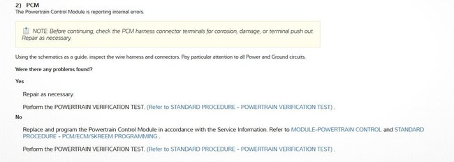

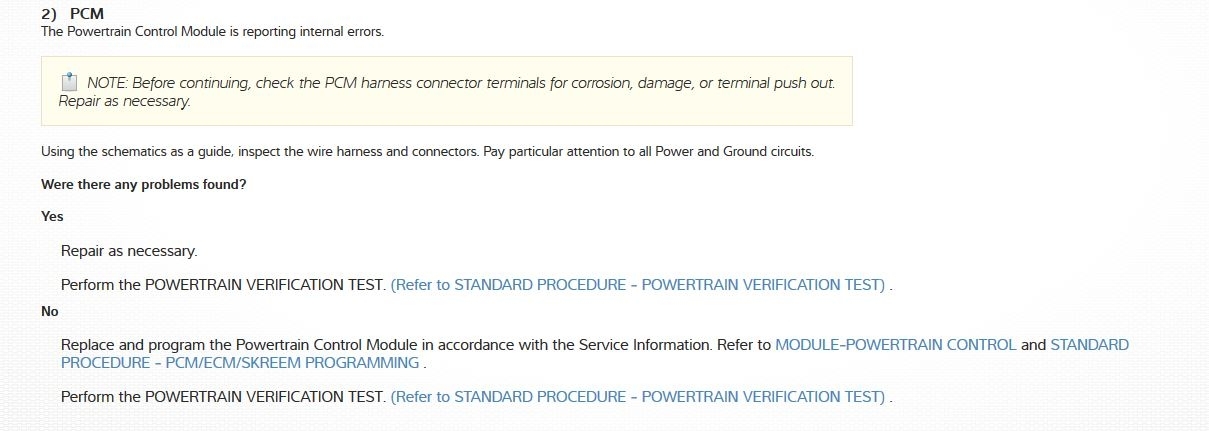

I did those tests and the computer has powers and grounds.
the instruction after says check for bad connections how to do that?
i remember i have seen a video a guy used a tool like needles has different thickness and insert them in the computer females pins and check for dhow much a pin drags and compare it to the other pins. can you tell me what they call that tool please?

That tool is a PCM pinout tool, and it costs about $300. Here is a link to one: https://www.handsontools.com/Miller-Mopar-Tools-8815-1-PCM-Pinout-Box-Adapter-_p_35916.html. Short of buying that, the best thing that you can do is to follow the wiring yourself and closely inspect it. In particular, look at the power and ground circuits. You can also use a multi-meter to check resistances along those same circuits. Excessive resistance means that there is an open circuit. Repair it and your problem should be solved. If you cannot find any problem with resistance in the wiring, then your issue is in the PCM itself.

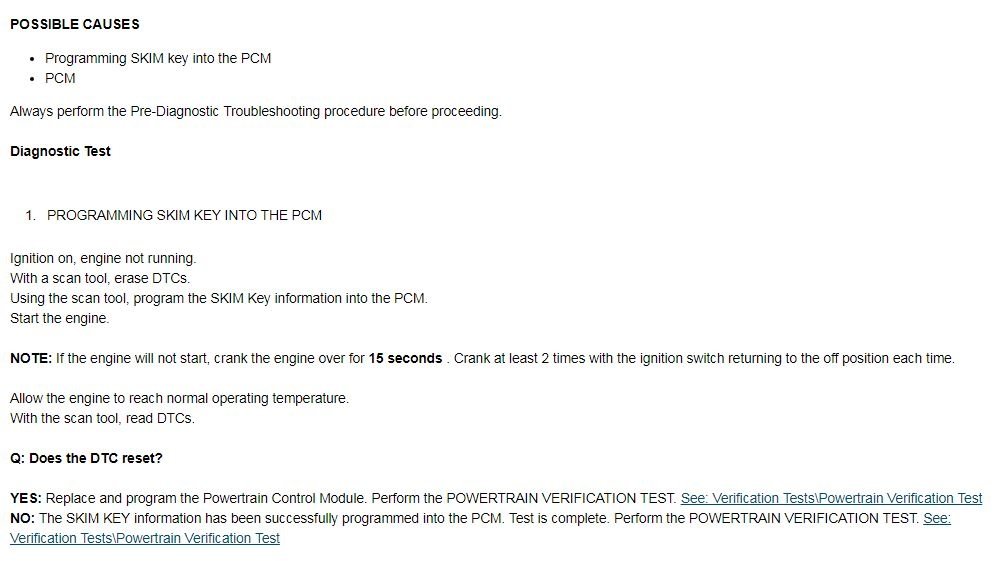

I checked again today the only code is p0633 key is not programmed it always been there since i replaced the pcm. no p0700 or p0882
Nov 21, 2017 at 5:10 AM
HARRY P
  • 2,292 POSTS
Attached below is AllData's information on P0633. Basically, it says to get the key programmed. If that doesn't do it, then replace the PCM. Since you've already replaced it, I'd try getting it reprogrammed first.

633 is the only code right now. I wouldn't worry about one that you don't have currently. Fix the issue causing the 633 code, and it might take care of the other intermittent stuff. Basically, address the problem that you know you have.
