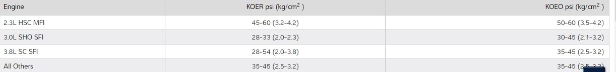

When driving at seventy mph hour the engine will drop down to forty five mph on its own
TAZMCCALL
  • 1994 FORD CROWN VICTORIA
  • V8
  • 2WD
  • 80,000 MILES
While driving on the highway going about seventy miles per hour my car kicks me down to only being able to go forty five mph while pressing on the accelerator it acts like it does not want to go. I have to pull off to the side turn the car off rev it up a little bit and then it will let me go a little bit, but what if I go seventy miles per hour it kicks me back down again. However, if I am at least sixty mph it does not do it. Well now it is starting to do it when I start my car up and try to go it takes a long time to get to thirty five mph.

Based on your description, it could be many things. If the check engine light has come on, I recommend having the computer scanned to determine what codes are stored. Here is a video showing how to use a scanner:
https://youtu.be/YV3TRZwer8k
If you do not have access to a scanner, most parts stores will check them for free.
If no trouble codes are found, I would then recommend checking the fuel pump pressure. Low fuel pressure can cause the engine to lose power and slow down, especially on hills and higher speeds. Here is a link which discusses checking fuel pump pressure as well as the pressure regulator. You will need a gauge, but most parts stores will lend you one.
If you determine the pump is an issue, here are general directions for replacement:
https://www.2carpros.com/articles/how-to-replace-an-electric-fuel-pump
I have attached a picture listing the fuel pressures for 1994 vehicles. Yours is the last one (others).
