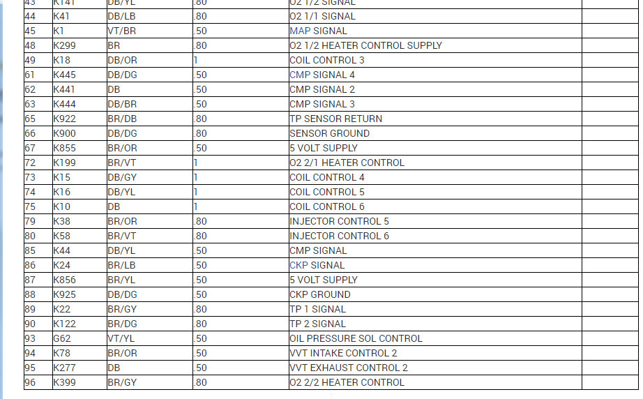

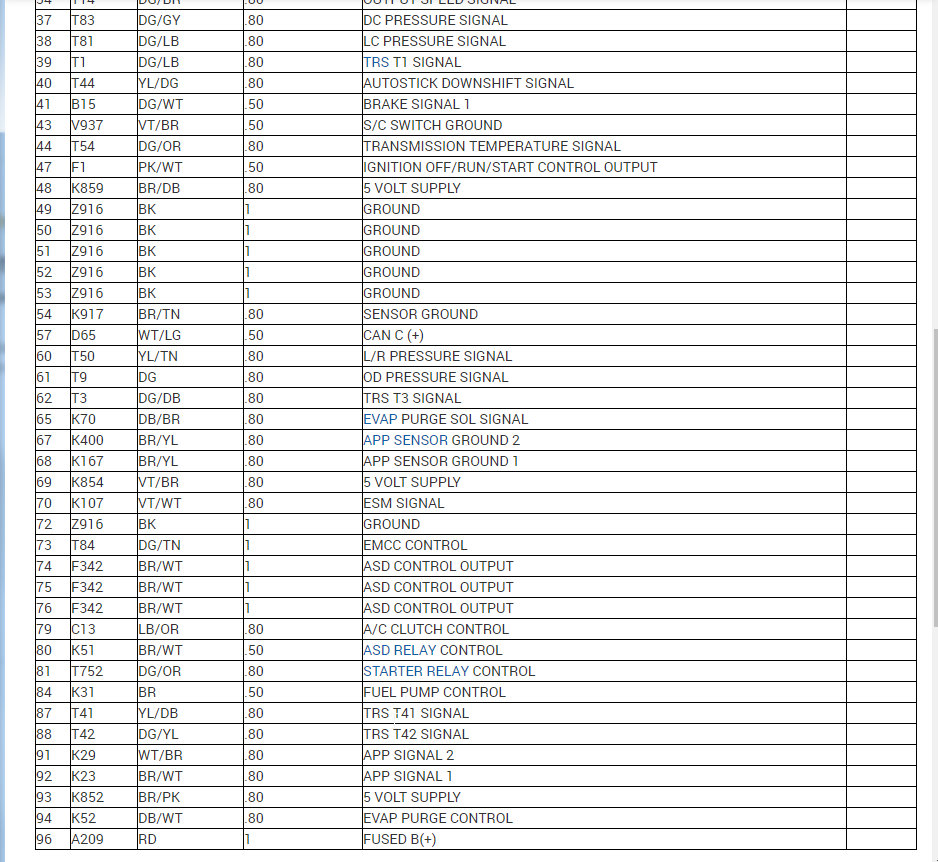

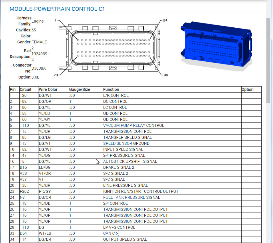

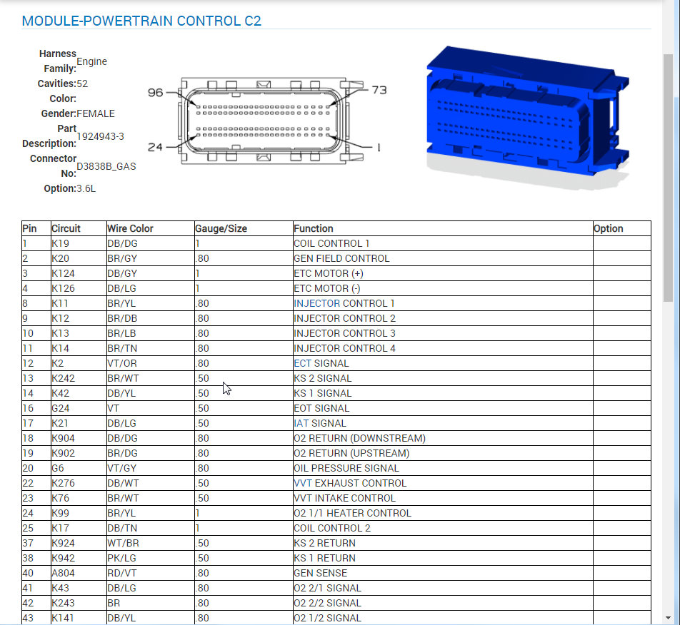

I just need a PCM pinout for my exact vehicle. Thanks
Nov 14, 2020 at 2:55 AM
Attached are the pinouts for C1 and 2 of the PCM. Let us know if you have more questions. Thanks
Nov 14, 2020 at 3:07 AM

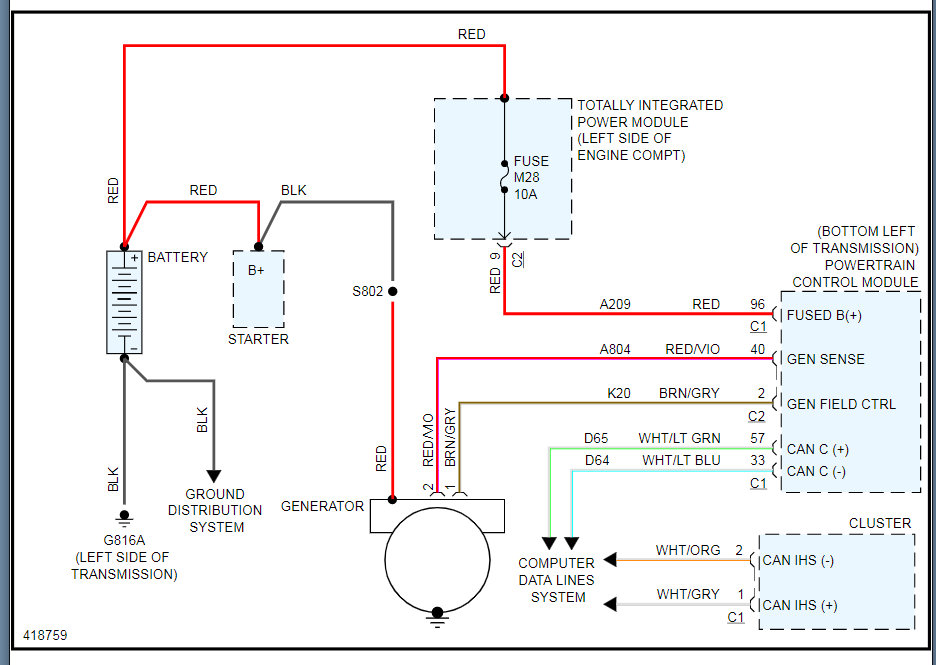

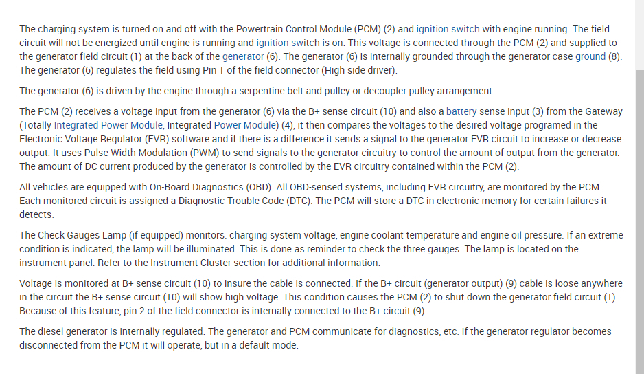

Thank you! That helps a lot. I'm trying to fix the alternator control circuit to provide battery charging, but I can't seem to find the correct circuit diagrams.
Nov 14, 2020 at 3:49 AM

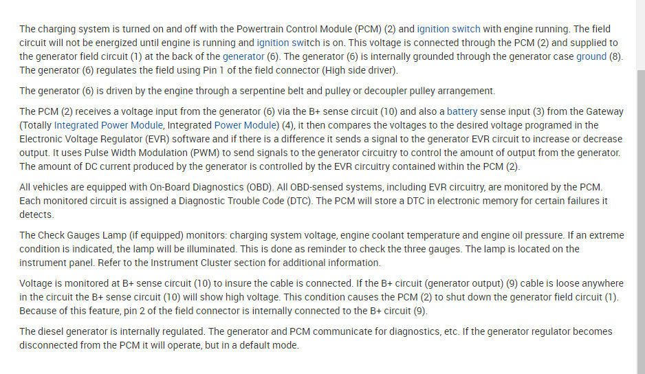

You are welcome. I think there was another post on this last night as this sounds familiar. If this is the same, let us know how you make out on just one of these posts but if not, here is the diagram. More then likely you have an issue on the field control circuit. That is not uncommon on these vehicles. This circuit is a pulse width signal and when there is resistance on it, the alternator doesn't operate properly. Take a look at the attachments for more detail.

Thanks for your help! The history is: 1) The battery drained out and read 10.5Vdc so I replaced it. 2) The battery read 12.7Vdc running and off, so I removed the alternator and it bench tested good at O'Reillys auto parts. I reinstalled it and still no charging. 3) I checked the wiring from the alternator to the PCM and didn't find anything wrong (alternator pins 1 and 2 checked good (0.2 Ohms) to PCM brown plug pins 2 and 40, and to no other pins). With the PCM plugs removed and the alternator and battery reconnected (read 12.4Vdc), the white plug (now with your info I know that's C1) had solid grounds on pins 49, 50, 51, 52, 53, and 72, and 12.4Vdc on pins 80 and 96. The brown plug (C2) had 12.4Vdc on pin 40, and pin 2 still reads continuity to pin 2 on the alternator (no voltage). So I ordered a PCM. I'll continue in the next reply.

Okay, I see it is a problem for the sense line (Alt pin 2) to drop to 9.4Vdc when the engine is running. Your circuit operation description says the Alt output terminal is internally connected to the pin 2 sense output to the PCM. There must be resistance in the alternator output terminal to the battery positive terminal, dropping the 3Vdc
(or the Alt conn socket to the Alt pin 2, but it looked solid).
I should be able to get back on it today.
Thanks so much for the diagram, circuit operation description and PCM pinout. Huge help!
Nov 17, 2020 at 1:58 AM
Sorry for the delay but I think you found it. You appear to be exactly correct. When you see resistance climb past 10k ohms that is the first sign of high resistance. Then to have a voltage drop of 3 volts is just more confirmation. Thanks for the updates and good work.

I found a Remy tech service bulletin on Chrysler charging systems that has more info on these alternators, (at autoprollc.com website menu under Service Resources under Technical Bulletins). It turns out the sense output (alternator pin 2) is a Kelvin sense circuit that should have no current on it, but it does have a 2.4k Ohms resistor in the alternator to protect it from shorts to ground. That's where the 2.333k Ohms came from, and the voltage drop on alternator pin2 when the engine is started.
I'm not convinced the new PCM is good, but apparently there is a 5V turn on voltage to the EVR circuit when the PCM determines it should be turned on.
I haven't found the inputs the PCM requires to determine that the ignition is on and the engine is running. I haven't heard of any other requirements. Thanks for your help.

Did you use a scan tool to monitor the system? You can turn the alternator on and off through the scan tool.
Voltage checks on the lines are not accurate as there is pulse width modulated signals sent from the PCM.

That is controlled by a load detector inside the ECM.
That is why you need a scan tool to monitor what the ECM is commanding.
