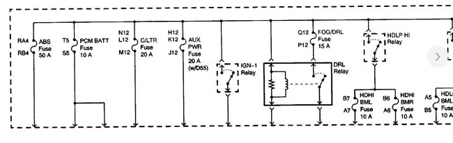

Mini fuse # 8 PCM battery (10A).

That is battery control to the PCM. No other circuits that I see.
It is either a wire harness issue or the PCM itself. Unplug the PCM and see if it still blows.

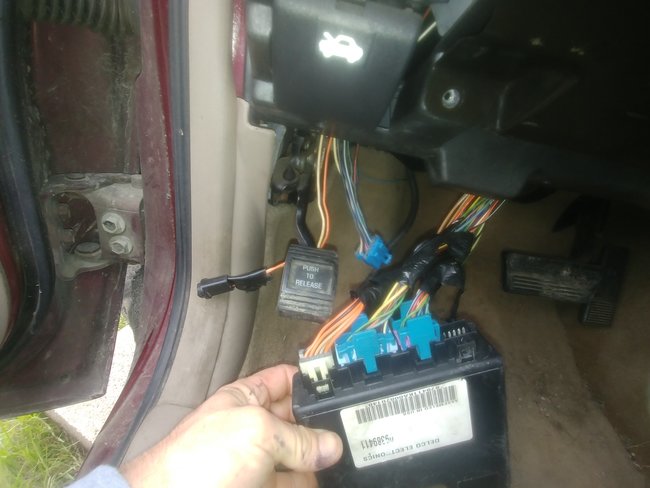

I'm having a similar issue only I keep blowing the PCM, BCM, U/H relay fuse every time i try to start it. But if i unplug one of the connections on my BCM box under the steering column it won't blow but I lose headlights and a few other things.
Apr 2, 2020 at 4:15 AM
Good afternoon.
From what you described, the BCM has an internal short and needs to be replaced.
You need a new one, not a used one as it needs to be programmed to your VIN number to be sure all your options function.
If you give me your VIN number I can get the procedure and location for you.
Apr 2, 2020 at 4:19 AM

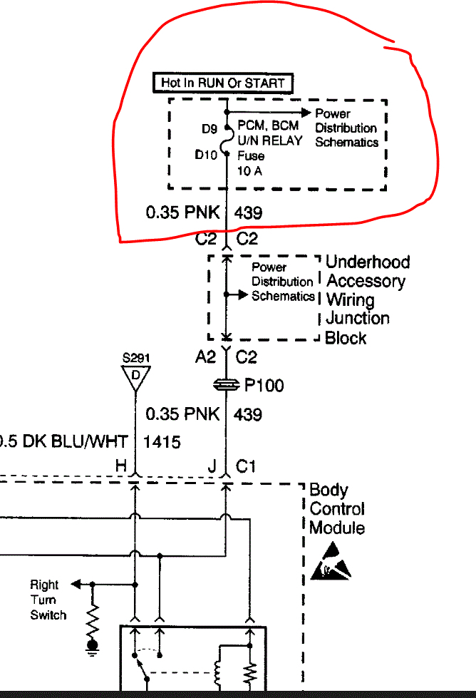

Have you checked the plug itself to see if there are any pins touching that would cause a short? Also, take a look at the attached pic and let me know if I have the correct fuse that is blowing.
If I do and there is no damage to the pins in the connector, I want you to unbolt the BCM so it has no ground. If it still blows the fuse, the problem is in the wiring to it. If it doesn't, then chances are the BCM has an internal short.

Yes, that is the right fuse. So your saying look at the plug itself to see if there are any pins touching?

JYEARY91
  • 26 POSTS

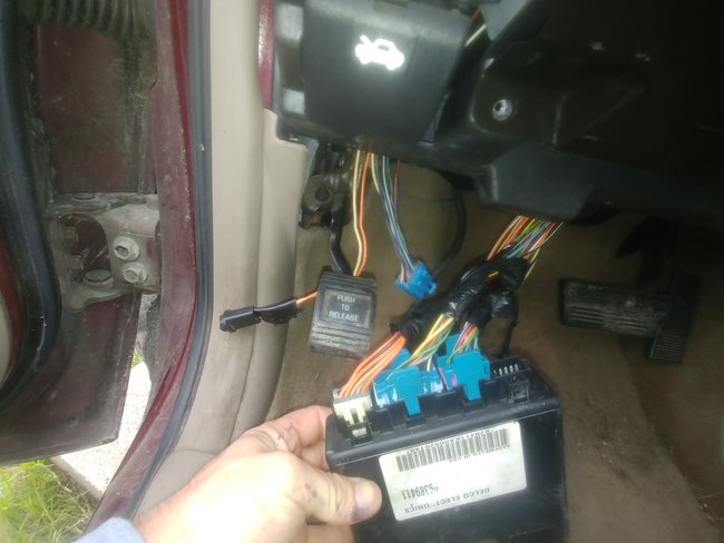

I'm not sure what you mean by unbolt the BCM because what I think is the BCM is just hanging down right now. I'll take a picture.
Apr 2, 2020 at 9:05 AM (Merged)
JYEARY91
  • 26 POSTS
This is what I unplugged to be able to start it:
  • 110,240 POSTS
Yes, the plug itself has pins in it that can bend or become damaged and short. As far as the BCM, I don't think it should be hanging.

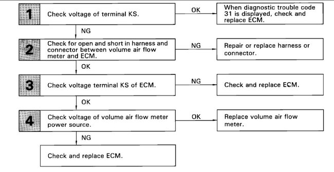

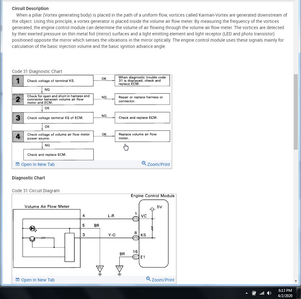

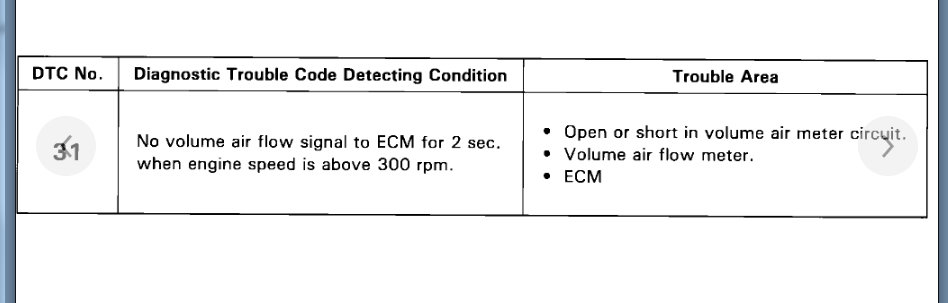

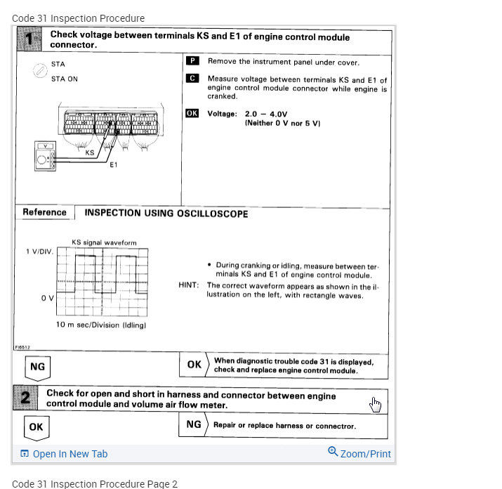

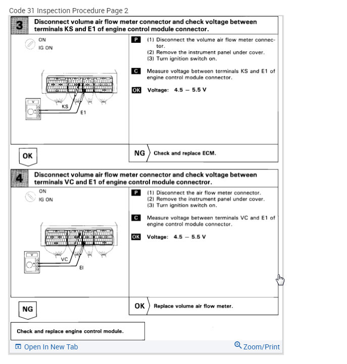

JJHRHIH
  • 15 POSTS
Previous question was would not go over 65, cleaned it and now sputters out when you step on gas. Code 31 .
When you unplug it it does not shut off. Should it?
New one does same thing . Do I have a ECM problem.
Can you supply me with voltages at connector?
Apr 2, 2020 at 9:11 AM (Merged)
Good evening,
Did it have a code prior to you cleaning the mass air flow sensor?
First, you cannot clean that sensor, The part that gets carboned up has carbon baked on the end. There is no cleaner to remove baked on carbon.
https://www.2carpros.com/articles/engine-stalls
I would suspect either fuel pressure or a cat converter issue. It may be clogged not allowing it to go any faster than 65.

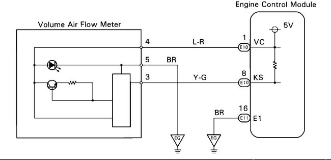

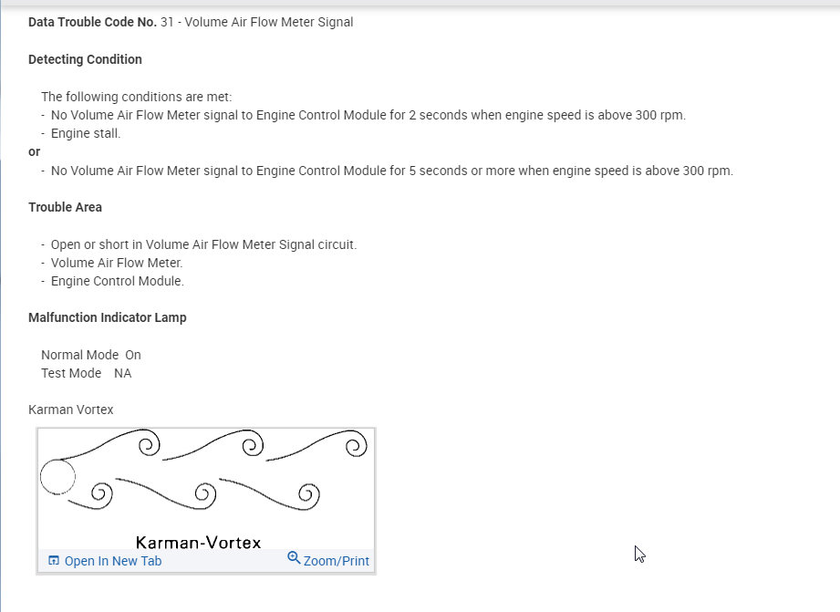

Circuit Description
When a pillar (Vortex generating body) is placed in the path of a uniform flow, vortices called Karman-Vortex are generated downstream of the object. Using this principle, a vortex generator is placed inside the volume air flow meter. By measuring the frequency of the vortices generated, the engine control module can determine the volume of air flowing through the volume air flow meter. The vortices are detected by their exerted pressure on thin metal foil (mirror) surfaces and a light emitting element and light receptor (LED and photo transistor) positioned opposite the mirror which senses the vibrations in the mirror optically. The engine control module uses these signals mainly for calculation of the basic injection volume and the basic ignition advance angle.
Yes. You could have an issue with the ECM. The three possible causes of this code and your issue are the sensor, wiring, or the ECM. I supplied all the testing for this code so if you run through this you will find the cause.
I would not just replace the ECM as this is the most likely cause after the sensor but that is expensive if it turns out to be a wiring issue. You can find that out with this testing.
Let me know if you have questions. Thanks
