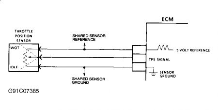

Any recommendations would be appreciated here, as I am not in the mood to pay Buick another $100 just to confirm what I figure is a throttle position sensor. (It stalls for no reason, during normal driving conditions.)

Hi The car has a cross over system not OBDI or OBDII and requires a GM Tech I scanner,am not aware of another scanner. If you suspect the TPS put a volt meter pos lead on Dark Blue wire and Neg on either Black,Black/orange or Purple. Key on slowely open throttle less than 1 vdc at closed throttle and slowely goes up as opened to 5vdc. if it does then TPS good. Hope this helps Thanks for donate

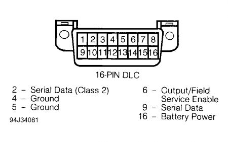

You should have only 1 or 2 oxygen sensors. All OBD2 have 4 oxygen sensors. Now if you would like to pull the codes yourself with out the scanner tool then here is how you do it. You get paper clip and you make a u out of it. Now you put between term 5 and 6 on the diagnostic connector (look at pic below) or if your connector is labeled the it is term A and B. Now you turn the key on engine off and then count the blinks of the check engine light. It will first blink 1 short pause then it will blink 2 (code 12) and then longer pause then it will blink the codes in the same manner. So if you get 2 blinks and short pause then 3 blinks and a longer pause the that is code 23 and so on. It will repeat each code 3 times before moving on to the next code. Let me know what you find.
