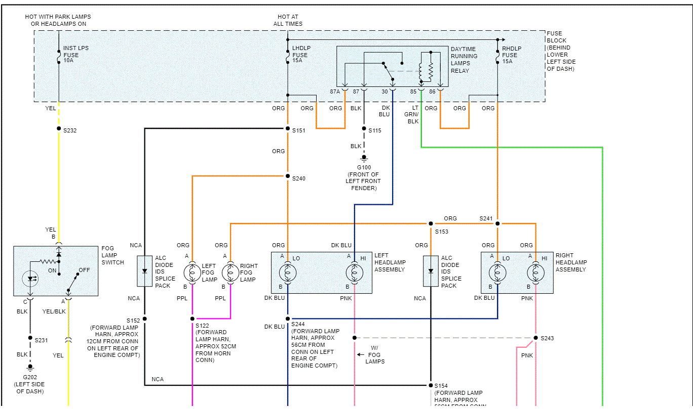

Passenger side headlight is dim
1998 CHEVROLET CAVALIER
126,446 MILES • 2.2L • 4 CYL • 2WD • AUTOMATIC
JAMESP1971
Need to find the ground wire.
Mar 7, 2021 at 10:50 PM
  • 110,240 POSTS

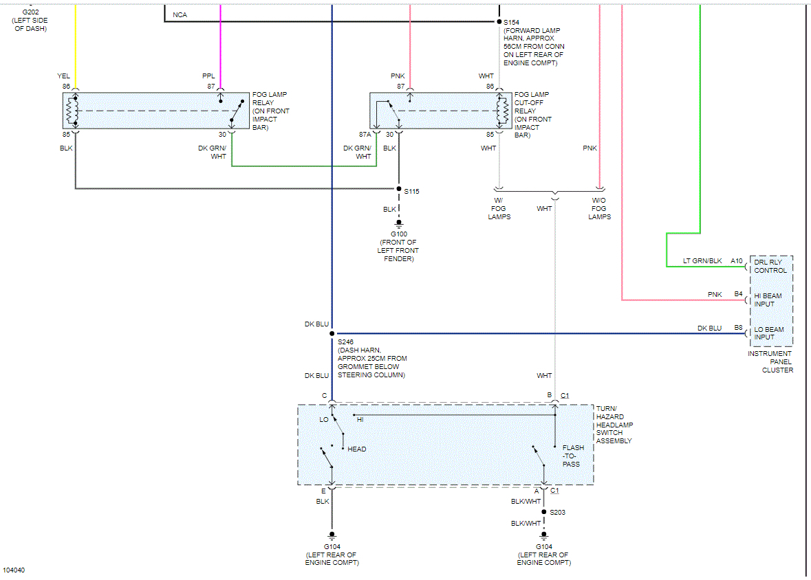

The ground is at the left rear of the engine compartment. Here is the thing. Power is supplied to the light and then grounded via the switch. Both lights use the same ground. So, I suspect you have a bad connection in the light socket. Check that first.
I attached the entire wiring schematic below for the headlamps. I had to cut the one pic in 2 so you could read them, but I did overlap them so you could follow them easier.
