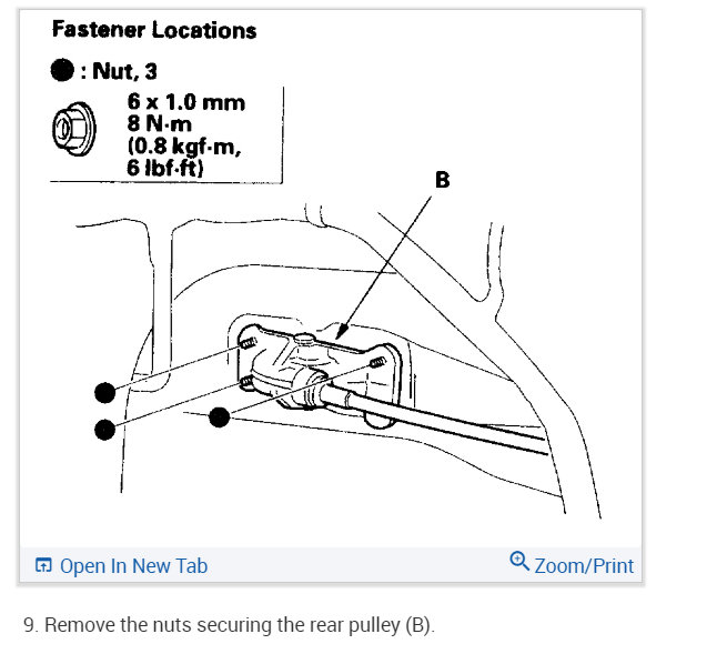

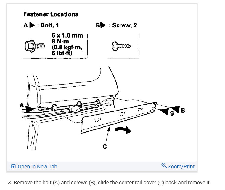

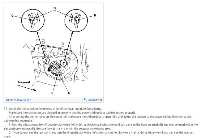

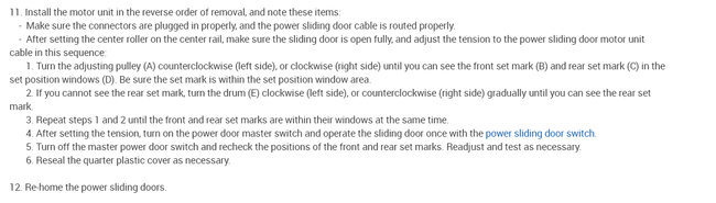

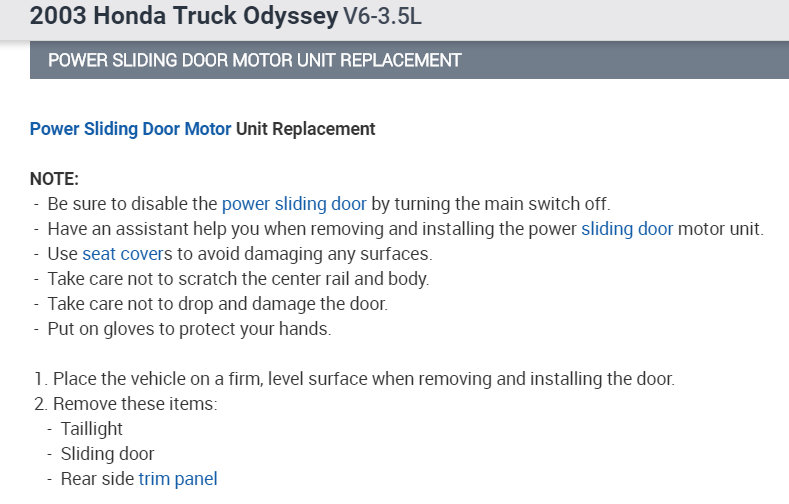

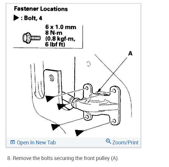

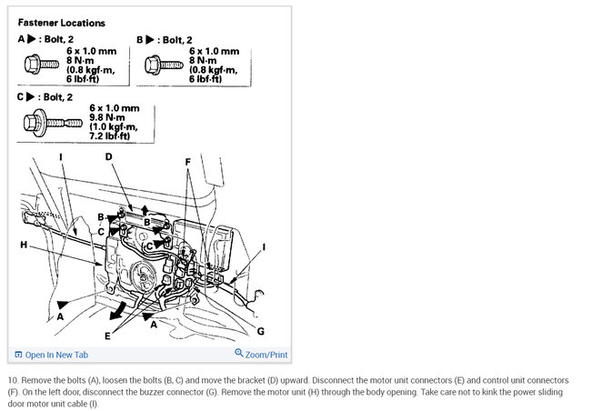

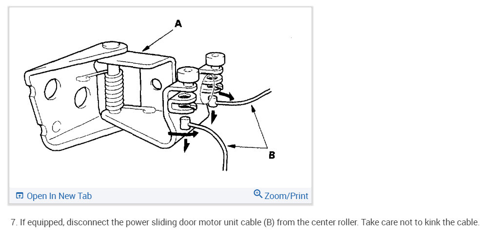

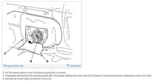

With a broken cable the doors will not work because they lose their "home" which causes the module to shut down, You will need to fix the motor and cable here are instructions below to help you do so. Check out the diagrams (below). Please let us know what you find. We are interested to see what it is.

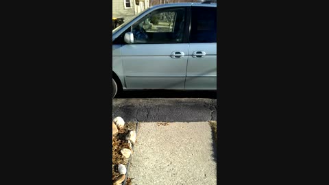

Ken, attached find a video that I hope will help.
Fred
You may need to turn up volume to hear the door mechanisms.
Mar 26, 2019 at 4:04 AM
  • 55,743 POSTS
Yep, classic protocol issue due to the broken cable. I would concentrate fixing that issues should solve the other problems. Thanks for the video done perfect, I wish all people with problems uploaded the issue. Much better than trying to explain it.
