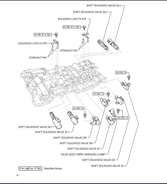

Can i go ahead and replace that solenoid once i replace the fluid? If so how?
May 3, 2020 at 2:09 PM

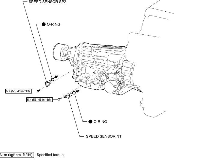

The sensors the code is referring to are on the side of the transmission.
I attached a picture for you of the location. I doubt it is them as all they are doing is sending a signal. The code does not indicate a sensor failure.
May 3, 2020 at 7:07 PM
NASER NASER
  • 836 POSTS
The sensor is for a lock up torque converter switch which should be inside the transmission once the pan is off.
May 3, 2020 at 10:28 PM
Correct but if there was an issue with the converter lock up , you would have a code for it, which you do not.
There is no lock up solenoid. It is a shift solenoid which opens a passage for the torque converter clutch to lock up.
I attached a picture of the shift solenoids and there locations for you.
May 3, 2020 at 10:44 PM

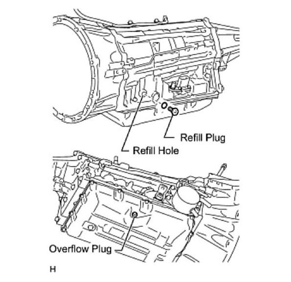

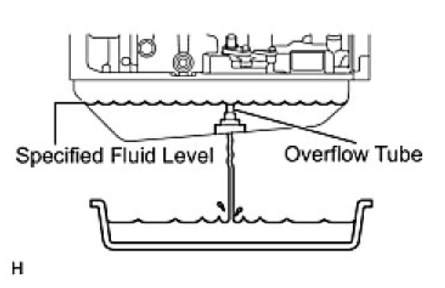

This is like the old Ford transmissions. There is a large plug on the bottom of the pan with a small plug in the center of the big plug.
Remove the big plug for draining all the fluid. then when refilling, you do it from the side of the transmission. You remove the small plug in the pan and when the fluid level is correct, it will spill out the plug.
1. BEFORE FILLING TRANSMISSION
This transmission requires Toyota Genuine ATF WS transmission fluid.
After servicing the transmission, you must refill the transmission with the correct amount of fluid.
Maintain the vehicle in a horizontal position while adjusting the fluid level.
Proceed to the "Transmission Pan Fill" procedures if you replaced the entire transmission, transmission pan, drain plug, valve body and/or torque converter.
Proceed to the "Transmission Fill" procedures after removing the refill plug if you replaced the transmission hose and/or output shaft oil seal.
2. TRANSMISSION PAN FILL
(a)Remove the refill plug and overflow plug.
(b)Fill the transmission through the refill hole until fluid begins to trickle out of the overflow tube.
(c)Reinstall the overflow plug.
3. TRANSMISSION FILL
(a)w/ Trailer Towing System (w/ Thermostat):
Push the shaft of the thermostat and fix it in place.
(1)By using compressed air, etc., blow dust off of the thermostat cap to clean it.
(2)Using a screwdriver, push the shaft of the thermostat.
HINT:
Pushed amount: 5.5 to 7.0 mm (0.217 to 0.276 in.)
Push the shaft until the screwdriver contacts the step inside the cap.
(3)With the shaft of the thermostat pressed, push a pin (diameter: 1.0 to 1.8 mm (0.0394 to 0.0709 in.)) into a hole on the side of the thermostat cap. Insert the pin until it passes through the hole on the other side of the thermostat cap to fix the shaft in place.

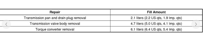

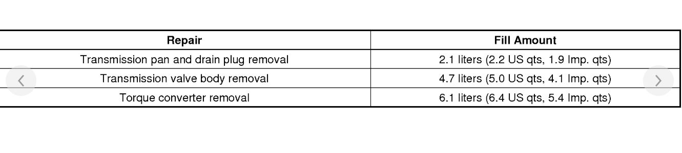

(b)Fill the transmission with the amount of fluid listed in the table below.
Standard capacity:
May 4, 2020 at 1:57 AM

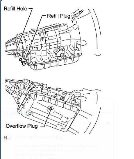

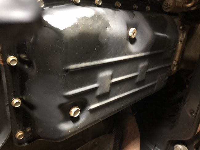

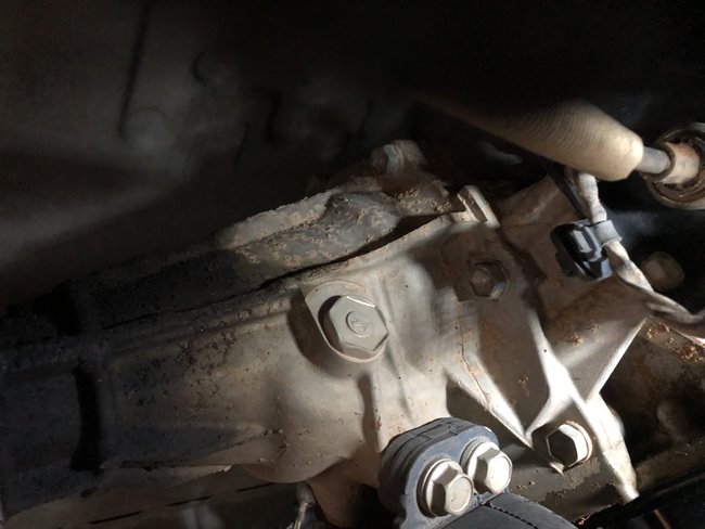

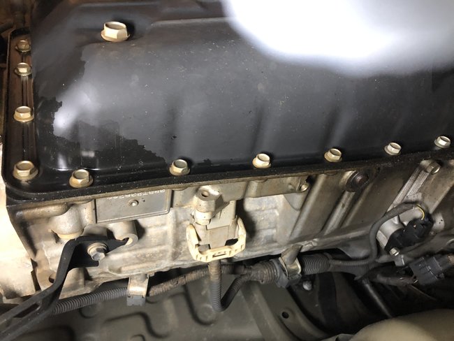

The pictures i have look different, two drain plugs one 14 mm or so appears to be the one to drain everything and the allen key one to front right of pan is the overflow i assume, no fill plug like the picture, i only see one on back right of transmission. does this look like it?
May 5, 2020 at 8:39 AM
NASER NASER
  • 836 POSTS
I have the 4.7l.
May 5, 2020 at 8:42 AM
Is this the one?
May 5, 2020 at 8:48 AM
NASER NASER
  • 836 POSTS
Yup that's it, i figured the other one is for the 5.7 i believe. Some say heat it to 130f then check the overflow but will it work the same if i just fill while engine off and watch the overflow?
May 5, 2020 at 9:08 AM
I would fill it to the max. Then run the engine to normal operating temperature and then shut it off and check the level.
May 5, 2020 at 9:29 AM
