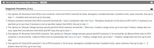

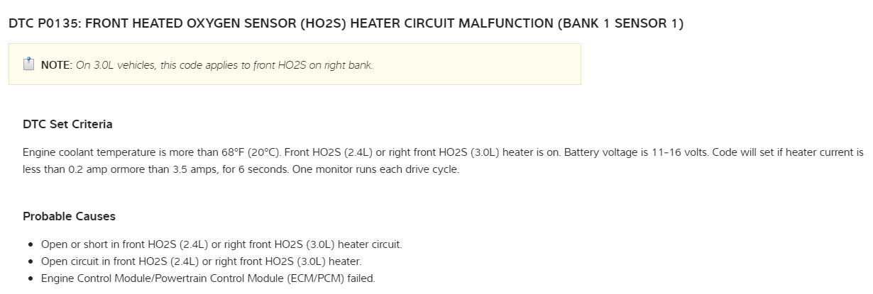

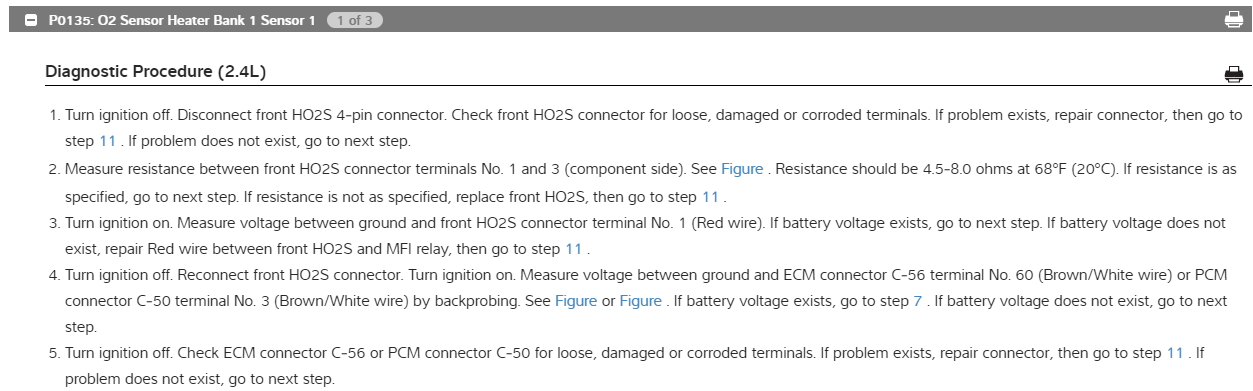

I've now got a P0135 as well which made me think back to this thread where you guys had me test the upstream and downstream o2 sensors with my ELM327 scan tool along with the OBD2 Car Scanner Android app. How can I tell that the upstream sensor is bad? Should I test from a cold start or with the car fully warmed up when testing the upstream o2 sensor? Just a steady idle or should I rev the engine? From a video I was watching, the voltage should steadily fluctuate between .1 and .9 volts approximately, and if it's flatlined then the sensor is bad.

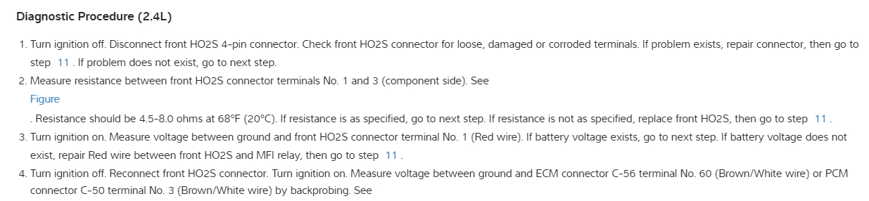

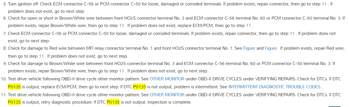

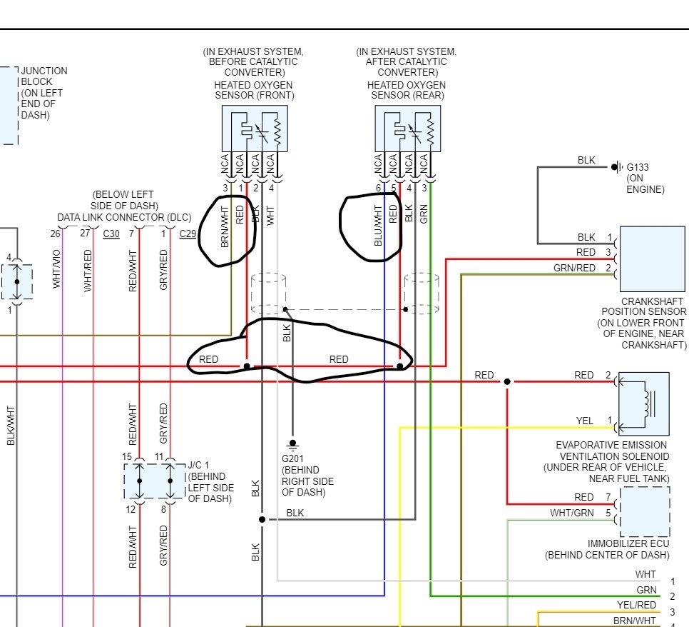

P0135 would be a heater circuit code for the upstream sensor. It is set when the ECM decides that it's taking too long for the sensor to heat up from the heating element inside it and start switching. It does that by checking the current and sets the code if the heater current continued to be lower than 0.2 ampere or higher than 3.5 ampere for 6 seconds. The sensing part is still working so on the scan tool it will look normal. I don't think that system has the bi-directional ability to turn the O2 heaters on and off to make testing easier. The way it works is simple, the red wire should have battery power with the key on. This same power feeds the crank and a couple other sensors so it should be okay, the brown with white stripe wire is the control wire from the ECM, it grounds to turn the heater on. Same thing happens on the blue with white wire on the downstream sensor.
Testing with a scan tool would be simple, connect a test light to the bed and brown with white and turn the heater circuit on, if the light comes on, that part of the circuit is okay, and you replace the sensor. Without a scan tool you are sort of stuck with just unplugging the sensor and doing a resistance test to see if the heater is still intact. For that you unplug the sensor and use an ohmmeter across the terminals to find if the reading is between 4.5 - 8.0 ohms. If it's lower it's shorted if it's higher it's either open or has a wiring corrosion issue, in either case you replace the sensor. Check that you have battery voltage at the red wire.

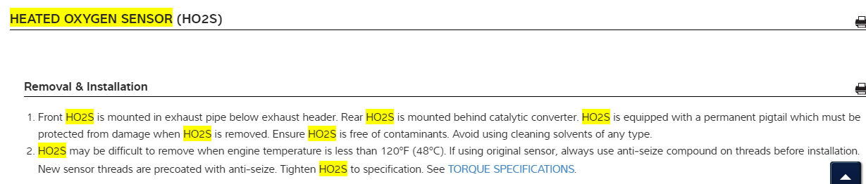

After I replaced my upstream o2 sensor that got rid of both the catalytic converter code and the o2 sensor code for months. But now I got 2 new P0421 codes and 1 new P0442. I had replaced the fuel pressure regulator hoping that would clear the P0442, but alas, no. I have freeze frame data for one of the P0421 codes:

I wanted to give an update on this thread. I ended up replacing both of the O2 sensors which cleared all my O2 sensor codes. My fuel filler neck was rusted out and started causing a fuel leak while gassing up, so I replaced that with an OEM one and that fixed the P0442 code as well as the leak. I haven't wanted to replace the catalytic converters as they do seem to be working. So, I bought some Dura Lube Severe Catalytic and Exhaust Treatment Cleaner which I'm going to try. If that doesn't work, then I will finally try the Liqui Moly 8931 Catalytic-System Cleaner. I've been reluctant to spray it into the throttle body as I was warned if it pools up that it can cause damage. But I bought the stuff 3 years ago as well as a Hudson sprayer and just haven't committed to trying it yet. Anyway, hopefully one of these products will fix my P0421 since that seems to be a much less severe code than P0420.
