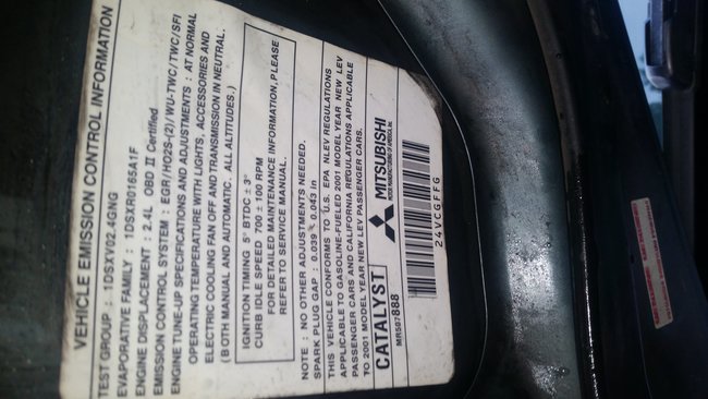

Emission type will be on the sticker under the hood that tells the plug gap, engine type and such. Build date is on the door with the VIN.

Here's the info from the Vehicle Emission Control Information label under the hood. The picture is also attached. So what does this mean? What catalytic converter(s) would I need to buy? This is basically a permanent check engine light until it's fixed it seems.
Test Group 1DSXV02.4GNG
Evaporative Family: 1DSXR0165A1F
Emission Control System: EGR/HO2S (2)/WU TWC/TWC/SFI

That is a California emissions vehicle sadly. That means to be fully legal it needs to have C.A.R.B. certified parts. Rock auto shows C.A.R.B. legal front units for about $450.00 and the rear for about $300.00 both plus shipping. What you might want to do is check with a local exhaust shop and see what they say, in NY and California you would have to use the C.A.R.B. parts, but I'm not 100 percent sure in Colorado as they keep changing things. If you are doing it yourself it might be possible to use the federal parts to lower the costs, but I would check there first. Wouldn't want you to replace them and then have them tell you the new parts are not legal in your area.

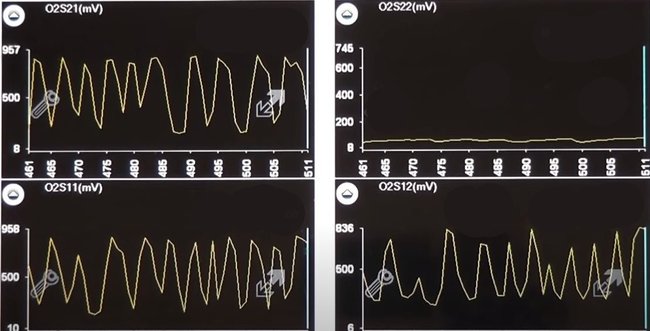

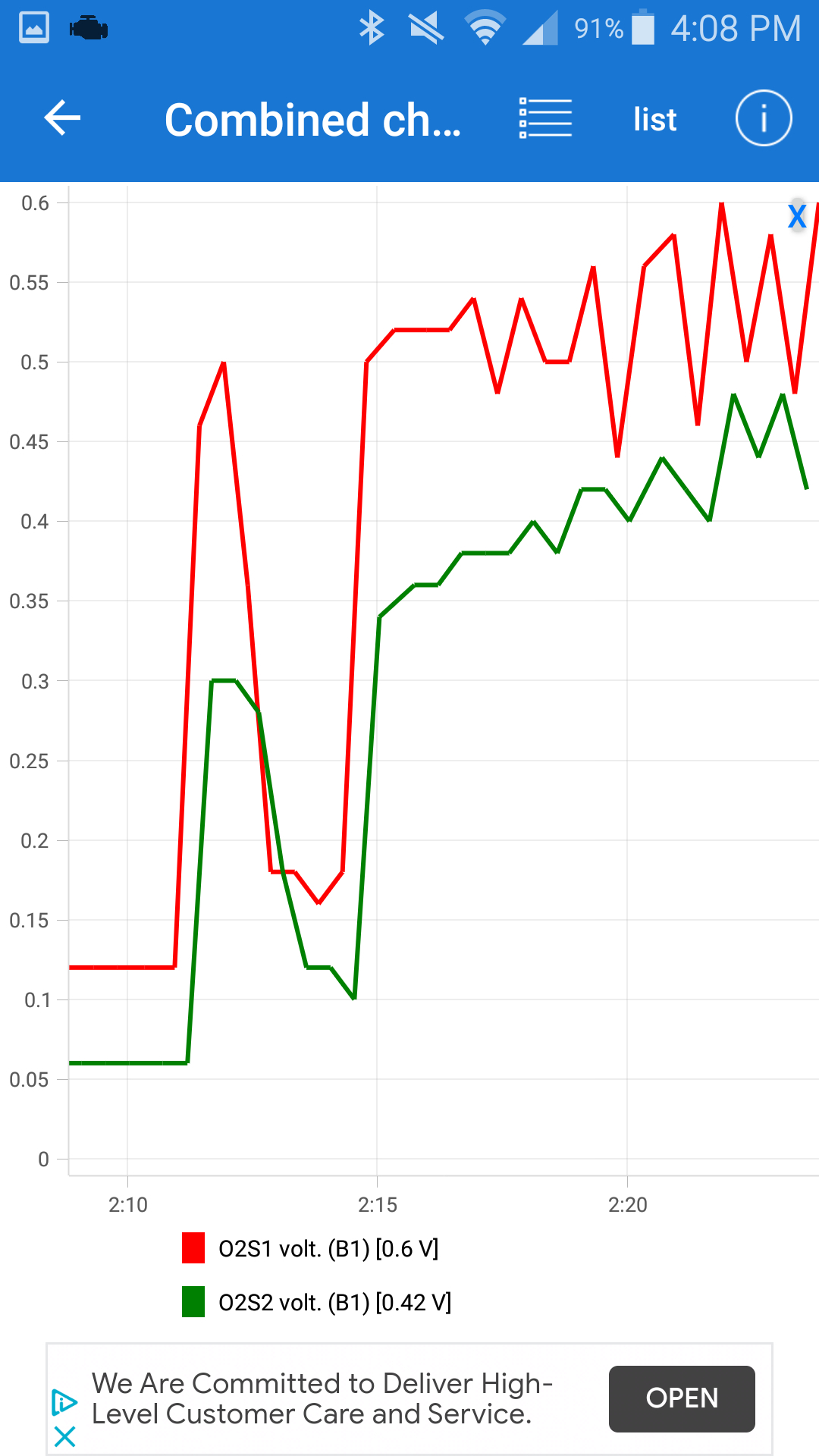

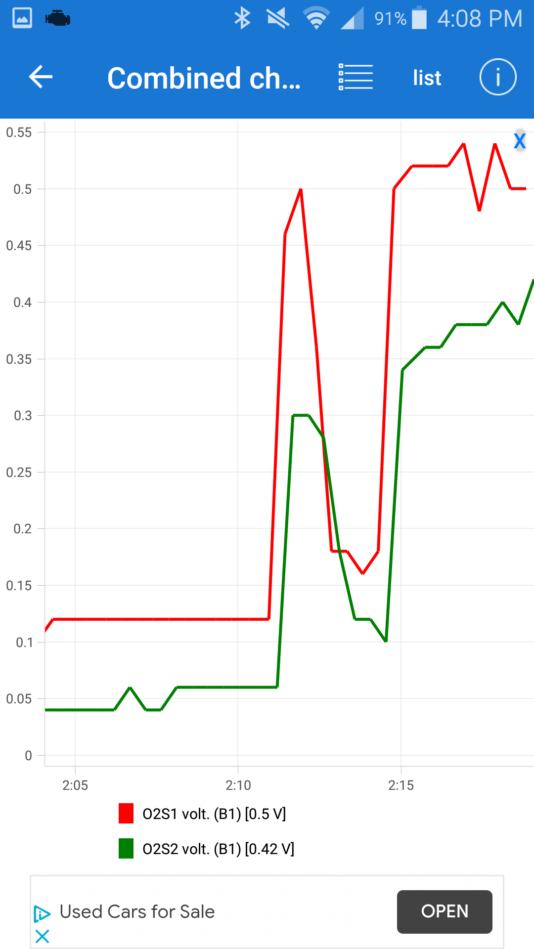

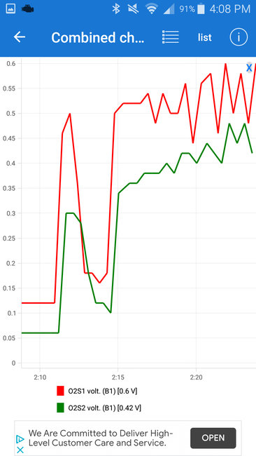

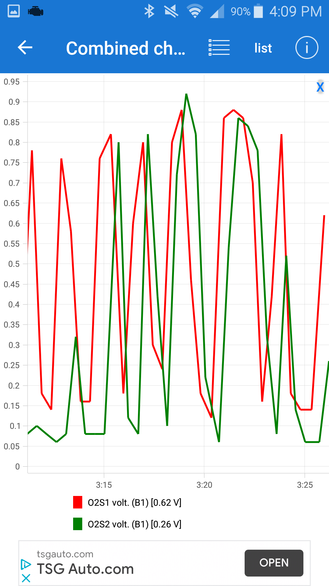

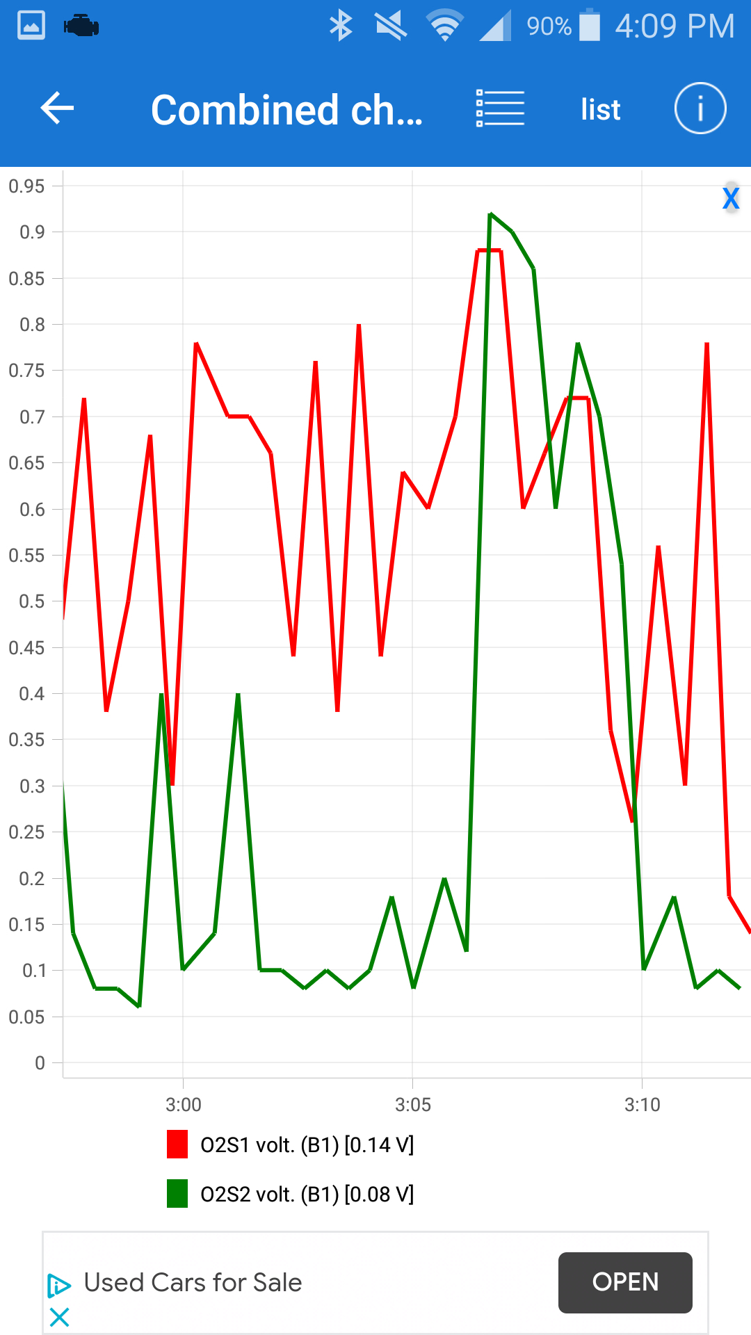

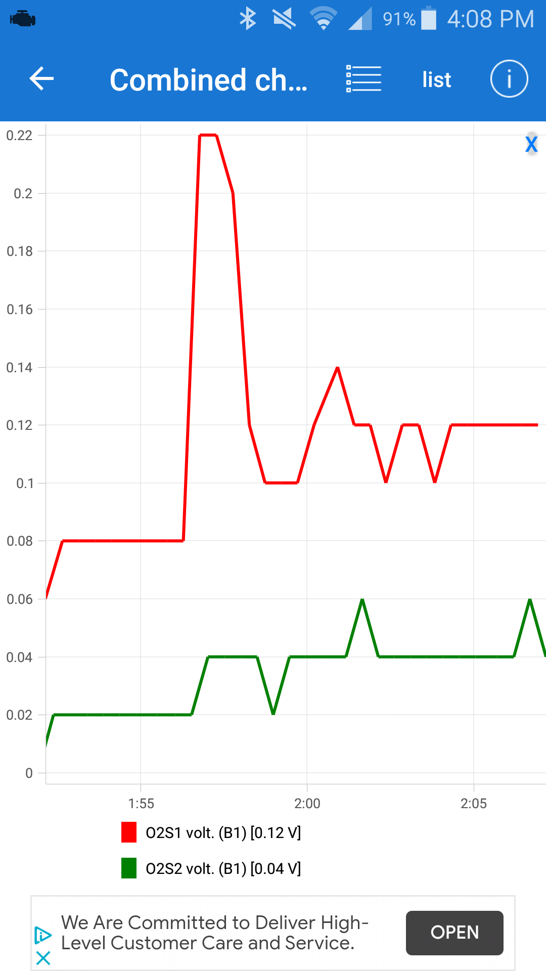

Alright ,I just ran the test. Here are five screenshots of the data comparison. They definitely don't line up perfectly.
Aug 16, 2020 at 8:15 AM
STEVE W.
  • 15,294 POSTS
Based on those the converter is barely working. Mitsubishi must have a wide latitude on the trigger for the code the way that looks. I'm surprised it also doesn't have a P0420 set due to the way it is responding even once it's warm.
Aug 16, 2020 at 9:01 AM

Well, that was only a minute or two. Should I try again tomorrow and go longer? Not sure it was fully warm when I stopped.
Aug 16, 2020 at 9:04 AM
STEVE W.
  • 15,294 POSTS
That system should be working in about 45 seconds to a minute. You can see it starting to get warm in the third frame. What you don't want to see is that last frame.

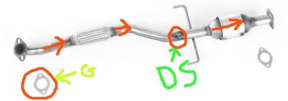

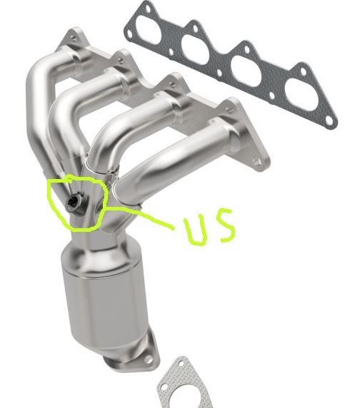

If this car has the dual units on it, which a California car came with, you don't need to go under the car to get to the pipe, the first O2 sensor should be under the hood in the exhaust manifold between the engine and the radiator. Then you would spray the product into the sensors bung then replace the sensor and start the engine. Do not forget to put the sensor in as the exhaust pressure could spray it all back out and cause a real mess. The downstream sensor is behind the converter being monitored in the pipe that leads to the second converter. This was a common thing on many vehicles. They would install a converter close to the engine. Then they would do testing and discover that those units were good enough for the federal requirements, but didn't do so well with the stricter sniffer testing in California so they added the second converter in the pipe farther back to finish scrubbing the gasses. On more modern vehicles they monitor all of the converters so a modern 4 cylinder can have the dual converter system but will have a bank one sensor one then a sensor 2 and a sensor 3 as well with 2 being between the two converters like yours and sensor 3 being in the pipe between the second converter and the muffler. Larger engines can be even more interesting with a couple that have 3 converters on each bank of cylinders.
Aug 18, 2020 at 6:16 AM

I believe that exhaust manifold is behind a heavy duty heat shield. If you Google "LIQUI MOLY Catalytic-System Cleaner (#8931)", the first video that comes up appears to show it being sprayed into where the air intake hose connects to the engine. It says to spray it into the intake tract at regular intervals with the engine running between 2,000 and 3,000 RPM's, not to spray it all in at once first.

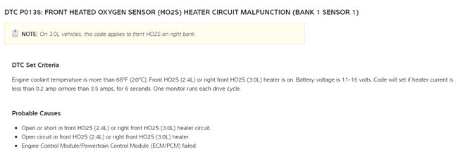

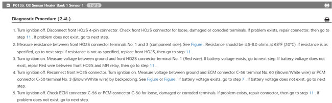

Aug 11, 2021 at 10:31 AM
STEVE W.
  • 15,294 POSTS

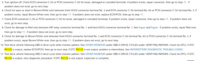

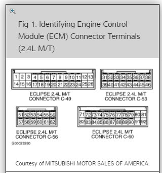

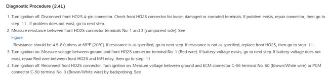

The P0135 is an O2 heater circuit code for sensor bank one. So it's the sensor before the converter that is giving the P0421. I would look at the wiring to it to be sure it isn't damaged or shorted. It won't be the reason for the 421 code though.
Aug 11, 2021 at 3:38 PM

Could you discuss the possible sources of the small evap leak for 442?
We already concluded 421 is caused by one of the catalytic converters (my car has 2) since I actually did a live data reading with a scan tool and Danny told me the catalyst is definitely not performing correctly. But I have no symptoms of a clogged exhaust system, so it seems to imply the 2nd catalyst is taking care of the hydrocarbons. It's just that the o2 sensor only senses that the first one isn't working properly.
Aug 11, 2021 at 4:16 PM

Correct in that the P0421 is a bad bank one cat, the P0135 is the heater circuit for the first O2 sensor on that same converter. The two are only related in that they are the same bank.
As for the EVAP leak code, site policy is to keep different issues as separate questions to make site searches easier. So please use the link below to ask that as a different topic. Thank you.

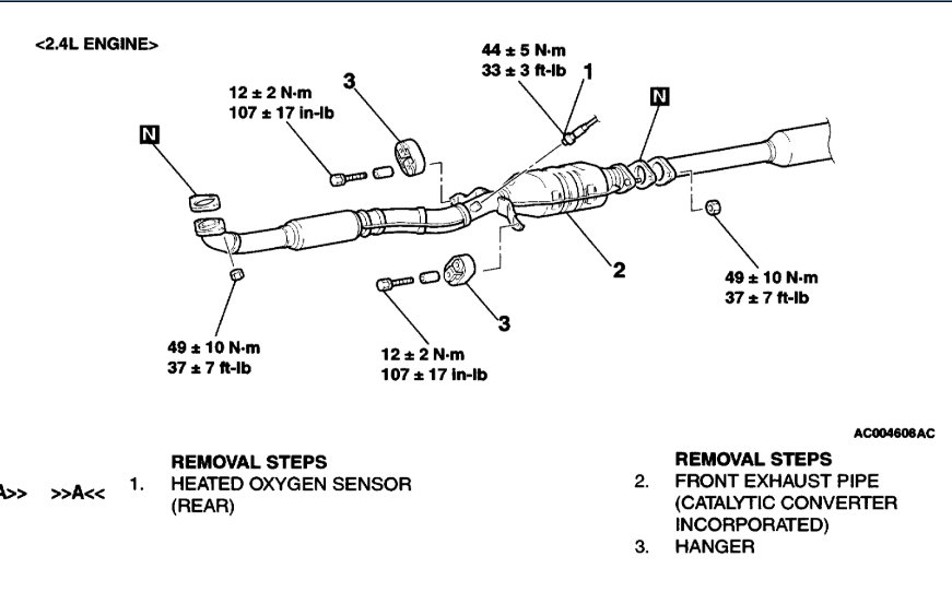

Hello again.

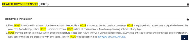

I've attached picture diagnostic steps below relating to code P0135. As far as code P0421 that is a separate issue and will need to be addressed in a new question.
Here is the new question link:
Hope this helps and let us know if you have any further questions on this issue. Thanks again for using 2CarPros.
