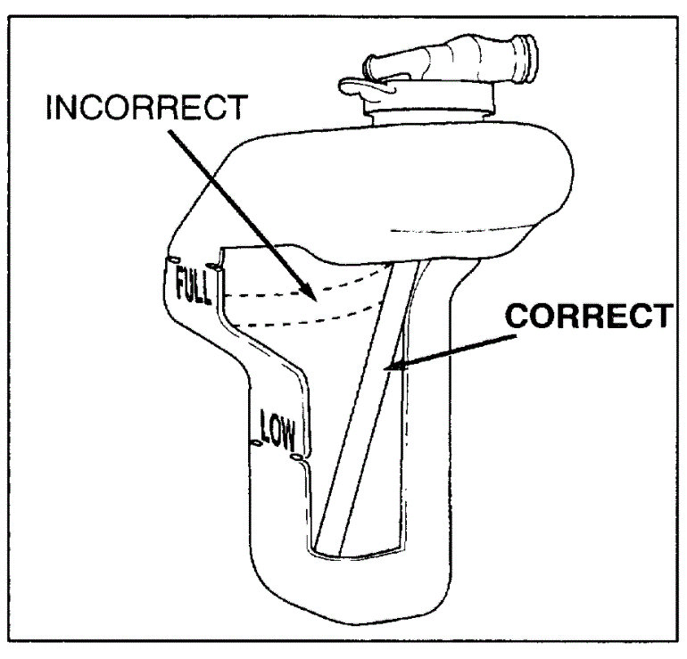

It shouldn't be to the top of the reservoir. There is a line indicating full. It shouldn't be higher. Also, there was a service bulletin years back that indicated an overheating concern when the hose in the tank was not position properly. Take a look at the attached pic just to make sure that isn't an issue.
I want you to try something. When the engine is cold, remove the radiator cap and start the engine. Does the coolant spray out?

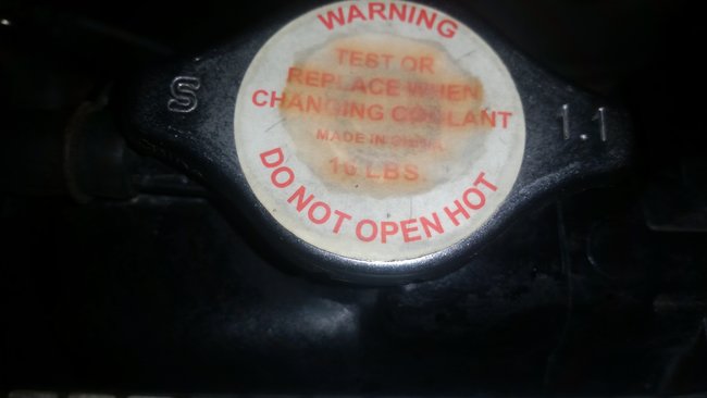

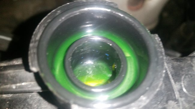

I was referring to the radiator itself. I fill it up to the filler neck, and the pressure from the system shoots some of the coolant up into the rim around the cap area. I was thinking maybe with such a small amount in there, it could get really heated up to the point of evaporating. I also noticed the sticker on the radiator cap was rather damp. It did rain tonight but nothing else was wet in that general area, so it seems to have come from out of the radiator itself. I switched back in the old radiator cap, but noticed the sticker on that is completely worn out. So it may have had the same thing happening. I've attached pictures.
Also, yes it does shoot out coolant with the cap off and engine started. It seems to pressurize properly, and the pressure test at Midas showed it continuing to hold proper pressure. I don't fill up coolant in the reserve tank / reservoir, it is currently sitting maybe a half inch above the low line. It doesn't seem to vary much when I check it. Also the reserve tank is only semi translucent so it's hard to see the hose in there, but I pulled it out and put it back in, and it goes all the way to the bottom, doesn't seem to be bunching up or anything.
Maybe I should spring for an OEM radiator cap and see if that helps any? I do know switching to an OEM gas cap fixed my P0442 gas cap issue before, when an aftermarket one was still triggering the code.

If it shoots coolant out when first started (engine cold), it sounds like compressed air is getting into the system via a head gasket.
I suspect that is the issue.
