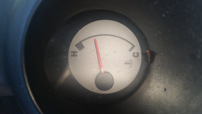

Hello guys,
For a while now I've been noticing my engine temperature creeping above halfway up the thermostat gauge while idling. Today it actually got up to the red while idling at a drive thru for 15-20 minutes with the A/C going on a hot day (80 degrees but car was sitting in the sun first). The thing is, the radiator is basically new, it was replaced in August of last year. I also have seen no coolant leaks or white smoke, so I don't think it's the radiator or any hoses. Also, I turned the defroster onto hot and the highest blower setting, which did get the temperature to drop a bit, indicating that it's not the Engine Coolant Temperature sensor either. So I've reduced it down to mainly water pump or thermostat. I've heard the EGR valve can also cause overheating issues, but if it's clogged it generally produces black smoke out of the exhaust, which I don't have. Does it sound like water pump or thermostat or something else? FYI water pump is 4 years old, and the timing belt that I got in the same kit wore out faster than it should, just replaced it a couple months ago. So that also makes me think the water pump is on its way out.
Thanks,
Adam

Hi Adam,
Does the vehicle ever overheat when driving at highway speeds? If it only happens when at idle in traffic or not moving, chances are the cooling fans are not turning on. Have you checked if they work?

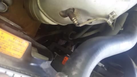

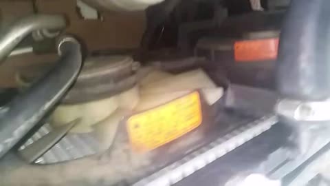

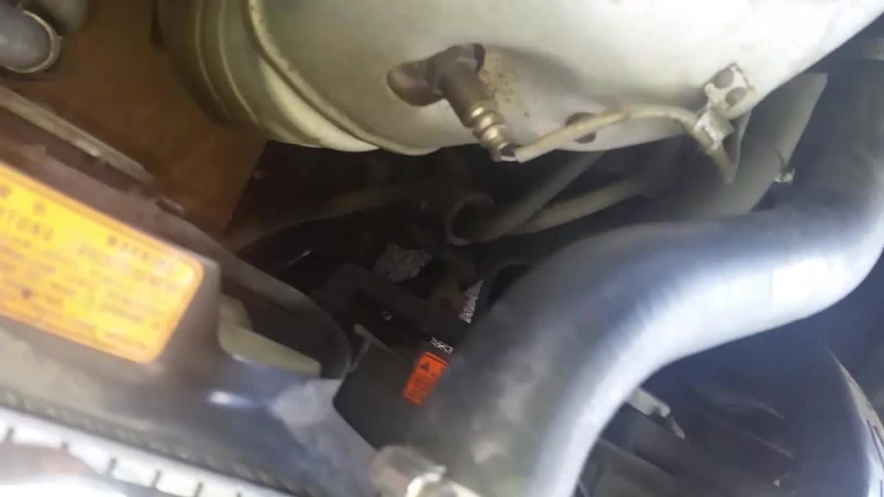

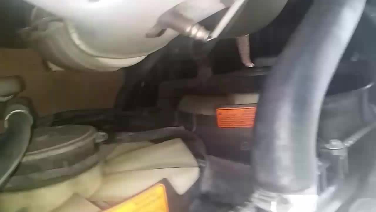

KIWASABI1
  • 202 POSTS
The white smoke is coming from the back of the radiator. I do not have steam or white smoke coming out of the tailpipe, at least not in large quantities. I attached 2 videos of the white smoke in the last 3 comments of page 1 of this thread.
Jun 26, 2020 at 2:54 PM
  • 110,240 POSTS
Okay, I watched them. Is that steam? Does it have any specific smell to it? Coolant will usually have a sweet smell. Oil can smoke like that as well.
Jun 26, 2020 at 2:58 PM
KIWASABI1
  • 202 POSTS
I'm pretty sure it was a sweet smell. It was coming from the back of the radiator, behind the fan.
Jun 26, 2020 at 3:00 PM
KIWASABI1
  • 202 POSTS
And yeah it is probably steam rather than smoke. Seemed lighter and wispier than smoke.
Jun 26, 2020 at 3:04 PM
  • 110,240 POSTS
Then there is a leak in the radiator or one of the radiator hoses. You will need to pressurize the system to check it when the engine is cold. Here is a link that explains how that is done. You will need the right tool, but most parts stores will lend that to you. It appears this is where the coolant is going.
