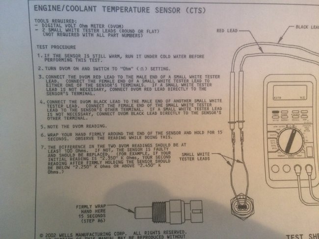

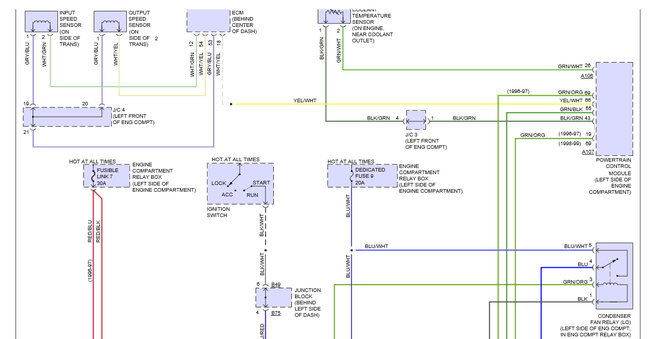

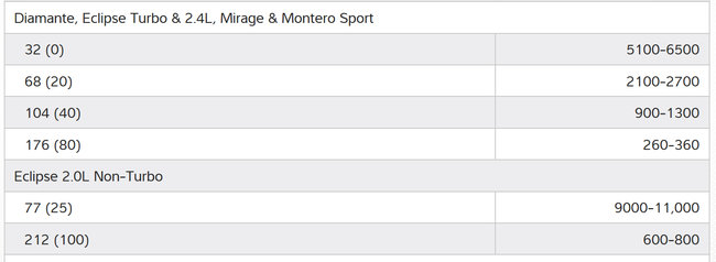

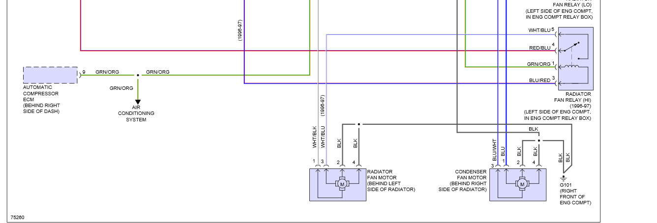

Check the fuse and relay for cooling fan. Also, may be the coolant temperature sensor. See picture for how to check that and wiring diagram for cooling fans. Diagram for non turbo.

All of the relays were the same so by swapping them around I determined they were all good. The fusible link was good. The fan would not run at all when it was out but it did when I put it back. I have an OBD 11 adapter and it is not coming up with any fault codes. I replaced the thermostat this morning no change. No leaks of any kind. When I turn my blower switch to high the needle will come back to almost normal.

If you can read this it is the test I just did. My first reading was 1.53 and the second reading was 1.43.

It did not show the photo sent so I am sending it again.

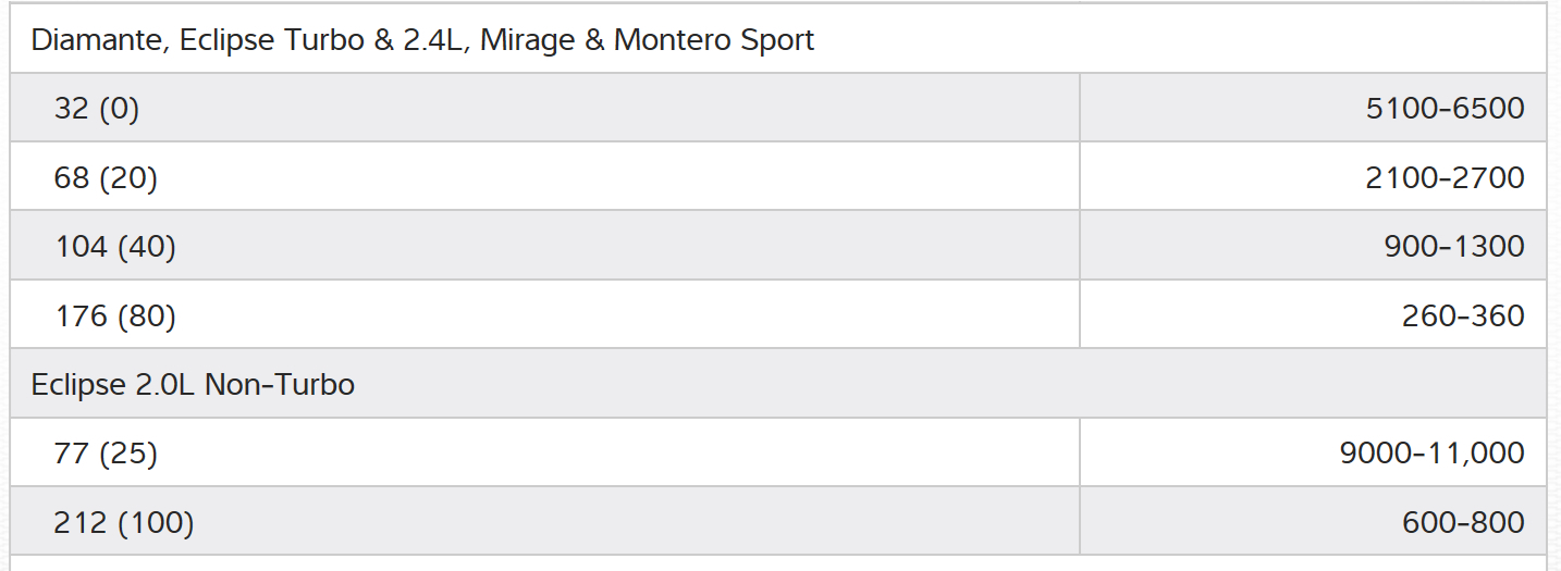

Okay, what was the voltmeter set to begin with? Then did you correspond with the chart I sent in first reply? One side is temperature other is what reading should be around ohm wise.
Tuesday, July 11th, 2017 AT 2:59 PM
MICHAEL WILSON2
  • 9 POSTS
Meter was set on 20 K.
Tuesday, July 11th, 2017 AT 3:07 PM
HMAC300
  • 48,601 POSTS
Okay, depending on temperature of engine it looks okay.
