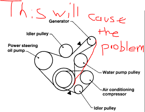

DREWINATOR69
This was how my belt was put on by previous owner this causes the car to overheat in just minutes and also some very violent reverse boiling to the top radiator hose exactly as you described.
+1
Tuesday, February 16th, 2021 AT 10:30 AM (Merged)
KEN L
  • MASTER CERTIFIED MECHANIC
  • 48,363 POSTS
Lol, yep that would cause a problem for sure, thanks for the input.
