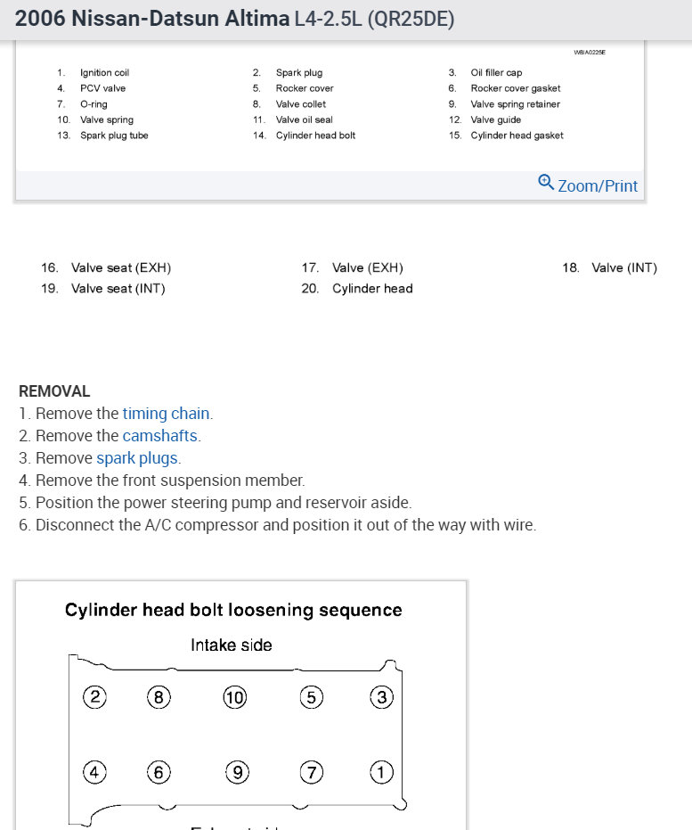

Yep, it sounds like a head gasket. Below are diagrams to help you see how the job is done. Check out the diagrams (below). Let us know what happens and please upload pictures or videos of the problem.

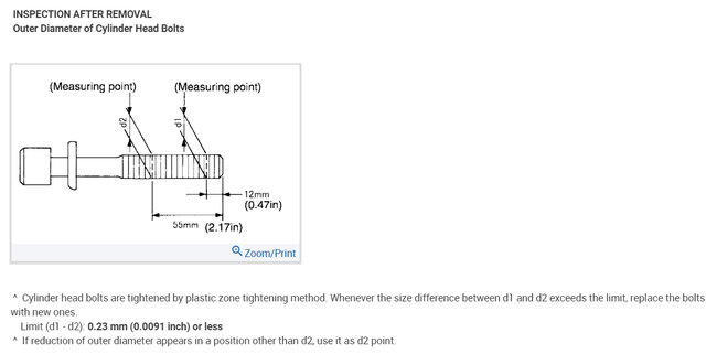

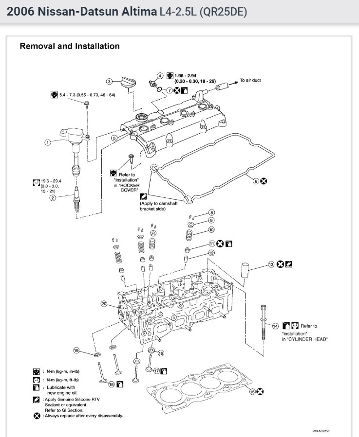

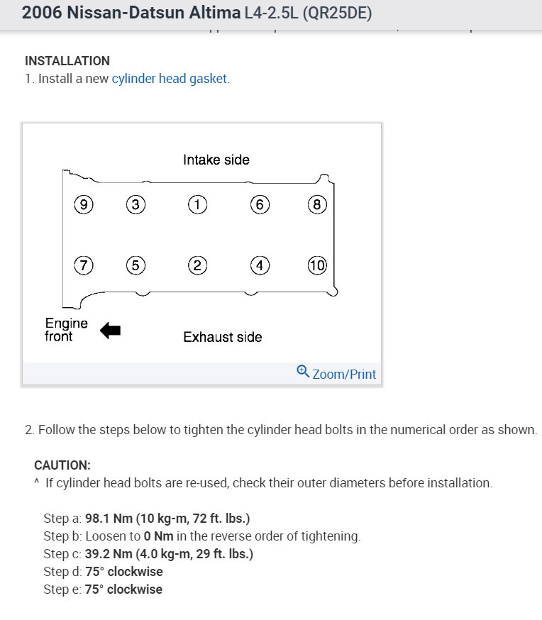

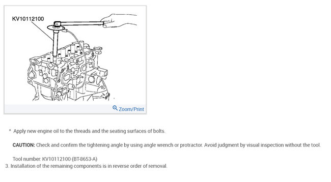

AK_ALTIMA05
  • 6 POSTS
Engine Cooling problem
2005 Nissan Altima 4 cyl Manual 64000 miles
Dear Mr. Expert!
I drive a Nissan Altima 2005 and the engine has overheated twice in the last 6 months with no apparent reason (i.e. normal temperature gauge reading), leading to oil/water contamination in both cases�
The first was at 97,000Km mileage. The head gasket was blown and the cylinder head surface was affected. The overheating was due to the failed lower cooling thermostat/valve, and the temperature gauge didn�t go up since there was almost no coolant in the radiator as the mechanic explained (due to internal leak). The repair job included replacing the gasket and straightening to the cylinder head surface. The 2 thermostats were replaced along with the water pump.
The second failure was at 102,000Km (5 months later). One week earlier I started to notice little coolant decrease which went large within a week (almost empty overnight). The temperature gauge didn�t go up this time either and the engine didn�t run on an empty radiator, since I was checking and adding coolant consistently. Upon engine disassembly, there was almost minimal to no damage to the cylinder head and its surface, but the engine block was affected and its surface needs to be straightened�
The concern is that there is no apparent reason for overheating, especially with the second failure. Could the temp gauge be broken, or it�s all because the repair job wasn�t done properly the first time? For the record, the engine block was NOT checked for straightness the first time.
Feb 16, 2021 at 2:25 AM (Merged)
2CARPRO JACK
  • 11,533 POSTS
It i spossible the head was damaged the first time and it wasnt caught. Cylinder heads should always be pressure tested as well as surfaced before reinstallation to ensure there are no cracks.For a block to warp is pretty difficult compared to a cracked head.

Looks like the limit for that is .1 The block will have to be removed, taken apart and decked
AK_ALTIMA05
  • 6 POSTS
Buying a whole engine (used one) would cost the same as replacing the head and decking the block... this is where the case is actually going now
Actually what i'm really concerend about is the CAUSE of the SECOND FAILURE... Was it because:
1) A bad 1st repair job ...... OR
2) Overheating again
I attaching 2 photos of the cylinder head after the two failures... From the comparison you may notice the head was muh less damaged the 2nd time (the red circles only) whcih makes me more convinced it didn't overheat
the issue seems complicated to me.... if u need more details and clarifications then I'm ready
2CARPRO JACK
  • 11,533 POSTS
Hard to say.... the warped deck (block) may have contributed to the second failure.A warped block is much stronger than awarped head and it will force the head to bend to conform
