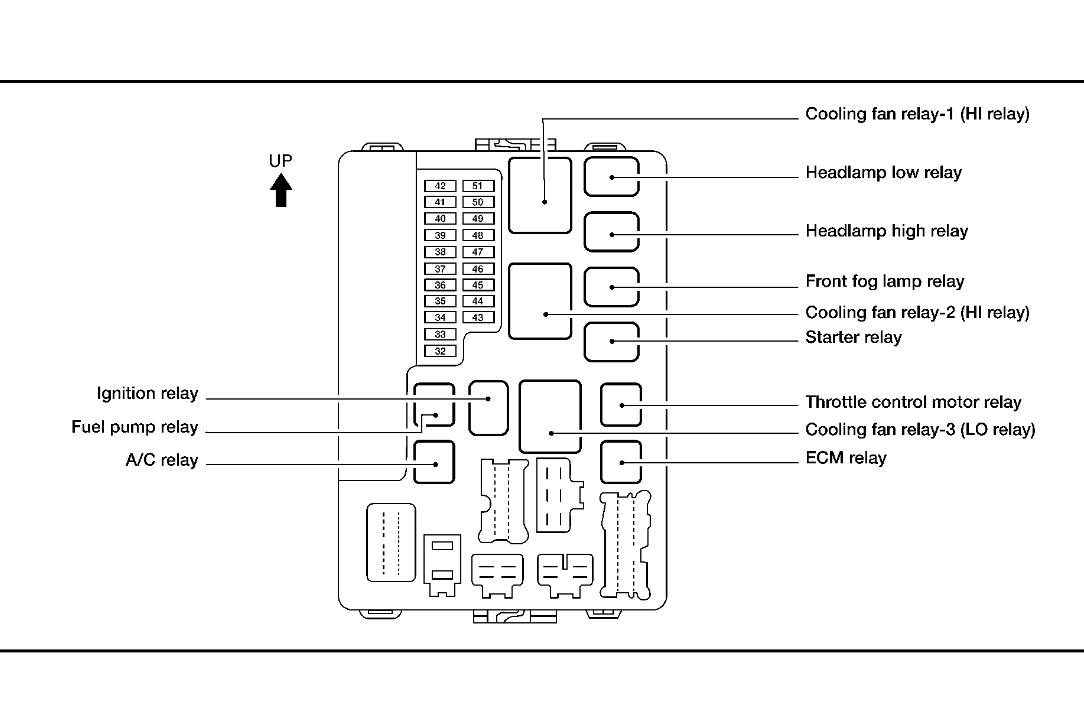

It gets a small spark on the first try but will not start. Any attempt after that no spark at all. Checked the coils and replaced the spark plugs. Hearing it can be a hundred different things. I removed the starter relay and found that the car didn't even make a sound. I removed the ignition relay and got the same response with the spark, I was wondering how can I tell if the ignition relay went bad?
Tuesday, October 14th, 2008 AT 9:16 PM
SQM
  • 6,383 POSTS
The ignition relay is located in the fuse box under the hood (see diagram below).
This relay can be tested to check functionality.
Here is a guide of how to test relays:
