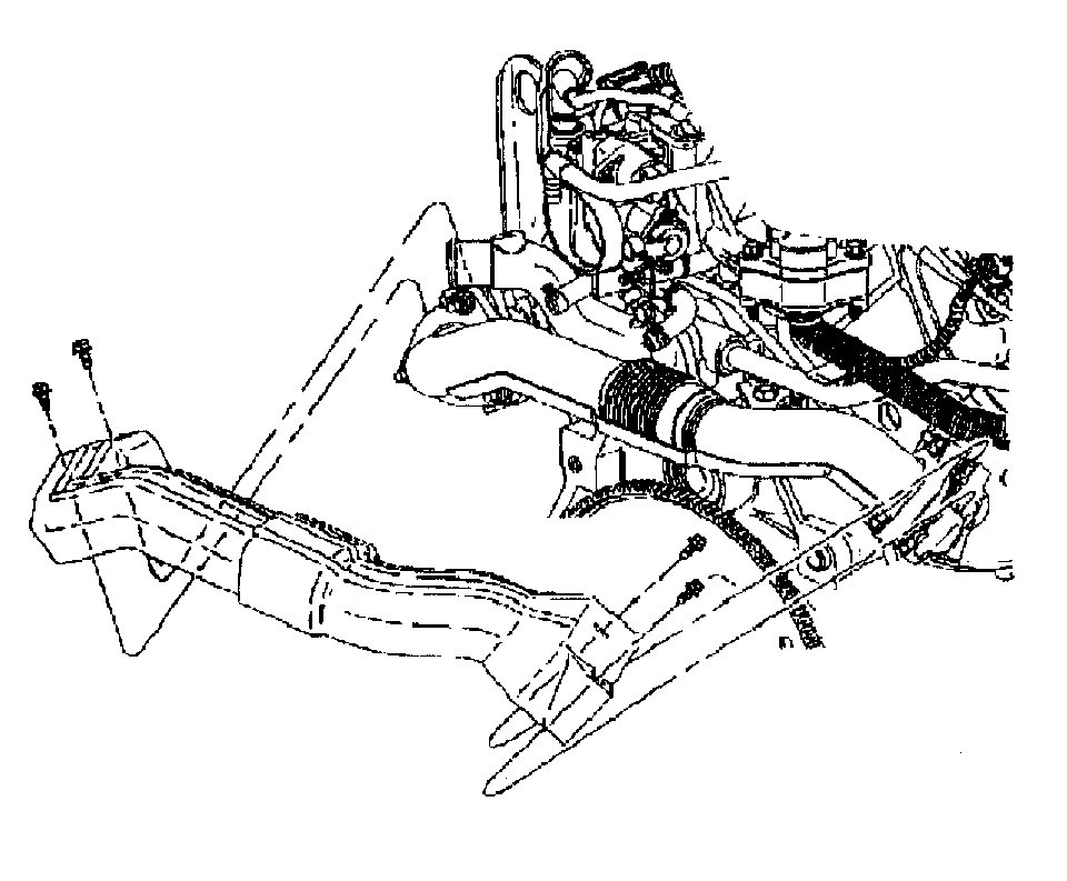

Possible head gasket failure.
White smoke out tail pipe and rough idle, keeps using coolant and empty the reservoir.
Would Blue Devil head gasket repair work?

How do I repair the head gasket on a 3.4 Grand Am ?
Mar 1, 2021 at 1:12 PM
  • 110,240 POSTS
It a somewhat big job, so what I suggest to first make sure that is the issue. Here are directions for cylinder head removal and replacement. The pics attached correlate with the directions.

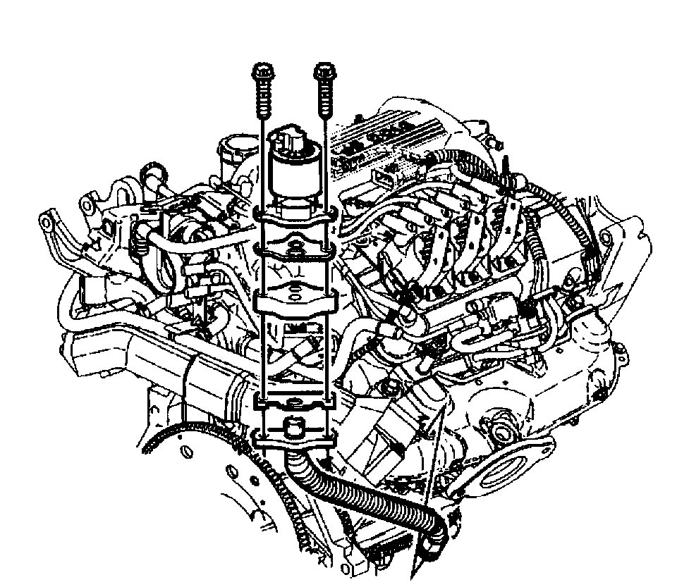

4. Remove the Exhaust Gas Recirculation (EGR) pipe, if equipped.

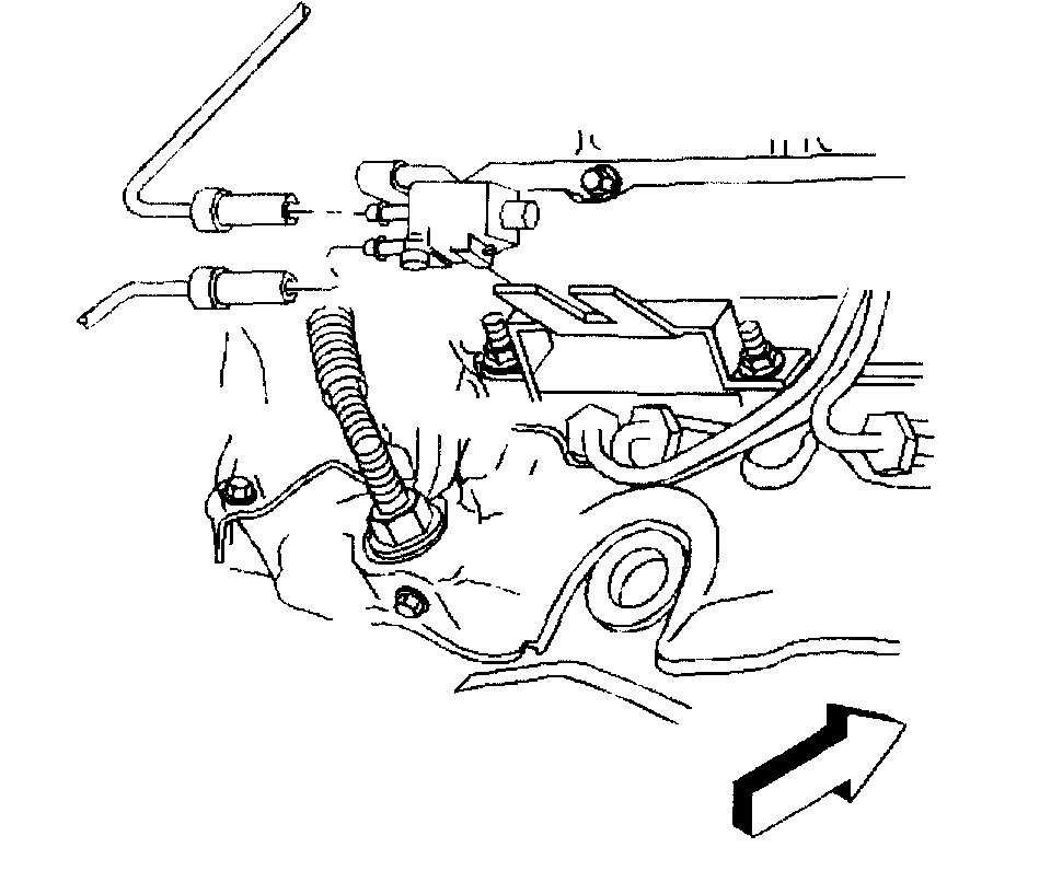

5. Remove the brake vacuum pipe at the plenum.
pic 1

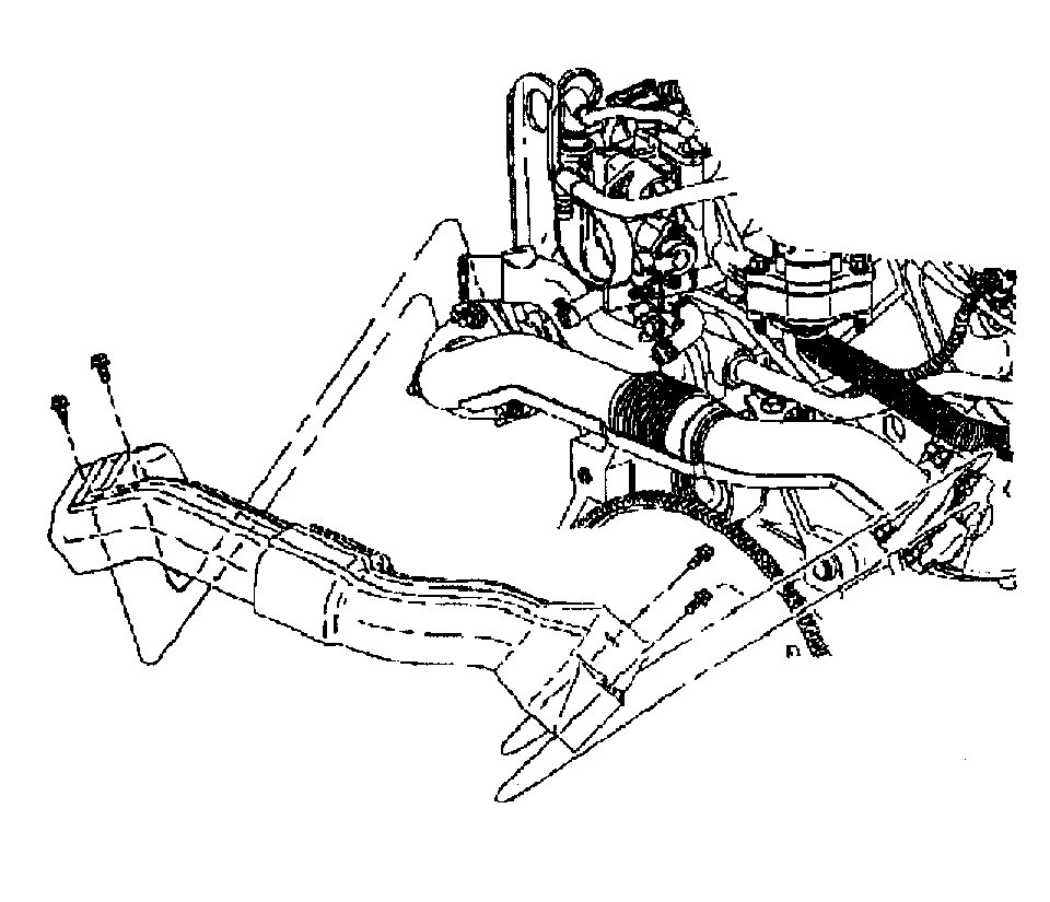

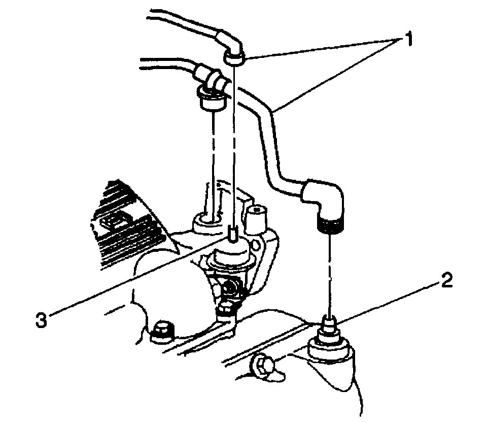

6. Disconnect the fuel pressure regulator vacuum hose (1) from the fuel pressure regulator (3) and the PCV valve (2).
pic 2

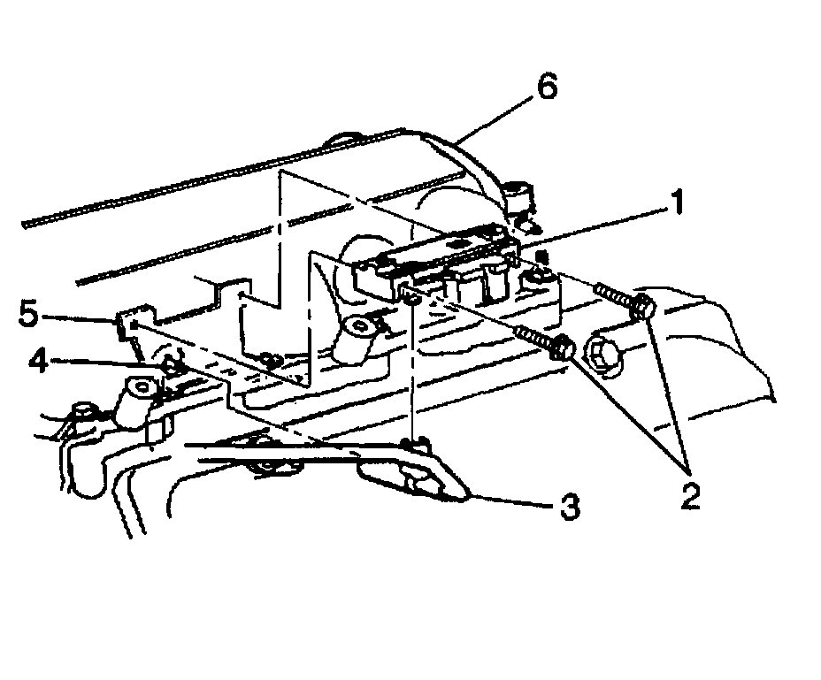

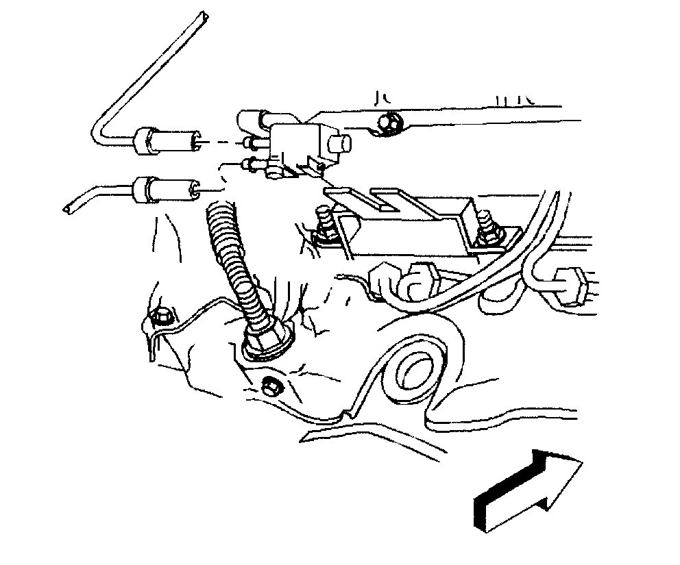

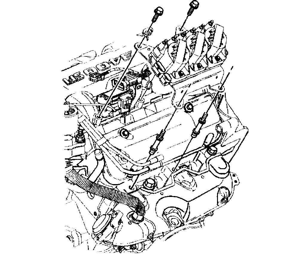

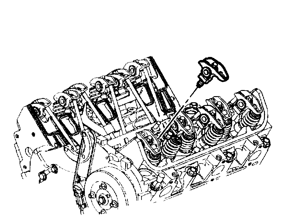

7. Remove the electronic ignition coil and module assembly.
pic 3

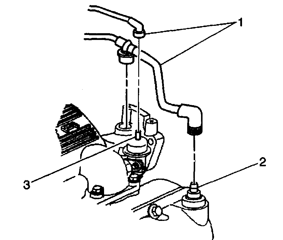

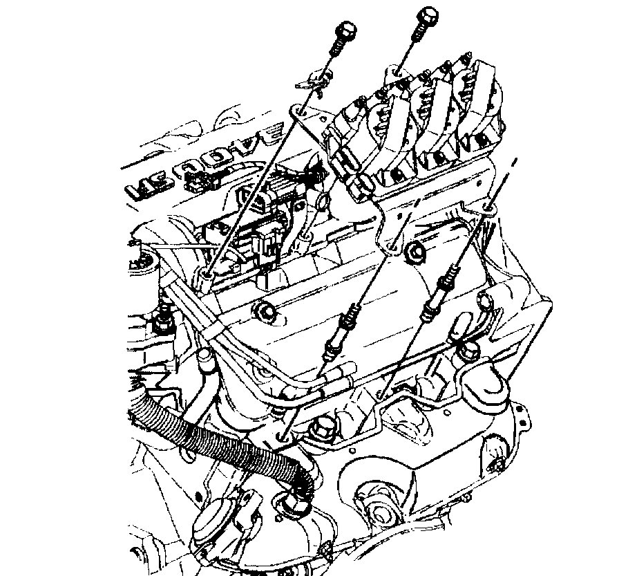

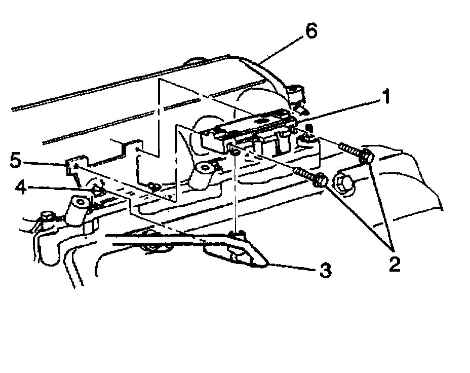

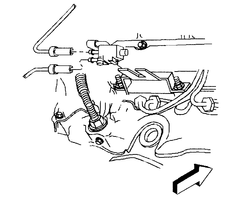

8. Remove Evaporative Emissions (EVAP) canister purge solenoid.
pic 4

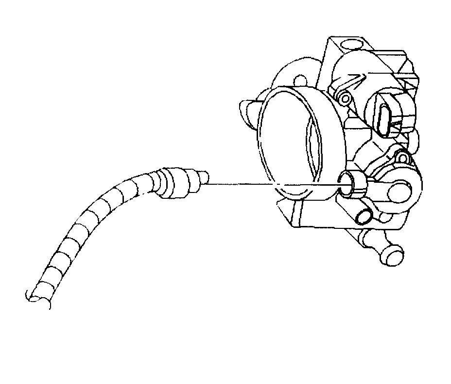

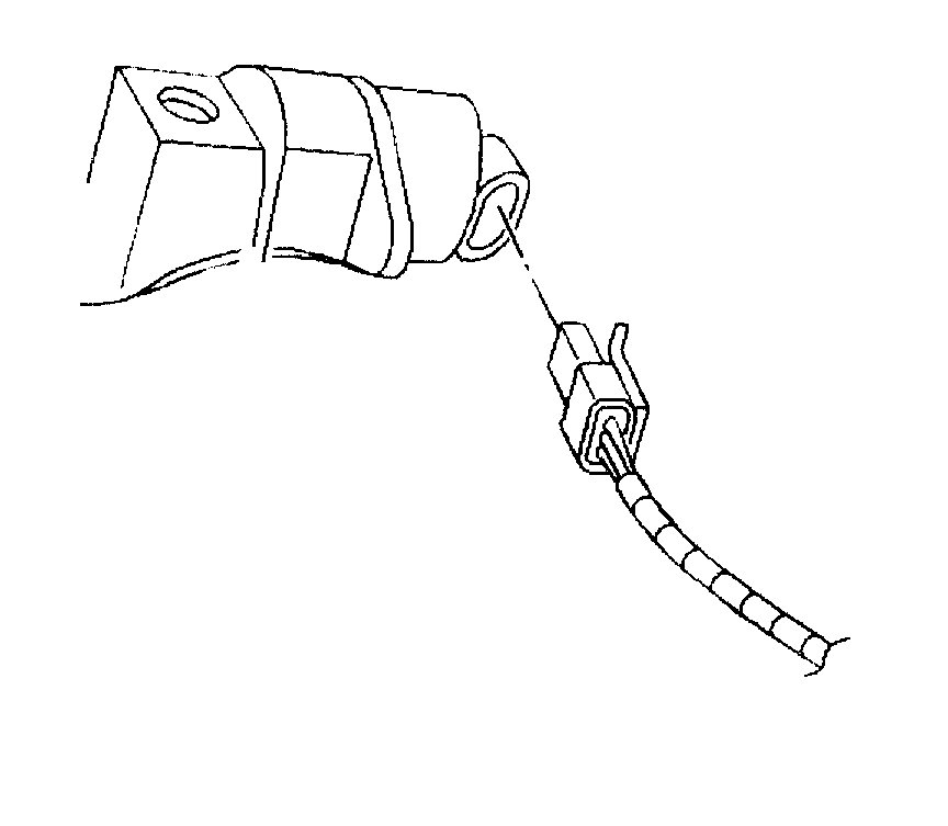

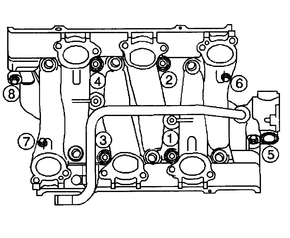

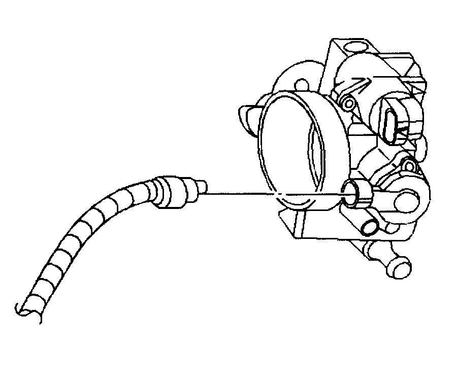

9. Disconnect the Throttle Position (TP) sensor.
pic 5

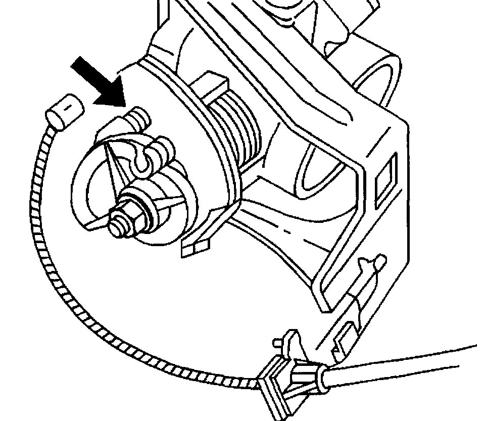

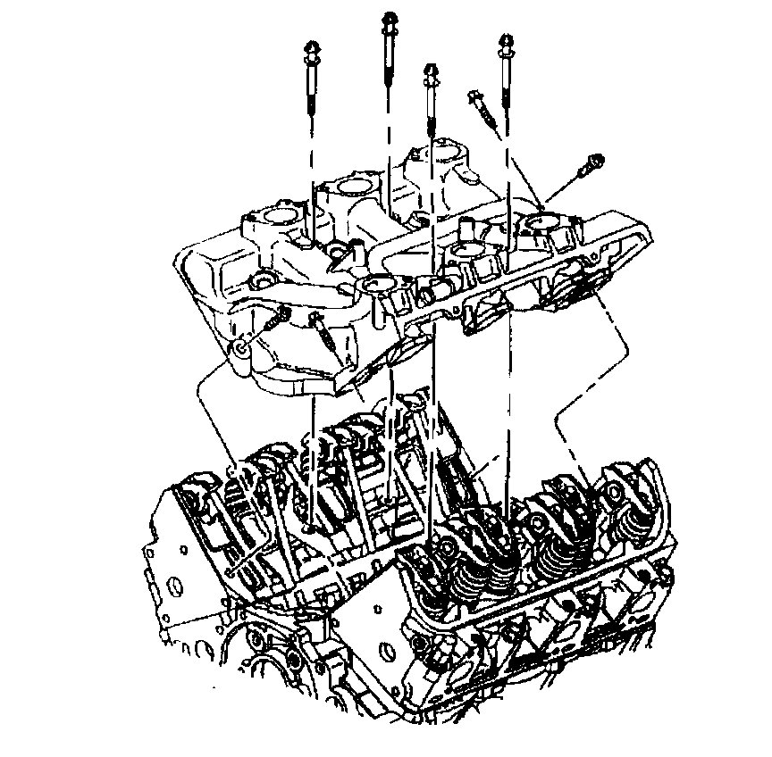

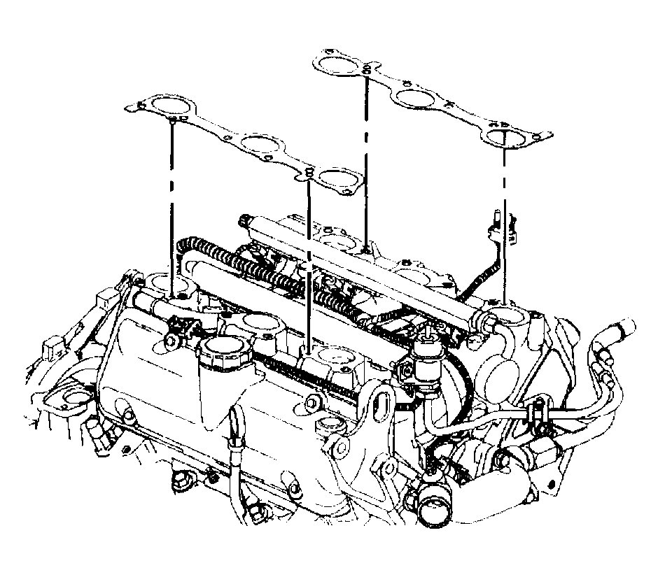

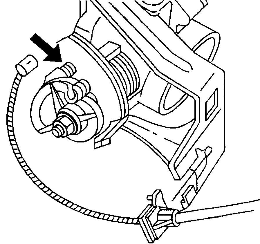

10. Remove throttle cable bracket with cables.
pic 6

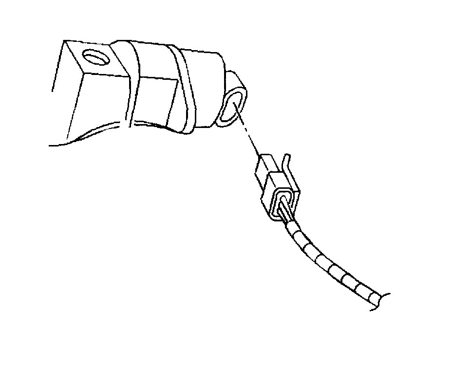

11. Disconnect the Idle Air Control (IAC) sensor.
12. Disconnect the Injector harness.

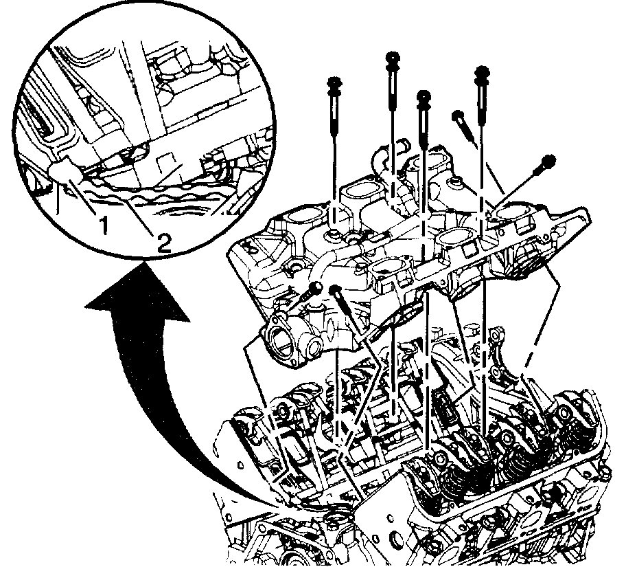

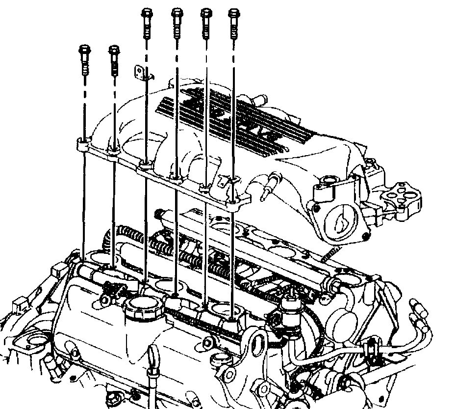

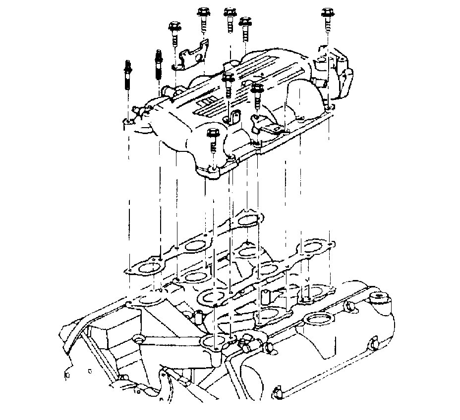

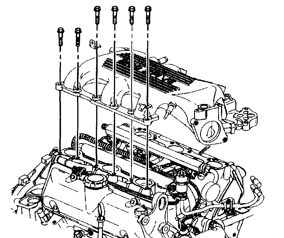

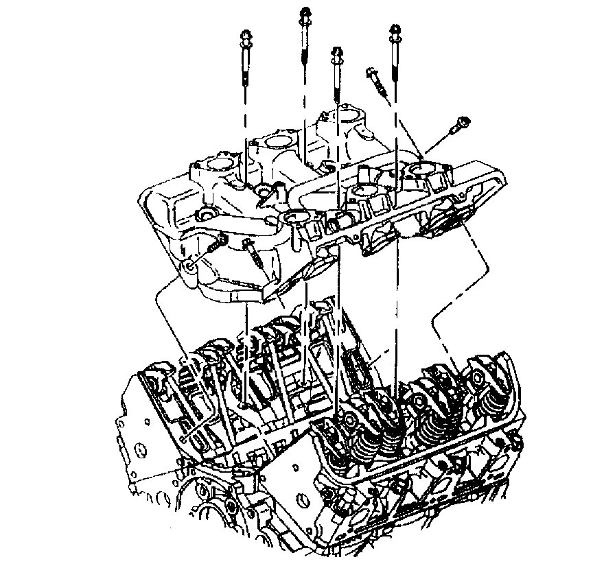

18. Remove the upper intake manifold bolts
pic 9
19. Remove the upper intake manifold and gaskets.
20. Clean the gasket surfaces.

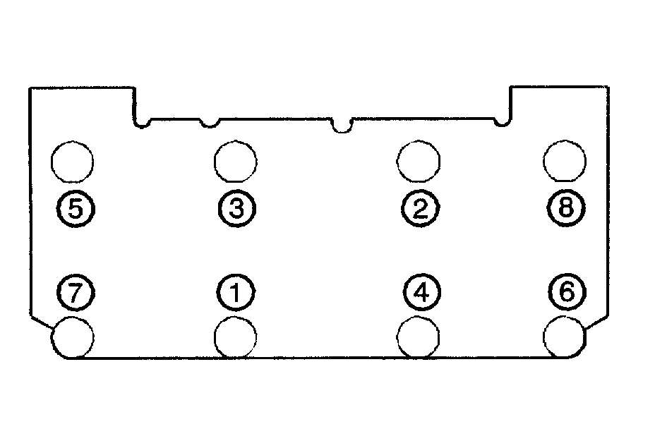

2. Apply thread lock GM PN 12345382 to the threads of the bolts. Install the upper intake manifold bolts.
^ Tighten the bolts to 25 Nm (18 ft. lbs.).

13. Install the electronic ignition coil and module assembly.

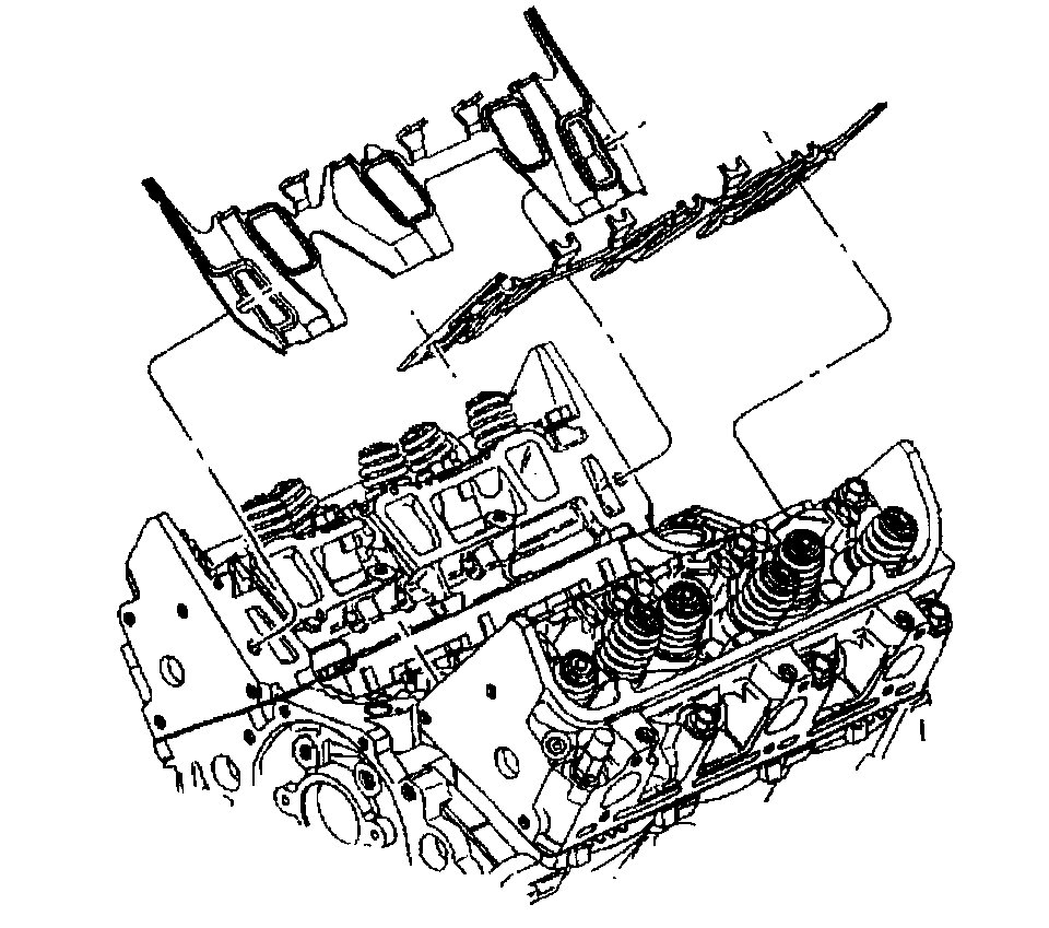

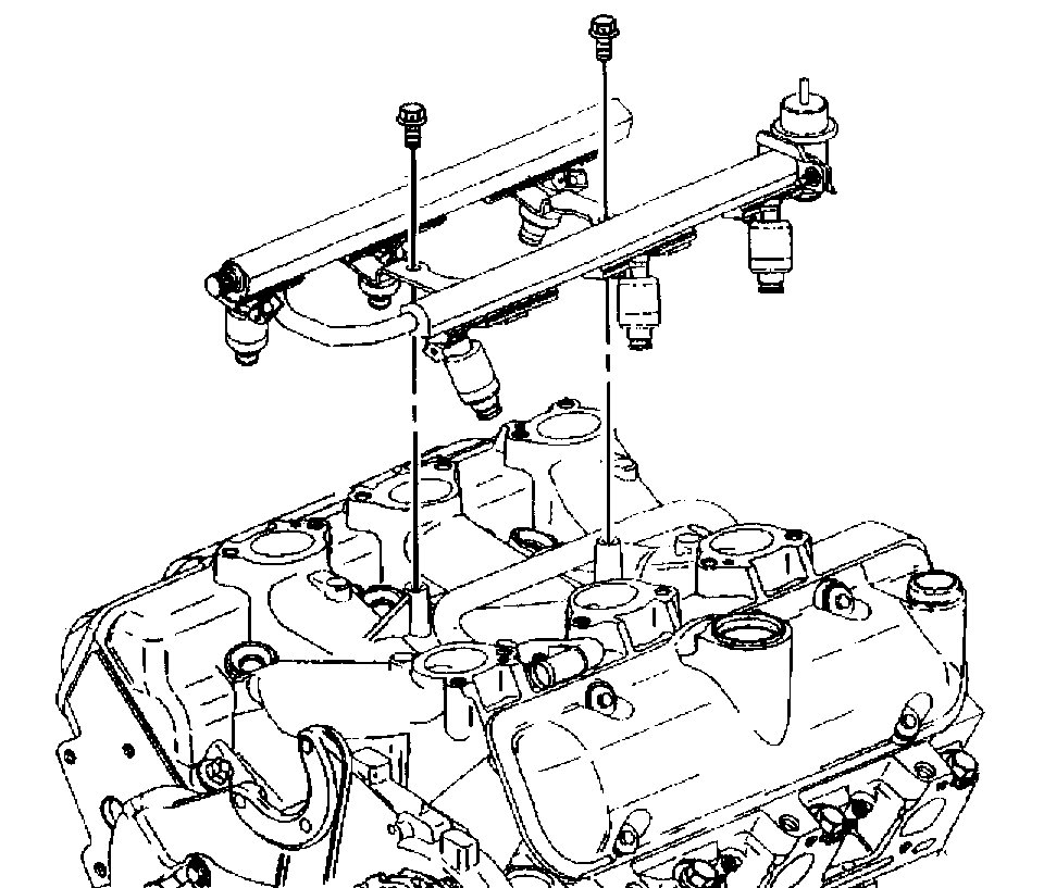

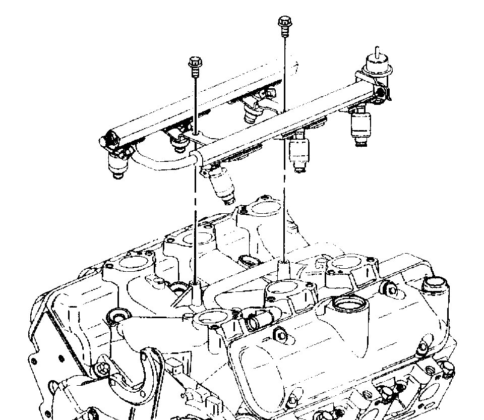

3. Remove the fuel rail with injectors and position aside.
4. Disconnect ECT.
5. Remove the power steering mounting bolts. Position the pump aside.

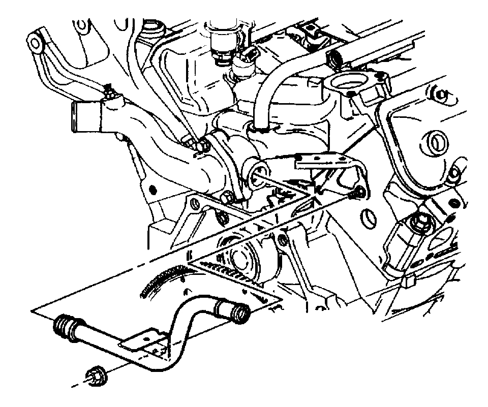

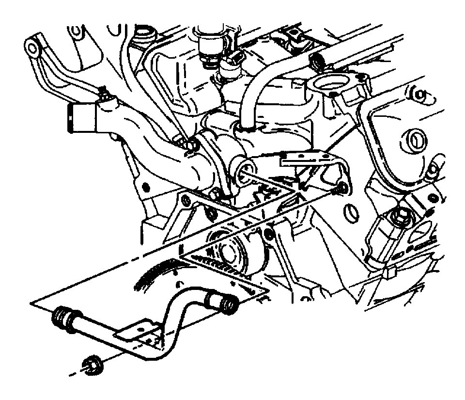

6. Remove the inlet cooling pipe from the coolant outlet housing..
7. Remove the heater by-pass at the coolant pump and the cylinder head.

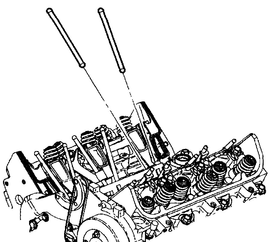

11. Loosen the rocker arms.
pic 23

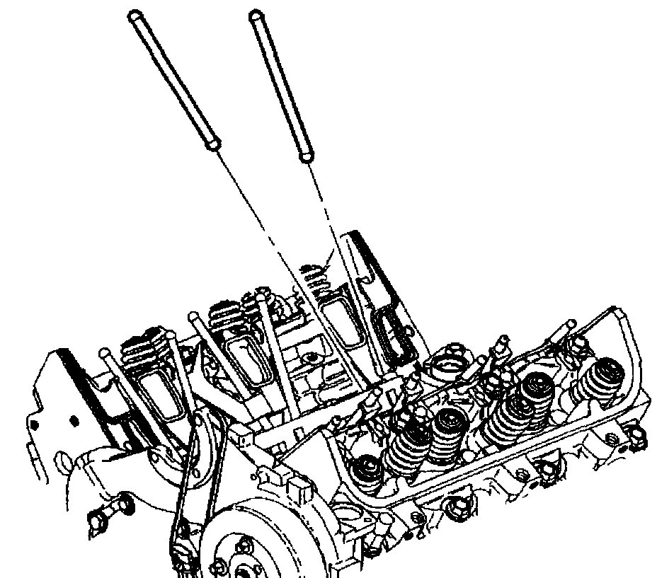

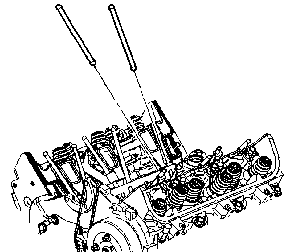

Important: Keep the pushrods in order. The pushrods must be installed in the original position.
12. Remove the pushrods.

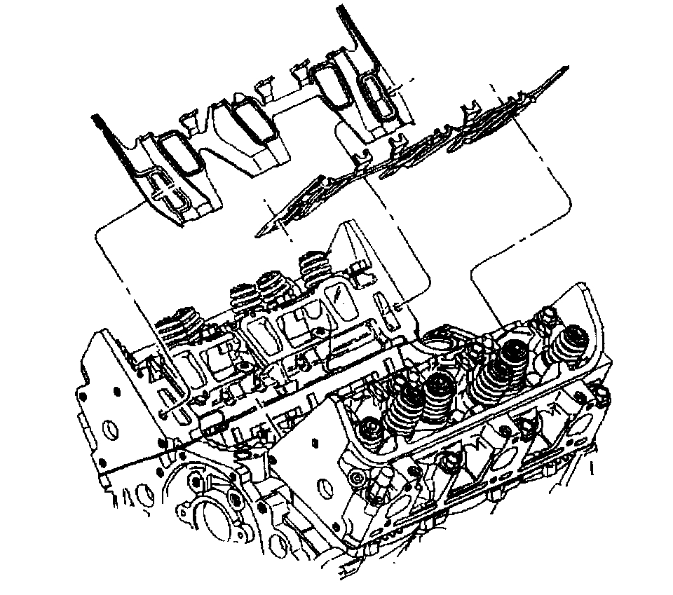

2. Install the intake manifold gasket.

12. Install the fuel rail with injectors.

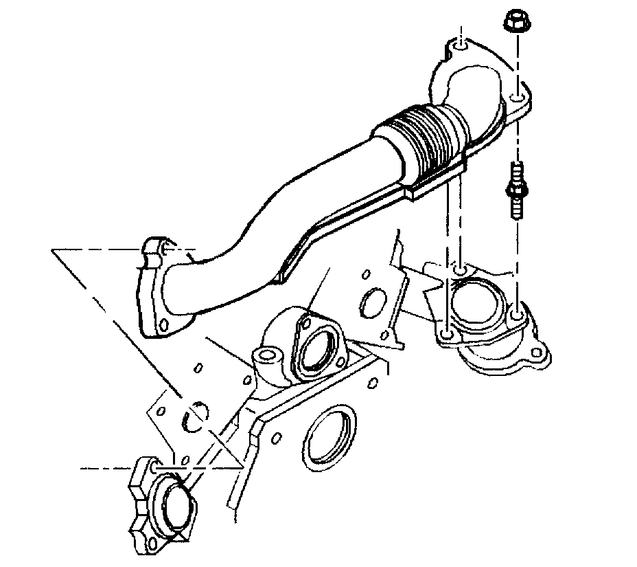

2. Remove the exhaust crossover.

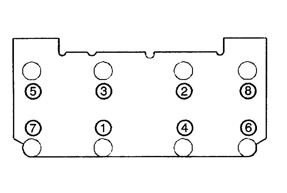

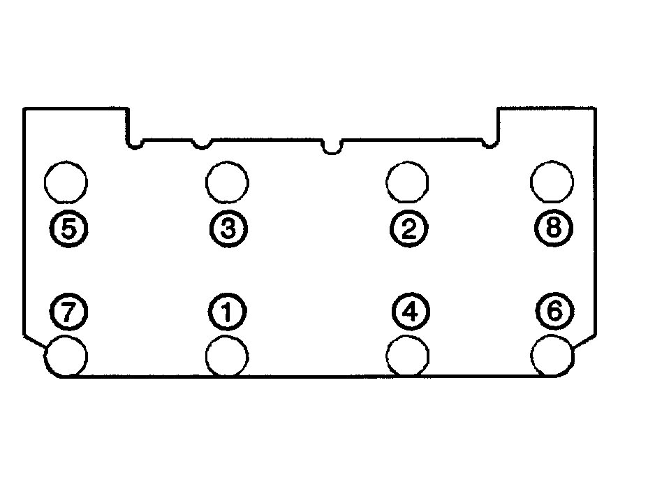

2. Place the cylinder head gasket into position over the dowel pins. Ensure that the THIS SIDE UP note is showing.
3. Install the cylinder head.
Notice: Refer to Fastener Notice in Service Precautions.
pic 35

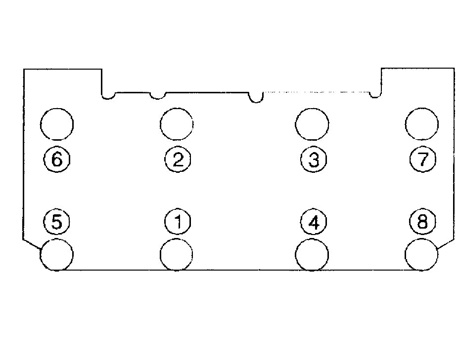

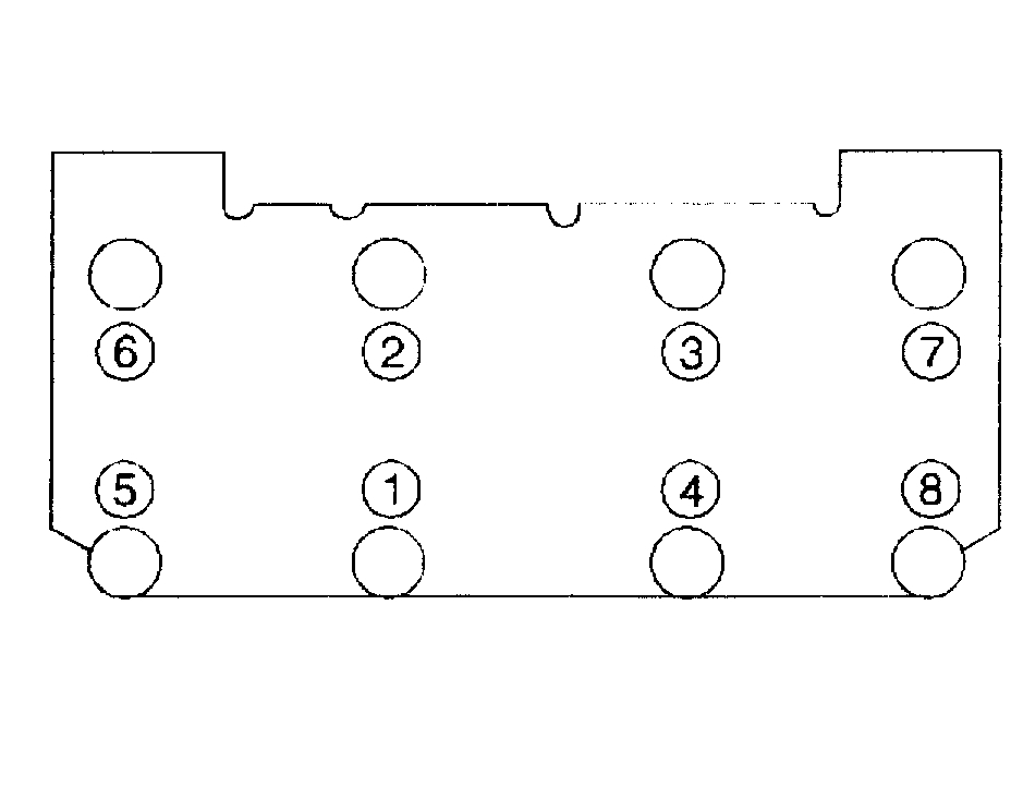

4. Install the cylinder head bolts.
^ Tighten the bolts to 60 Nm (44 ft. lbs.) in the sequence shown. Use the J 36660-A in order to tighten the bolts an additional 95°.

7. Install the crossover pipe.
