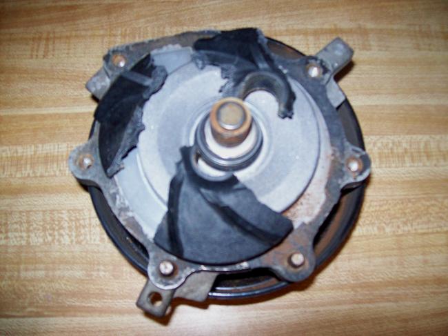

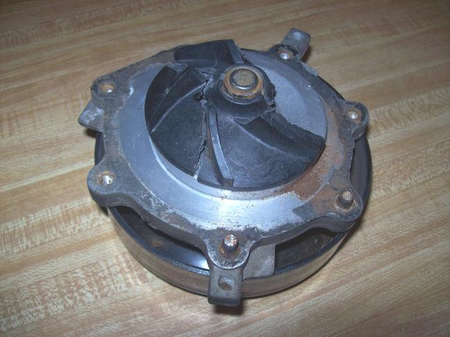

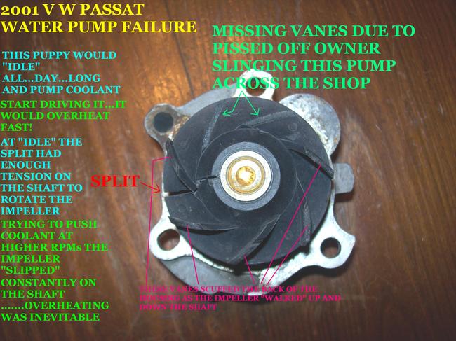

i just looked up a water pump for a 3.4l...........it has the same characteristics as these........this too, could be a possibility!
click on each of my pics
1) plastic impellers...gotta love 'em!
2) ford taurus
3) ford taurus (same one as above)....missing a piece........magic?....where could it have gone?

It is a possibility the water pump impeler(s) is damaged causing low coolant flow when the demand is needed such as at higher engine speeds but is difficult to tell without removing the water pump. These water pumps can come in plastic or metal impellers as mention above.
