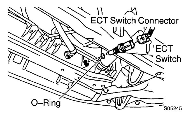

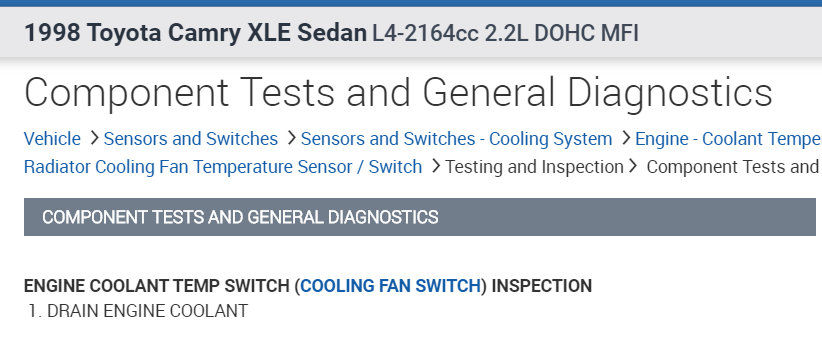

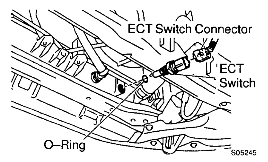

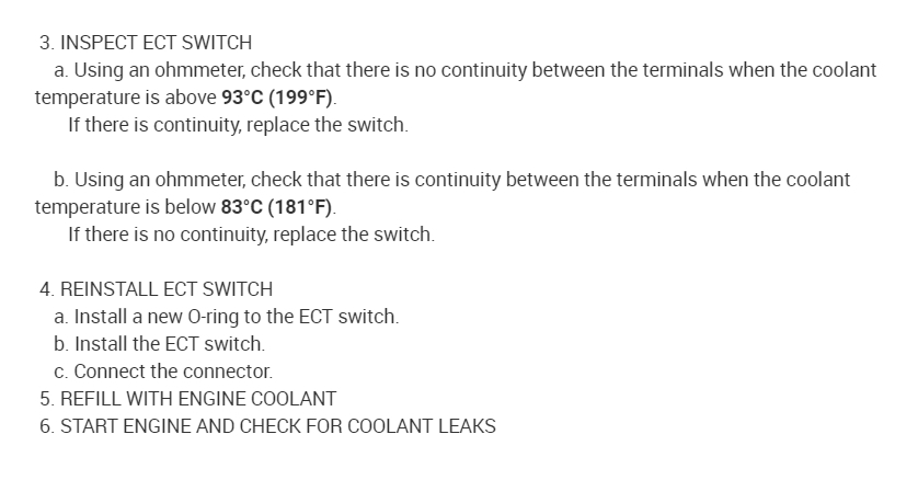

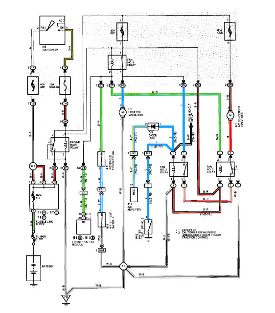

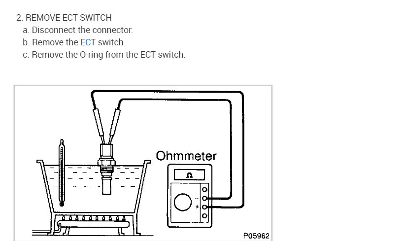

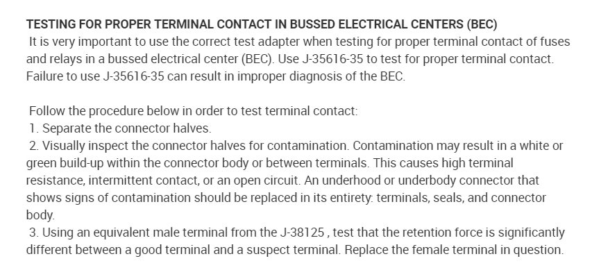

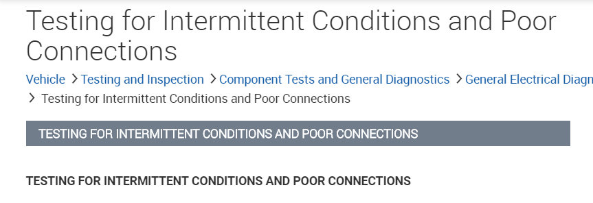

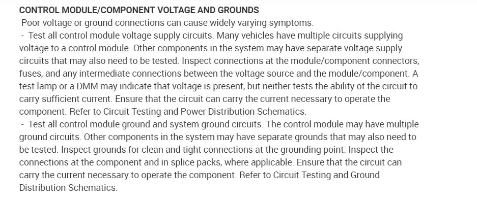

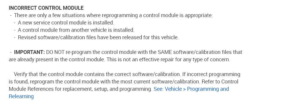

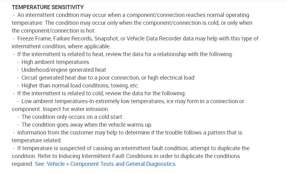

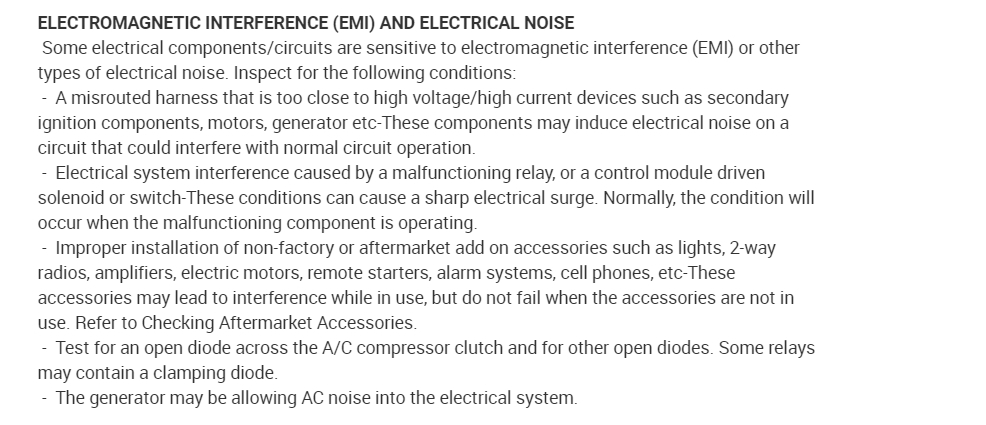

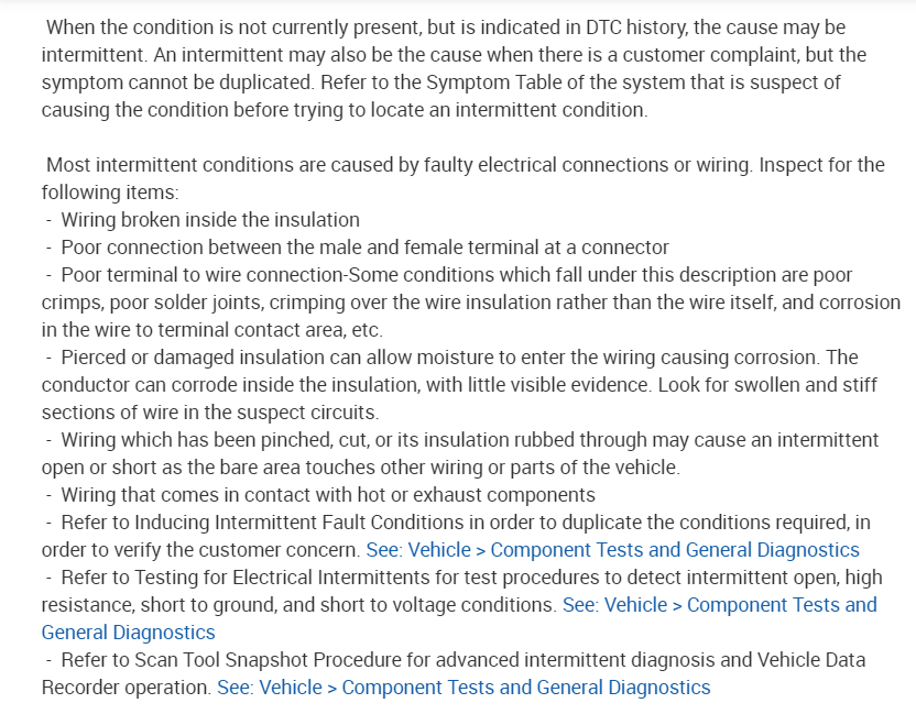

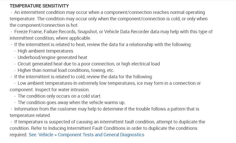

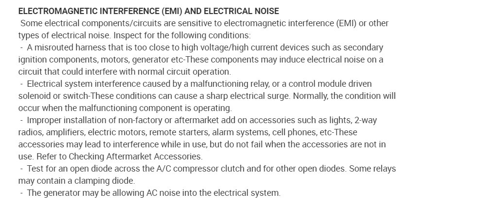

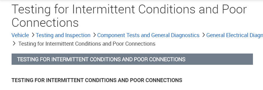

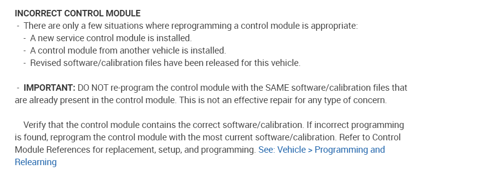

I hate to say this but this could be a problem with your vehicle's cooling fan sensor, or, a problem with the wiring that goes to the sensor. In the diagrams down below I have included then vehicle manufacturers guide for troubleshooting the cooling fan sensor. I have also included a wiring diagram of your vehicle's cooling system as well as a guide for finding intermittent electrical problems and poor electrical connectors. Please go through these guides and get back to us with how everything turns out.
