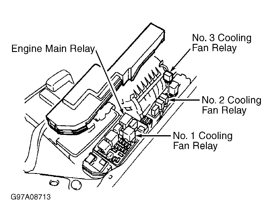

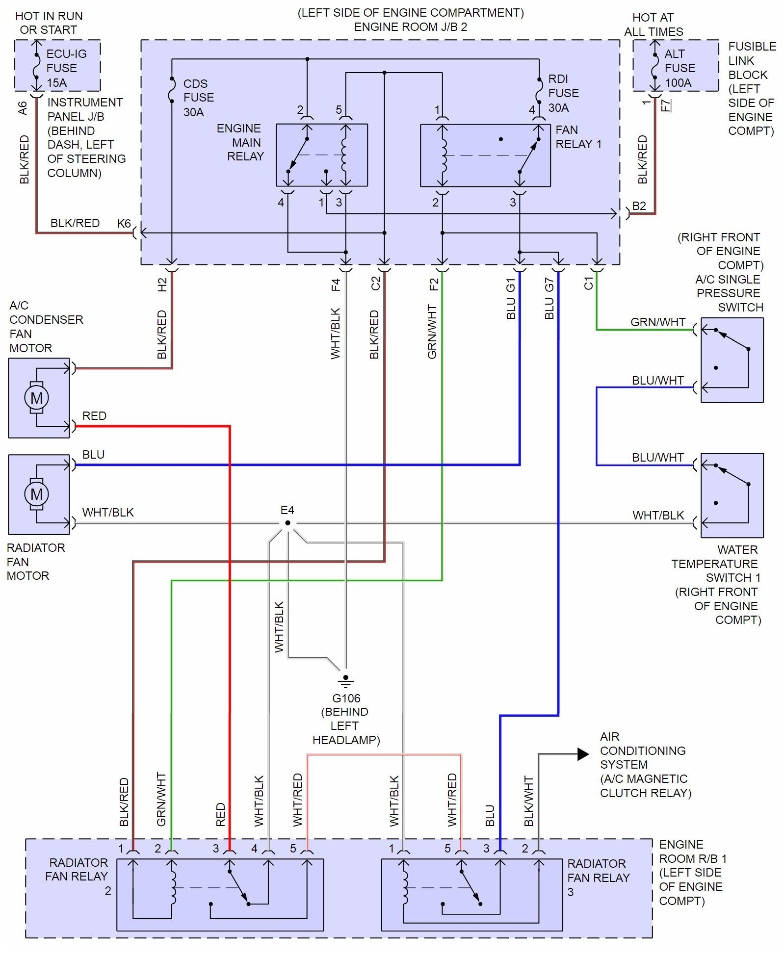

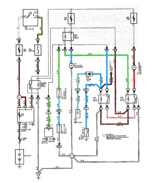

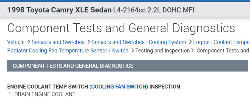

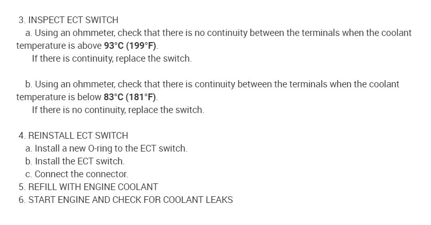

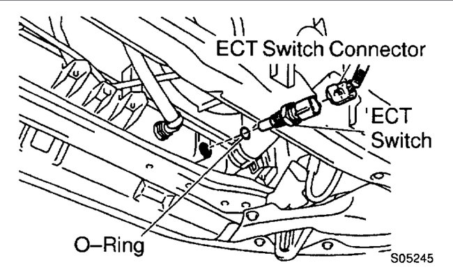

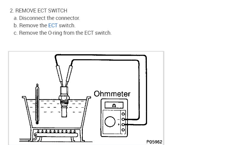

DAVE HORN
Gauge shows car will get hot and almost overheat when parked and running. Fans come on when almost at red line. Fans come on with A/C and when unplugged. Radiator is new. No air. I have replaced the sensor on the radiator 3 times with same symptoms. I disconnected the battery to recent the ECU and replaced good ECU fuse. Symptoms same.
Seemingly unrelated issues - fast idle has not worked for years. It isles fine when warm. I don’t care about that if there are no additional issues with it.
Also, both cigarette lighters stopped working. Replaced (good) fuse and they still don’t work.
I’d love to keep this thing running forever... My local mechanics seem more lost than me...
Jan 25, 2021 at 2:42 AM (Merged)

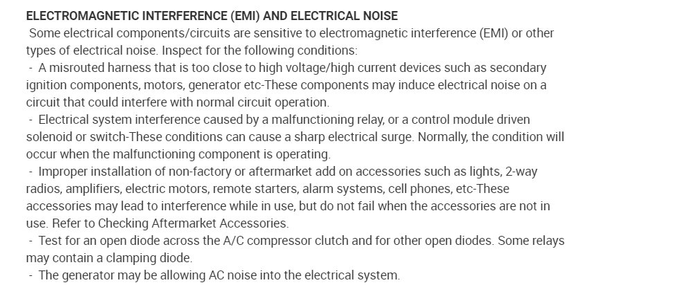

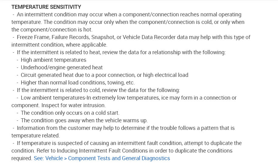

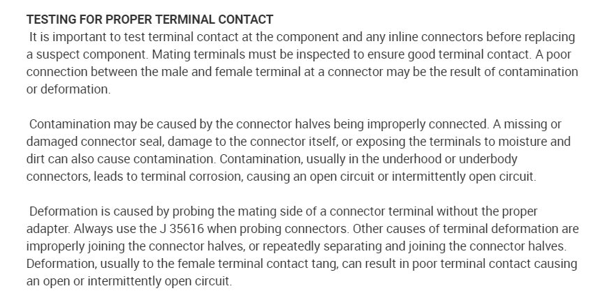

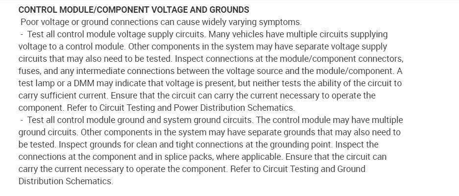

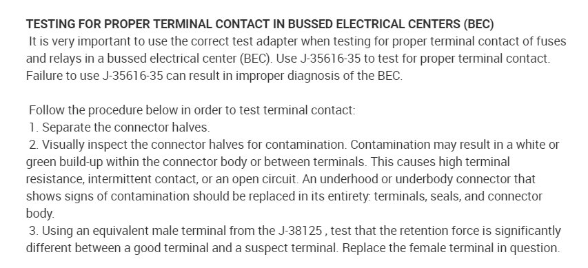

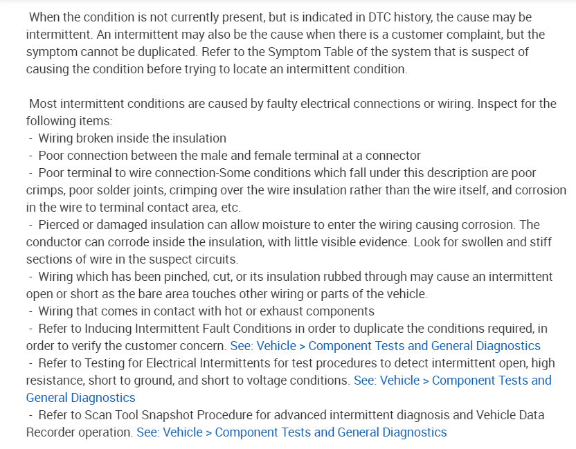

SCGRANTURISMO
  • 4,897 POSTS
I hate to say this but this could be a problem with your vehicle's cooling fan sensor, or, a problem with the wiring that goes to the sensor. In the diagrams down below I have included then vehicle manufacturers guide for troubleshooting the cooling fan sensor. I have also included a wiring diagram of your vehicle's cooling system as well as a guide for finding intermittent electrical problems and poor electrical connectors. Please go through these guides and get back to us with how everything turns out.
