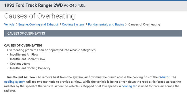

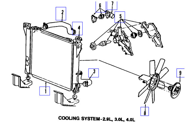

After about 20 minutes of running the temperature gauge rises eventually overheating. Steam and antifreeze will shoot from the radiator as well as reservoir. There is also a significant loss of power during overheating as well as a loud knocking sound. I have replaced the water pump,fuel cap,hoses, thermostat, flushed the radiator and disconnected the hose to the heater core and bypassed it thinking if it was a bad heater core then bypassing it would work but it didn't. I have not noticed any leak under the radiator that is clearly visible to get my attention.
Jul 7, 2019 at 4:22 AM
SCGRANTURISMO
  • 4,897 POSTS

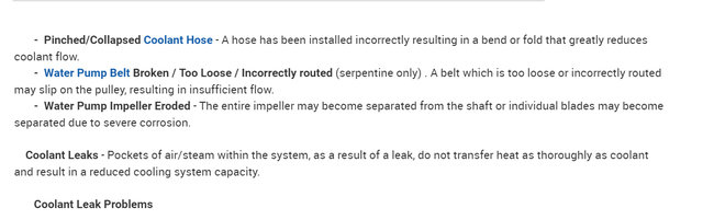

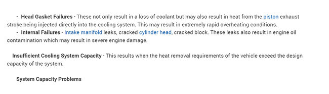

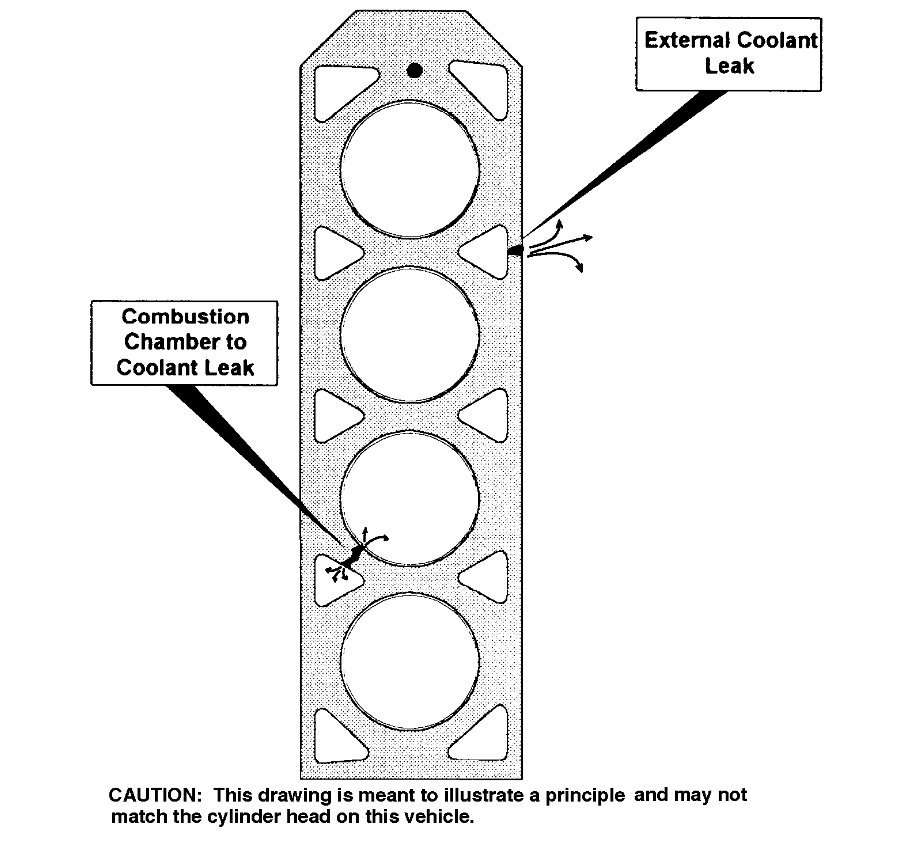

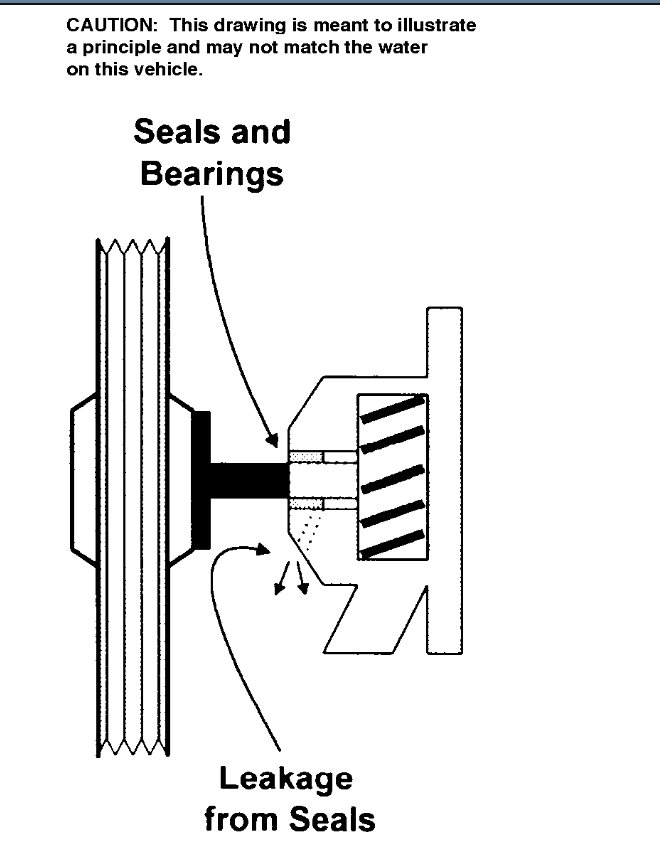

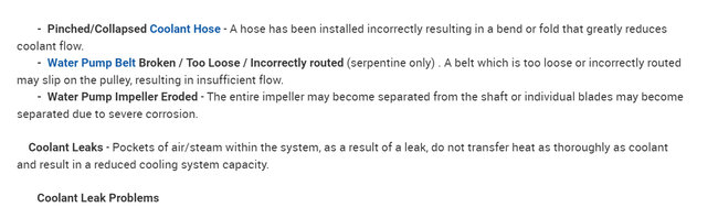

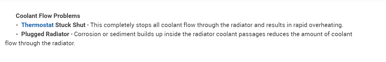

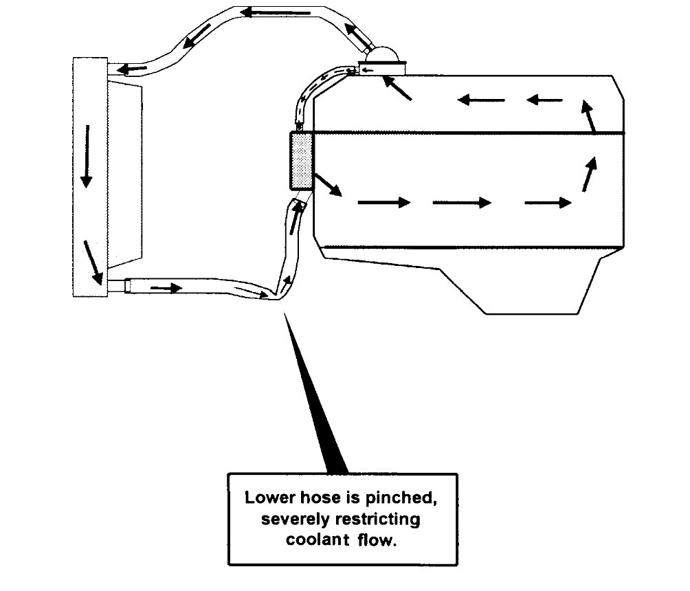

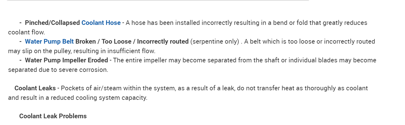

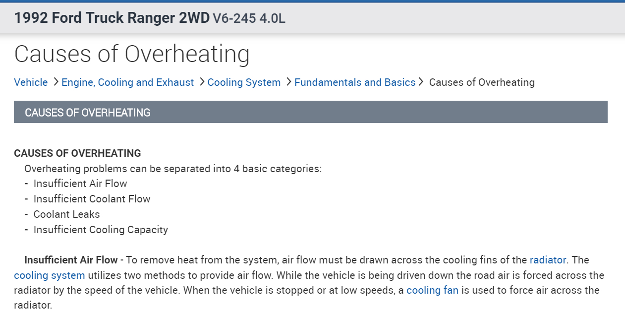

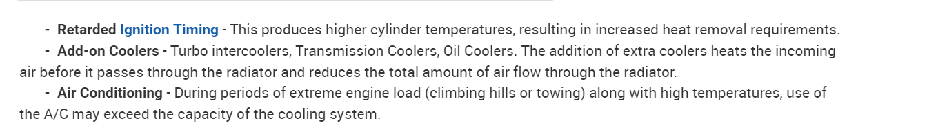

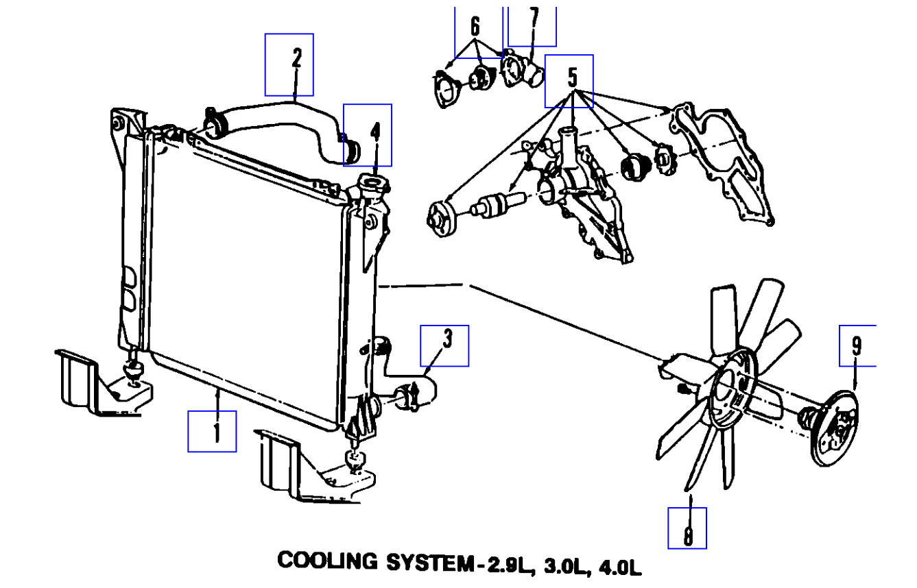

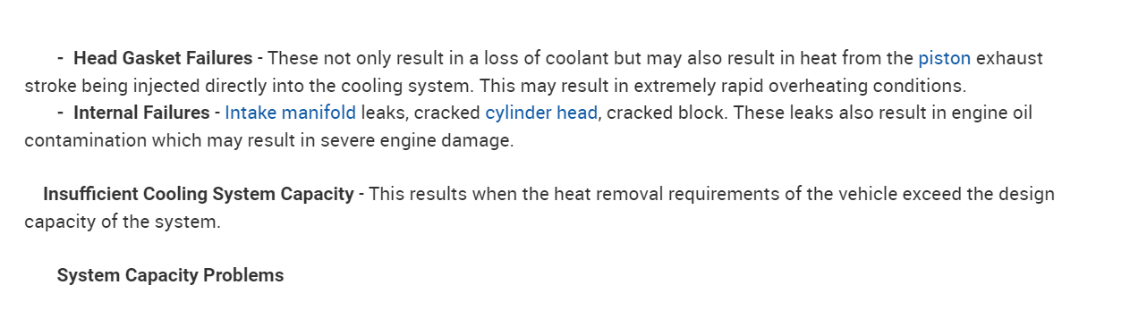

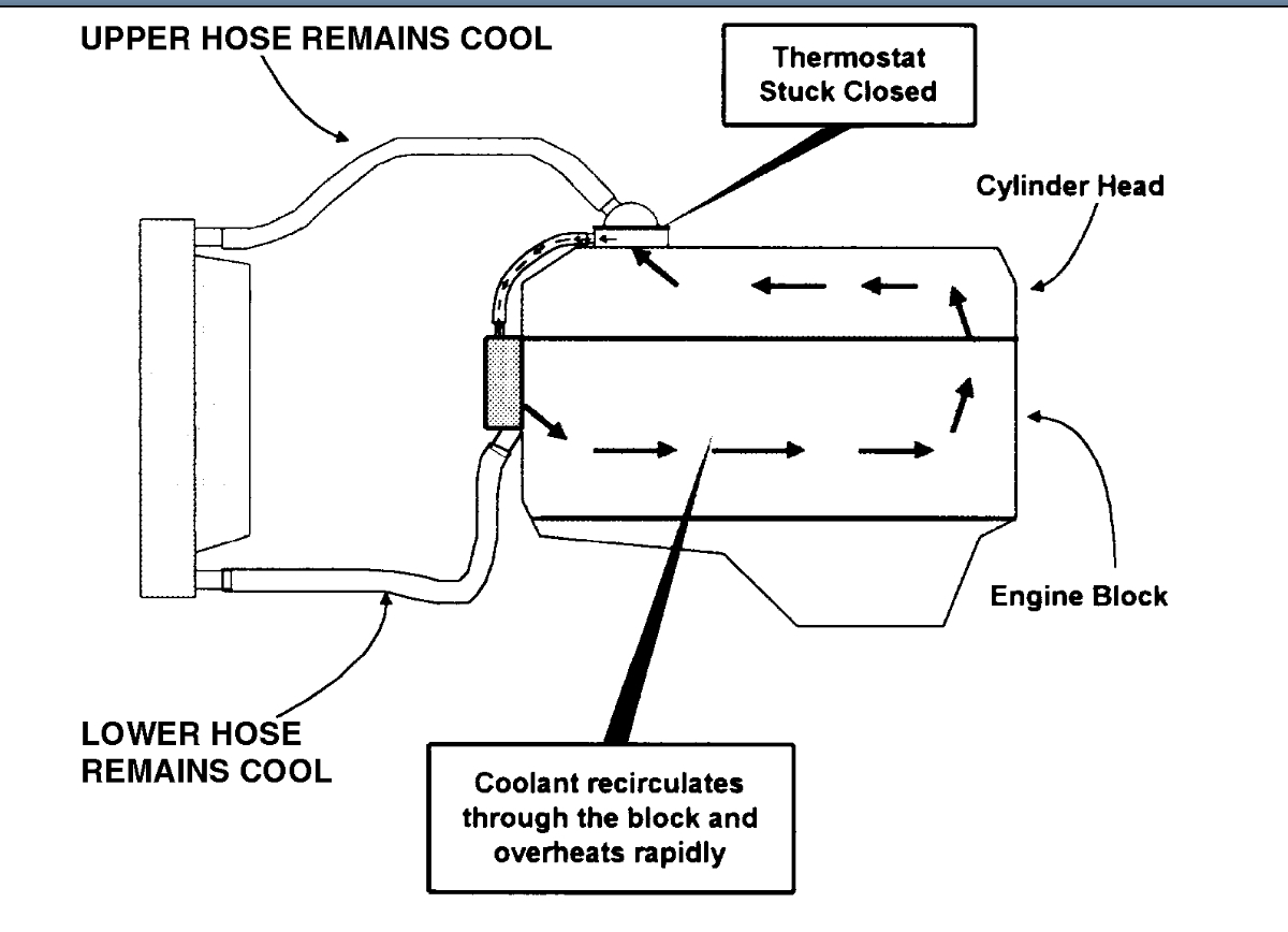

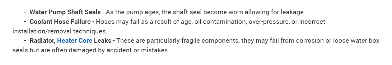

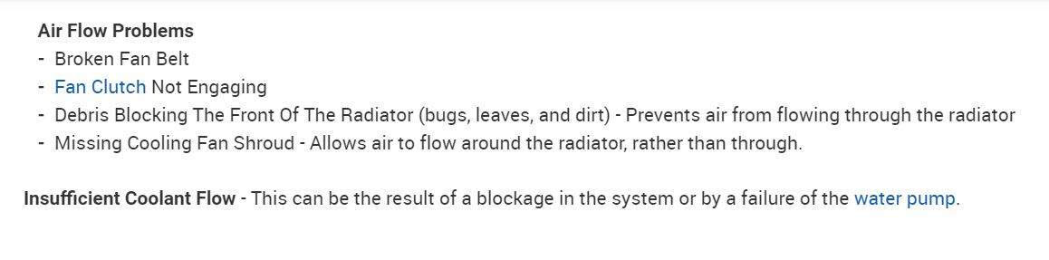

You have got a restriction in the cooling system somewhere. Double check all the hoses and ensure that water or coolant can flow through your vehicle's radiator. Also double check that your thermostat is opening when it is supposed to. In the diagrams down below I have included an exploded diagram of your cooling system as well as a guide for why your vehicle could be overheating. The knocking in the engine is something that might be a concern, as you could have bearing damage from your engine being overheated, but we can address that after we figure out why it is overheating. Please go through the guides and get back to us with what you are able to find out.
