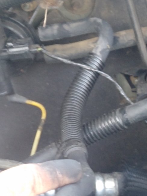

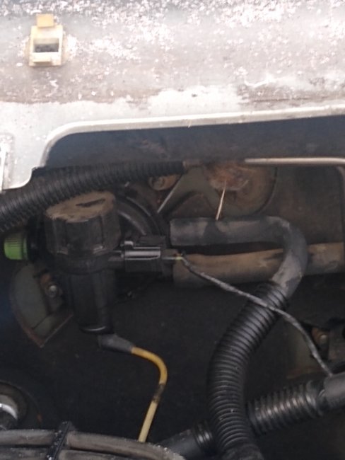

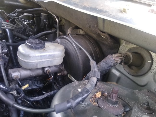

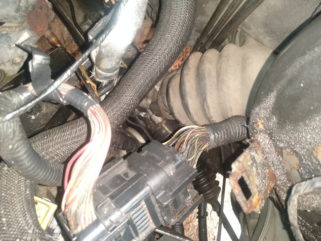

What is this hose for because I just realized it was not connected?
Aug 22, 2020 at 1:23 AM
4DRTOM
  • 467 POSTS
Oh boy, that's not good you are going to have to take a good look at that. Yes that absolutely could be part of the problem, it caught on fire? For that to happen there must be oil that has leaked out to catch it probably got onto your catalytic converter. How did you put it out? Your going to have to look under there and see what burnt. Was it oil or dry grass up there. That's dangerous can you send a pic of under there?
Which one in the picture wasn't connected? I believe that's part of the evap system. How is the transmission fluid level? Have you checked it yet?

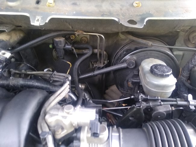

Here is the photo of where it was removed from:
Aug 22, 2020 at 1:53 AM
4DRTOM
  • 467 POSTS
Okay, the fluid level is good? What caught on fire then if it wasn't oil leaking can you tell? The hose probably not but hooked it back up and see what happens. You are going to need to get a scan on the system ans see what code it has in there. That will guide us to the issue.

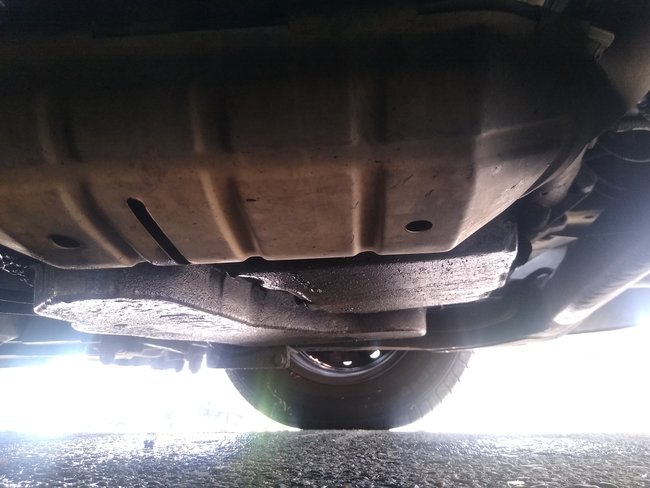

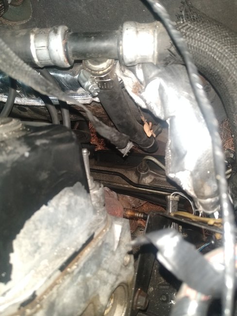

This is what caught fire:
Aug 22, 2020 at 6:47 AM
4DRTOM
  • 467 POSTS
Good morning,
Okay, that is the catalytic converter and it gets super hot. I don't see oil on it so that's good. I do see oiliness on the bottom of the pan beyond it. You should be good to run it to check the transmission fluid level and to get codes out of it.

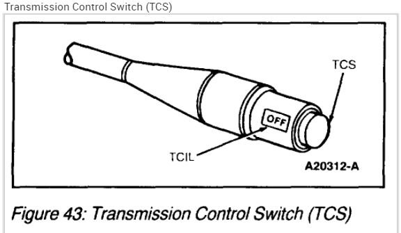

The Transmission Control Switch (TCS) (Figure 43) signals the PCM with key power whenever the TCS is pressed. On vehicles with this feature, the Transmission Control Indicator Lamp (TCIL) lights when the TCS is cycled to disengage overdrive. The operator of the vehicle controls the position of the TCS. I believe flashing means its not disengaging.
You should go for a drive and verify the O/D is in fact working. When the overdrive isn't on when your on the highway and you let you foot off the gas pedal you will slow down with the engines rpm's. If its on and working then you will get more of a coasting feeling and the speed of the car wont go down as fast. The switch on the arm might be bad or the wires leading to it may be it. Do you have a tilt steering wheel that you use a lot? Wires at the bend spot after a while tend to weaken from the movement at it pivot point and eventually open the circuit.

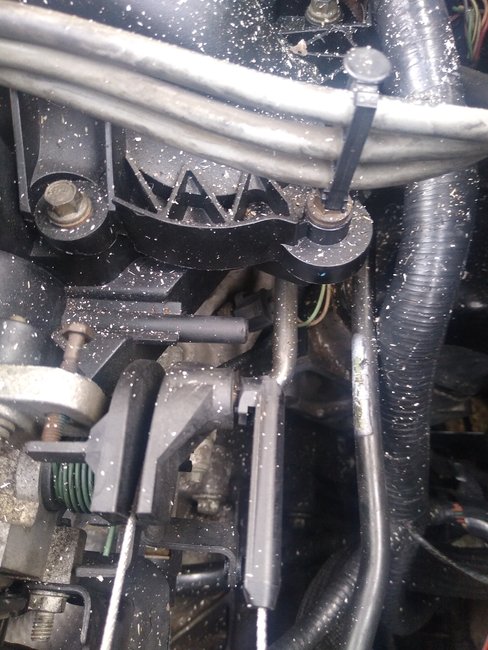

Yeah, no problem. okay basically the code that showed up was PO750 also known as the shift solenoid A and engine wiring harness check.
Aug 25, 2020 at 3:36 PM
4DRTOM
  • 467 POSTS
Okay.
Yes, that's for the shift solenoid A.

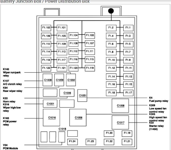

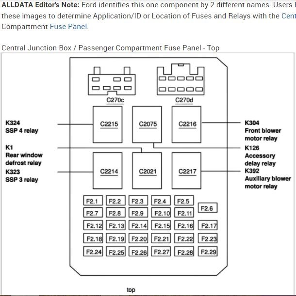

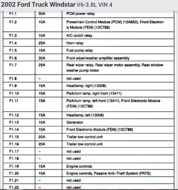

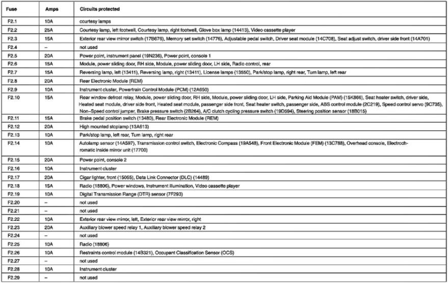

Check all power and grounds at the PCM. Check under hood fuse #8 being blown or missing and Inspect connector C213 for corrosion this connection is in the left side of the foot well inside the car. Look under the battery for harness connections as well.
Here are the two fuse block diagrams and legends. As a matter of habit I always check all the fuses with a test light, I recommend doing that with the car on and everything on as well, ie, headlights, heater fan, radio, etc.

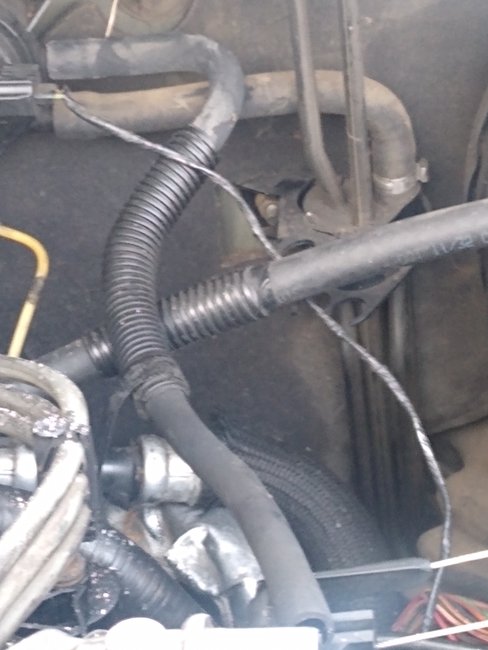

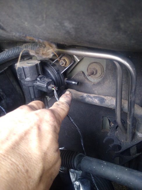

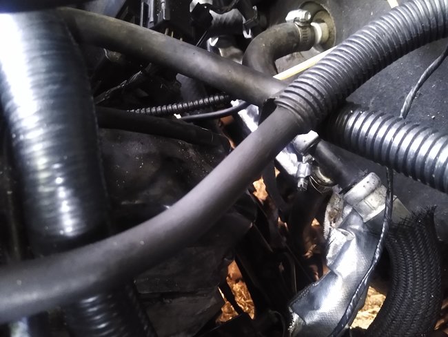

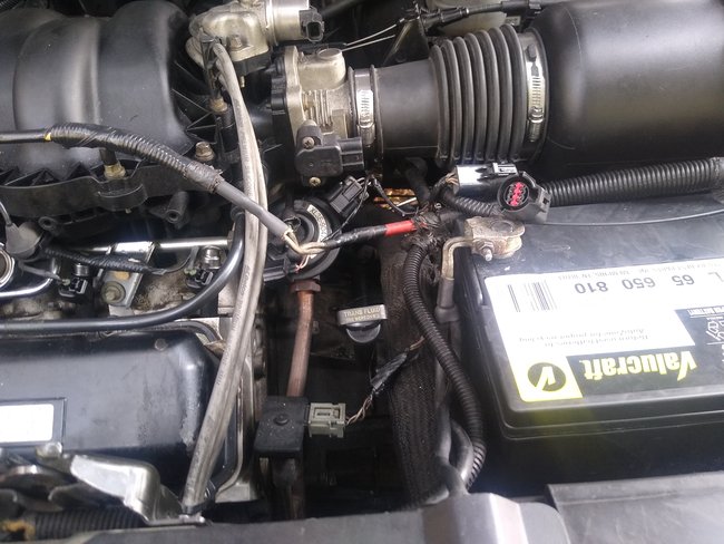

Problem still persists after checking all the wires no loose or unplugged wires, all looks fine. I have uploaded a series of pictures I took maybe this will help and again I really appreciate all your help so far.
Aug 26, 2020 at 8:03 AM
DANIEL NELSON2
  • 44 POSTS
Here are said photos.

Sorry about that. here are the said pictures:
Aug 26, 2020 at 10:56 AM
4DRTOM
  • 467 POSTS
Were you able to get at the plugs that run into the transmission? I've been thinking about this fire and the flashing light. The range selector is located on the side of the transmission near the fire spot. I bet it's the issue. It's an easy change out but catch me up on what's happening now. You have the light flashing but the car is going into gear and able to drive. i didn't see a reply about the over drive test i asked about.
Tom
Aug 26, 2020 at 1:34 PM
DANIEL NELSON2
  • 44 POSTS
Yeah, it's able to drive and everything.
Sep 1, 2020 at 9:24 AM
DANIEL NELSON2
  • 44 POSTS
If I can just figure out where that solenoid is I could probably fix it, but I have no idea where the I would find it.
