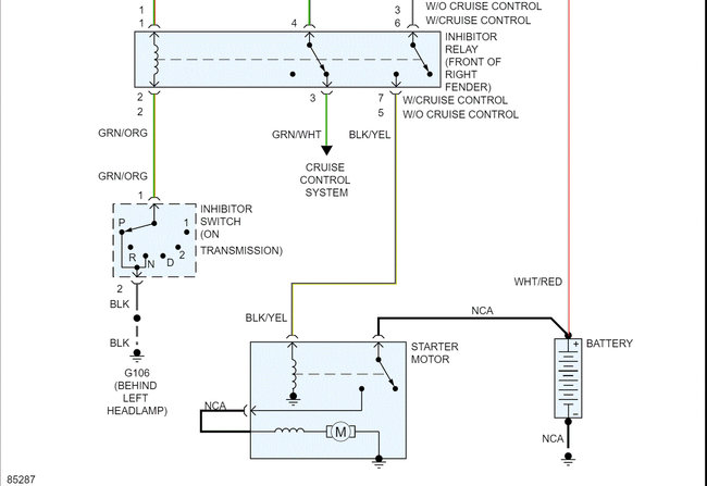

I recently replaced my harmonic balancer and also decided to replace my alternator for good measure since all of the other drive belt components have been going out. Anyway, once I got everything replaced and buttoned up, I got one click from the starter and nothing else. I had the battery disconnected the whole time I was working on the alternator, checked all the grounds, cleaned and checked battery terminals, checked all the fuses that are related to the engine, and checked the voltage of the battery which read 12.6V. Any idea what could be going on?

If you are getting one click from the starter, that sounds like something is loose and not making good contact. You indicated you checked the battery terminals. Are they tight? Is the main ground to the engine block tight?

Yes, I was able to locate 3 grounds, 2 located to the body and 1 located to the block and they were all tight. I also looked at the starter and the connections there seemed to be fine too.

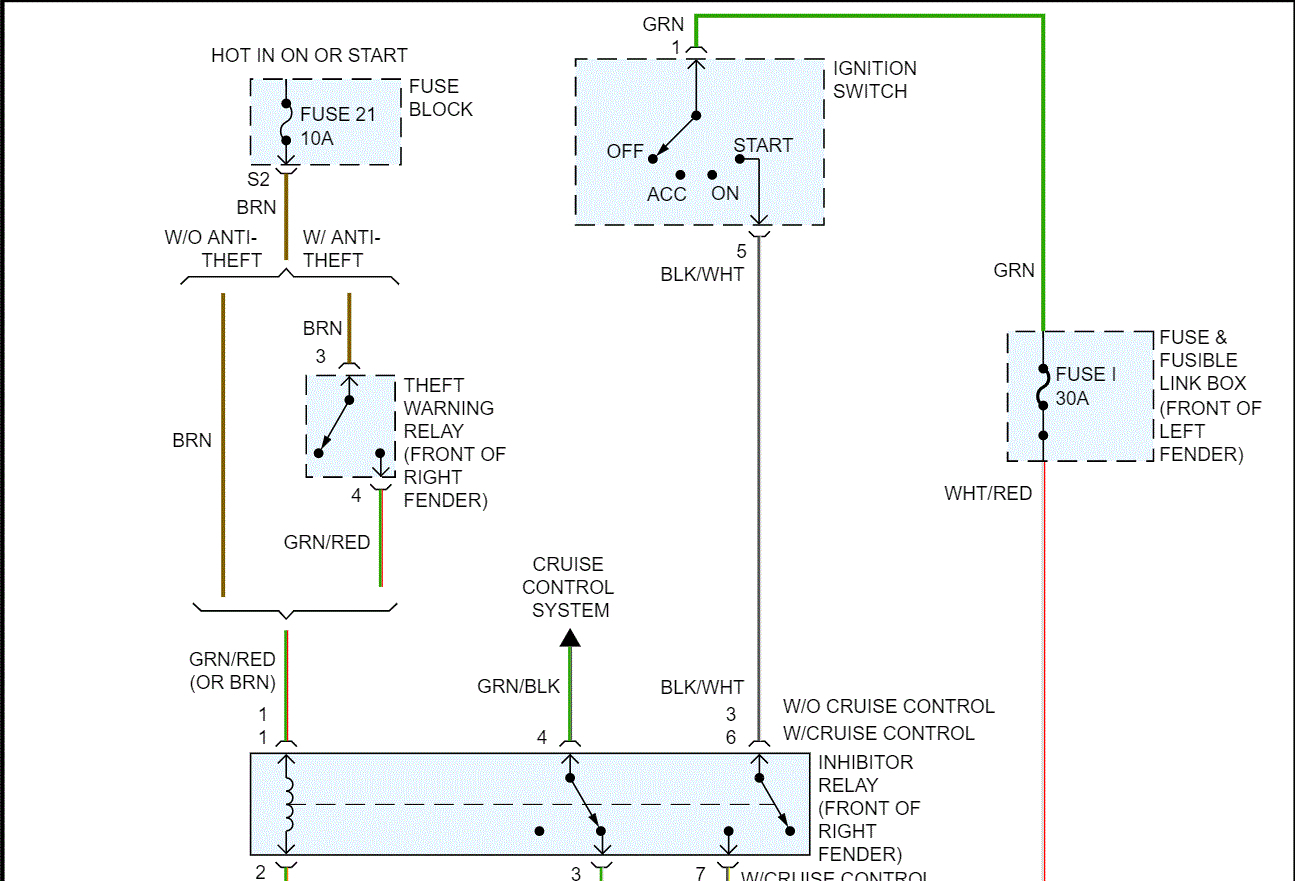

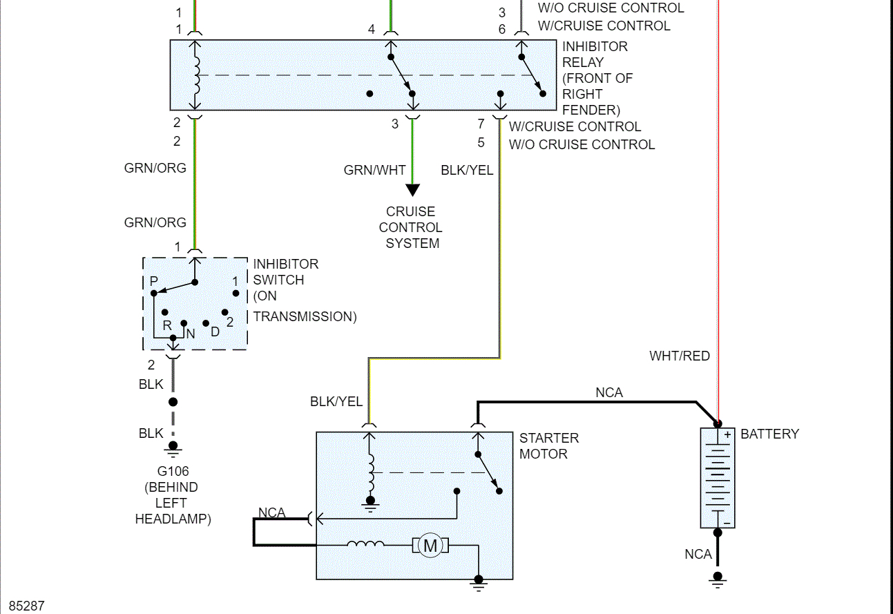

Cory, if there is power to it and good connections, then we have to check the starter itself. On the starter, there are two wires. The first is the heavy gauge one from the battery. It has 12v all the time. There is a smaller wire to the S terminal which only gets power when the key is in the start position. We need to confirm that is getting power.
Here is a link explaining how to check it:
Additionally, I attached the starting system schematic below. I thought it my help you. It shows fuses and relays related to the starting system. I had to break it into two so it is readable for you. I did overlap them so you can follow it.

Got the car back up and running. So before I checked the starter, it was suggested by a family member that I take my battery to AutoZone for a load test, I did and it was confirmed that I had a bad battery. Put it in and the car fired right up. I decided to take out the starter and get it checked too because, why not? I have been hearing grinding noises on cold starts the past few months anyway. The starter was still usable, but the clerk said it looked a little weak during testing. After seeing what I could of the flywheel from the starter gap (looked in decent shape, no cracks), I decided to buy a new one. The grinding noise isn't as noticeable during cold starts anymore and the car starts fine.
