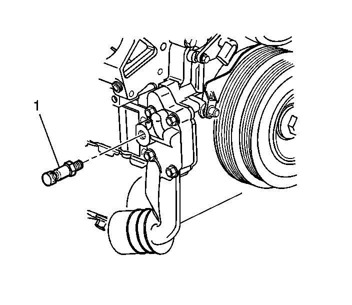

Noticed my oil light flicker on off a couple times. Switched my digital to oil pressure the next drive and it's normal is 130psi. Car didn't fluctuate at cold idle and oil level was good. After driving a few miles it would drop to the 80's and quickly bounce back to 130. After about 30 miles it started to drop further and then bounce right back. Seemed to be less frequent after turning ac and vents off, but still occurring. Worse on acceleration and better at steady speed. Any suggestions? I have a few thoughts but don't want to influence advice. Thanks in advance.

Is the oil level full and clean? Also, have you checked the oil pressure switch to make sure the wiring and connector is in good condition? Also, check to see if there is any oil leaking from the sensor.
Here are the directions for replacing the pressure sensor. I'm adding them so you for location and if you find it is leaking, it will need replaced.

ENGINE OIL PRESSURE SENSOR/SWITCH
Engine Oil Pressure Sensor and/or Switch Replacement
^ Tools Required
- J 41712 Oil Pressure Switch Socket
Removal Procedure
1. Raise and support the vehicle. Refer to Vehicle Lifting.
pic 1
2. Disconnect the electrical connector from the engine oil pressure switch (1).
3. Remove the engine oil pressure switch (1) from the oil filter adapter using the J 41712.
Installation Procedure
pic 2
Notice: Refer to Component Fastener Tightening Notice in Service Precautions.
1. Install the engine oil pressure switch (1) to the oil filter adapter using the J 41712.
^ Tighten the engine oil pressure switch to 16 Nm (12 ft. lbs.).
2. Connect the electrical connector to the engine oil pressure switch (1).
3. Lower the vehicle.
4. Inspect for oil leaks after engine start up.
5. Adjust the engine oil level to the full mark.

Thank you so much jacobandnickolas for your thorough response with replacement instructions, did not know a special socket was going to be required but glad I didn't have to make another trip to get it. 130psi was almost double what it is now, after a new sensor/switch (same thing popped up after searching both ways.) Now I average 65psi instead of 130psi. Higher when cold or accelerating and lower when warm or decelerating. Fluctuates only with rpms and not speratic anymore. Thanks guys you nailed it!

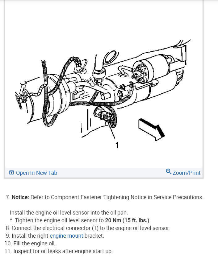

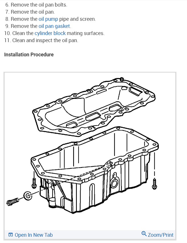

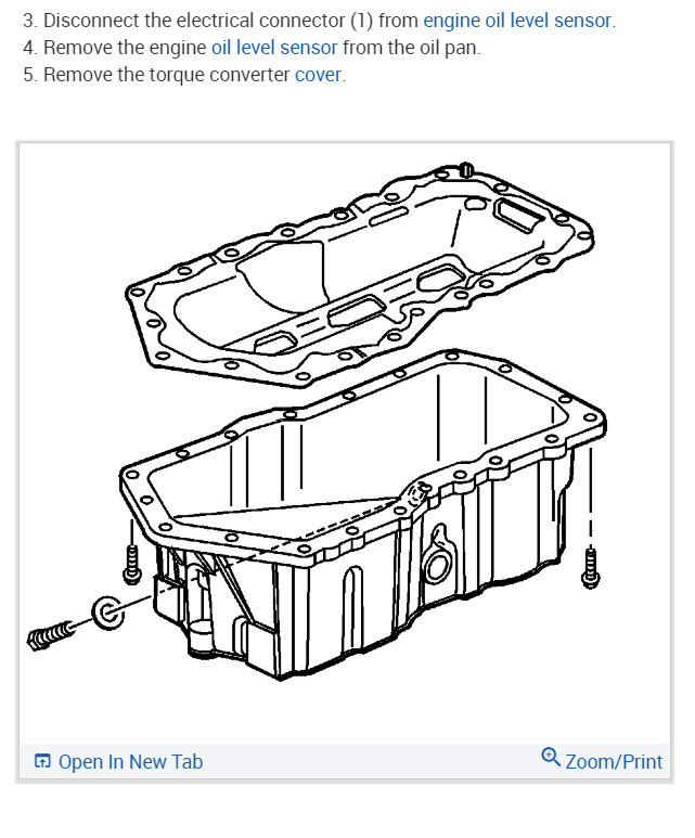

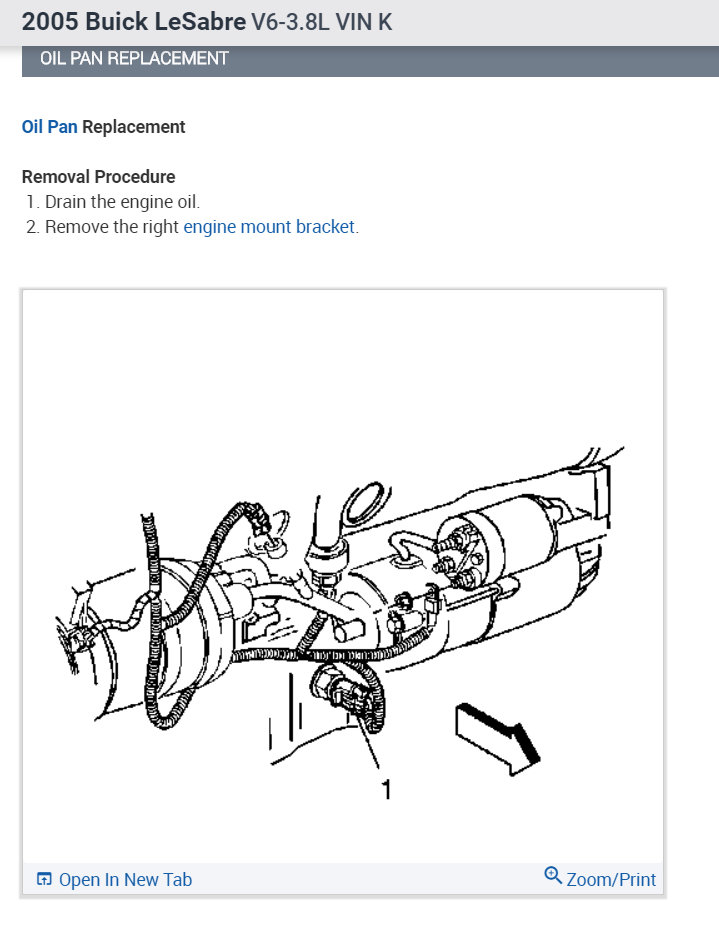

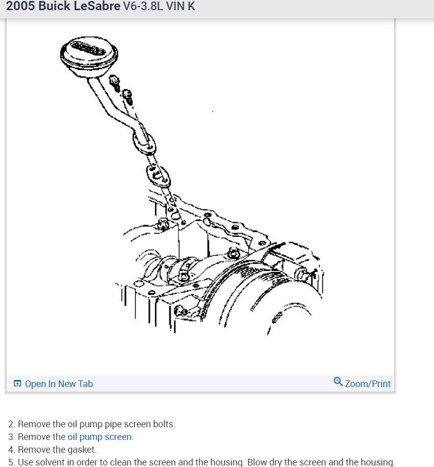

Okay what is probably happening is the engine oil pick up is getting clogged causing the low oil pressure issue can you confirm regular oil changes? If not here are diagrams and instructions to remove the oil pan so you can clean it. Check out the diagrams (Below). Please let us know what you find. We are interested to see what it is.
Jul 23, 2019 at 7:49 AM
