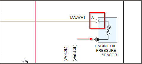

Oil pressure gauge needle is irratic
PACKERS27
  • 192 POSTS
Also, where do I probe the ground for ohms on the oil sender unit? Its only a one wire harness connector.
Monday, December 9th, 2019 AT 7:13 PM
Correct. You are going to need to make sure the level is proper. Then you measure resistance across the sensor which means you measure on the one terminal and then to ground. As you see the sensor is grounded straight to the block.
Tuesday, December 10th, 2019 AT 4:45 PM
PACKERS27
  • 192 POSTS
So ground to anything?
Tuesday, December 10th, 2019 AT 11:06 PM
You can but I would suggest using the case itself or run a wire directly from the negative battery post. If you use this then you never have an issue with getting a poor ground for testing purposes.
