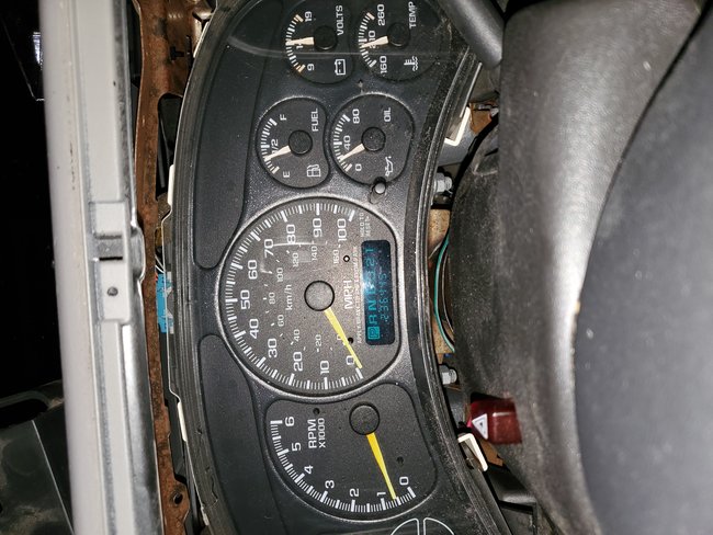

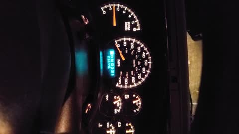

It seems like the needle is center in the middle at 40 but it bounces left and right from 20 to 60 really really fast. When I am accelerating, it seems to not do it. If I'm on the interstate and going a constant 70 mph or so, it hardly moves but still moves. There is no driveability problems and the oil levels are good. Maybe a sender?

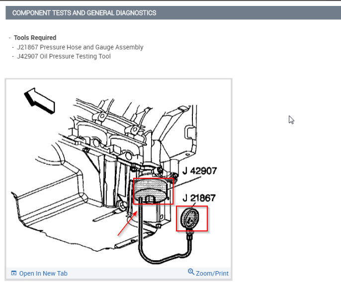

I've had the truck for a few weeks since I bought it. So since it's cool in the mornings it reads about 60 when first cranked. Then it goes to 40 but its hard to tell because it starts bouncing. The gauge changes as the RPM's go up but the needle starts to settle when I'm at top speed. What kind of gauge do I use and where do I hook it up at? Also, what kind of headache will this be to me if it is the pump?

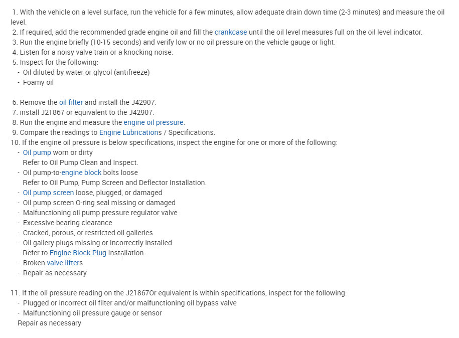

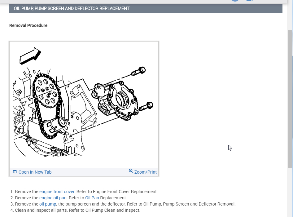

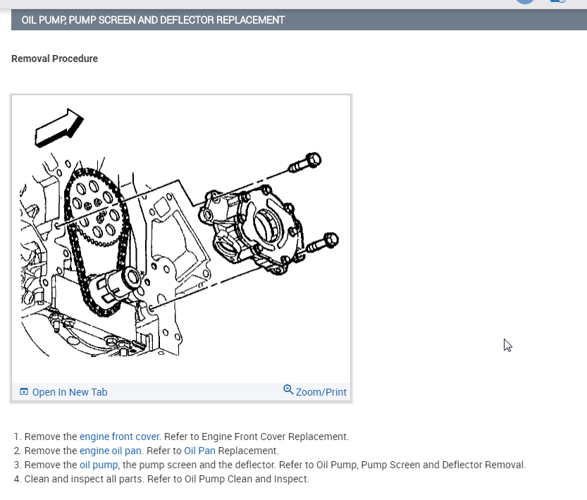

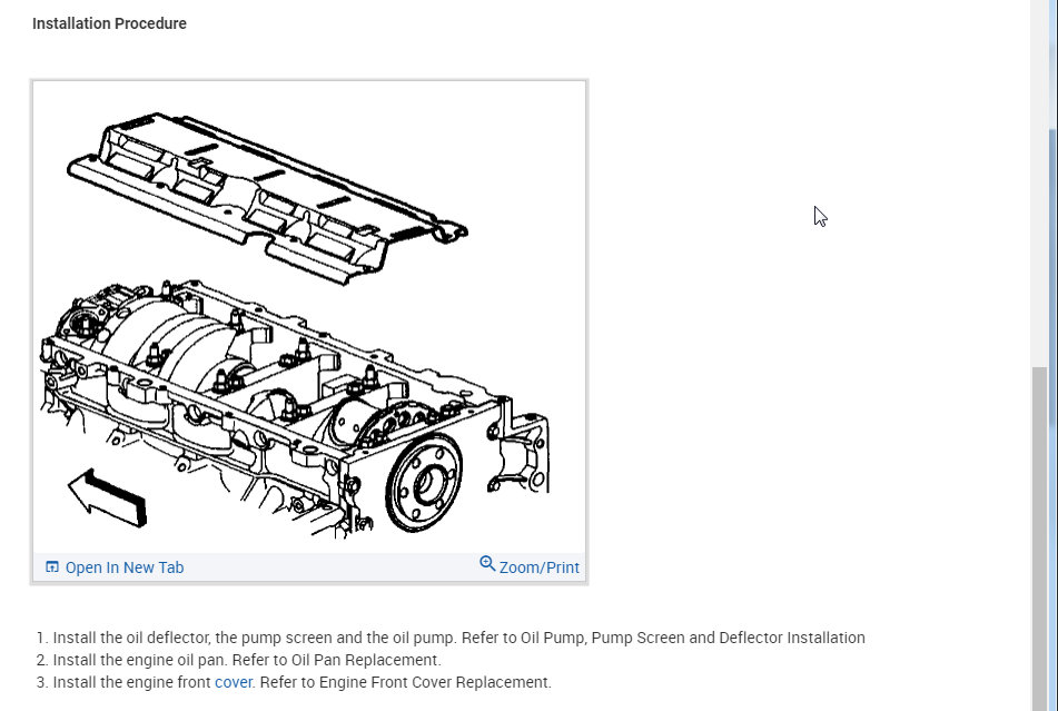

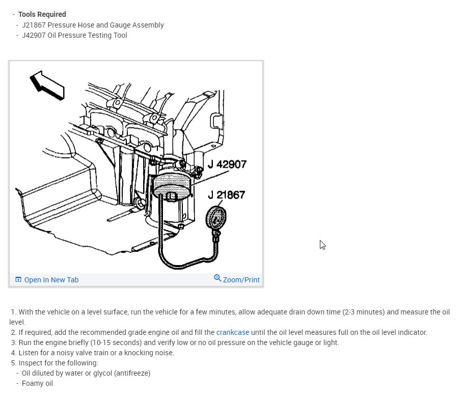

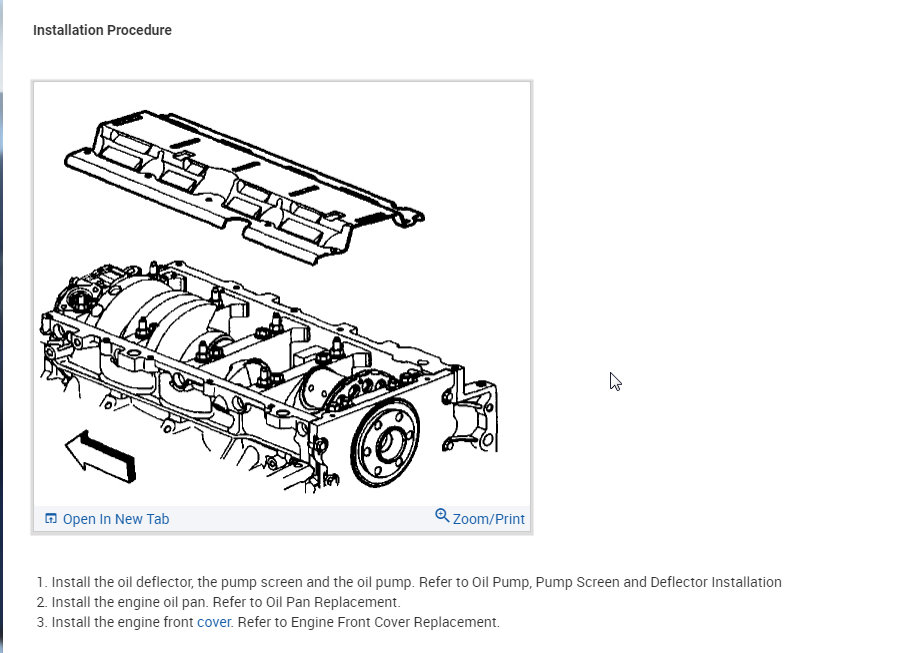

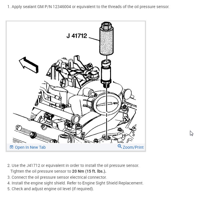

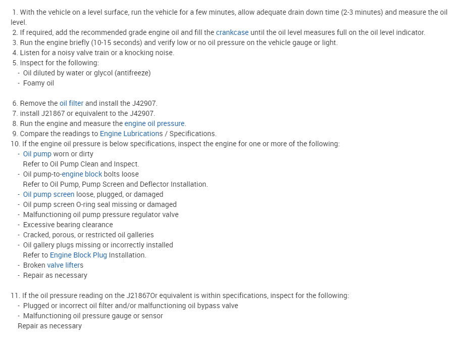

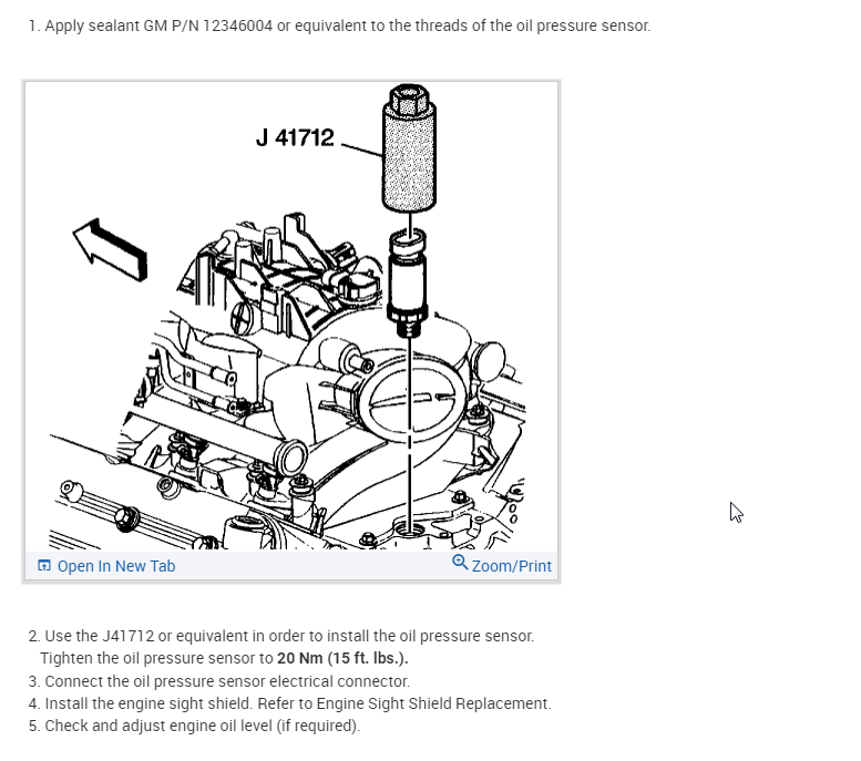

Okay. That sounds like the pump. A mechanical gauge will confirm it.
I attached the needed documents. As for replacing it, it is pretty involved. The oil pan and front cover have to come off but can be done.

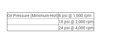

I apologize. Forget what I said about the oil levels. I checked it once and that's when the motor was warm upon looking to buy. I just checked it cold. It was a half quart low. I topped it off and cranked it. Here's what I noticed:
The oil pressure needle stopped acting crazy but there was a little quiver to it that may have fluctuated left to right by one little mark and that wasn't constant. I took these readings, as followed:
At idle: 58 oil temperature on cold start 160% at 800 RPM. Oil temperature at 50 180% at 500 RPM. I took the truck down the road, came back and at idle again 42 oil temperature at 190% norm 500 RPM. Then I revved up to 1000 rpm 58 oil temperature. 1800 RPM 65 oil temperature. 2200 RPM 65. 3000 RPM 74 oil temperature. After this, I notice a burning oil smell from under the hood as I've noticed since I've had the truck. I don't have any visible leaks from underneath and the motor looks immaculate with no oil to be found.

Can you get a video of the what the gauge is doing now? Sounds normal but it may not be once I actually see it.

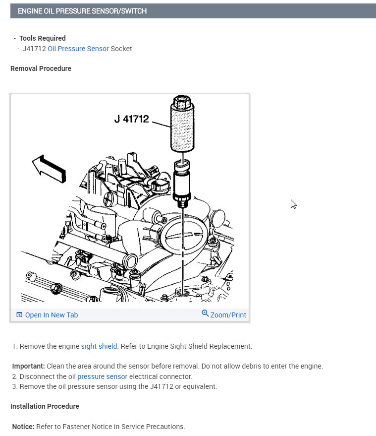

Okay, so I replaced the sending unit. I cranked it up from a cold start and the gauge is at 15 and hasn't moved a bit. It doesn't even move when I rev the motor. What's going on?

I just revved it up to 2,500 rpm's and the needle twitched between 15 and 20 and stopped back at 15. I tried to rev it up to do it again and it didn't flinch.

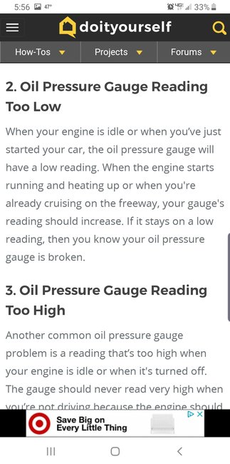

I was reading about the oil pressure staying low, but why was it flickering when I had the old sending unit in if the gauge is the culprit?

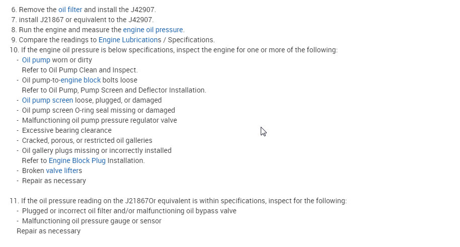

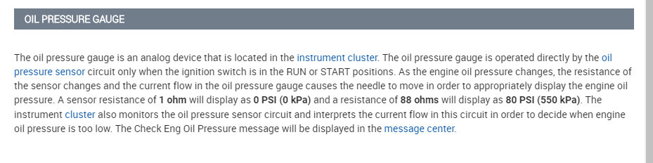

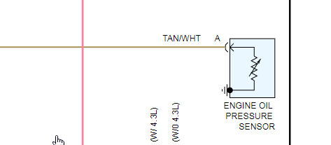

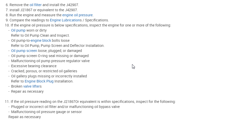

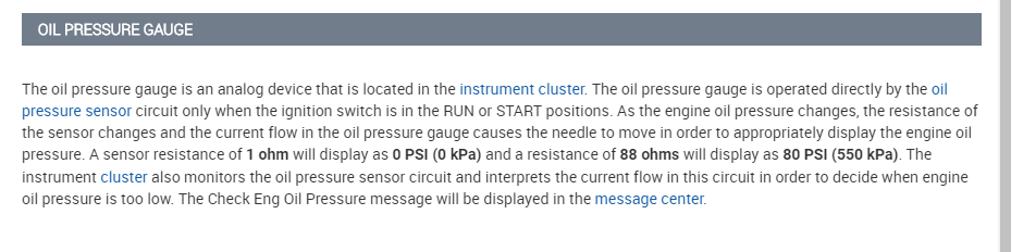

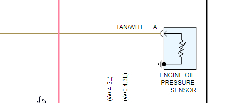

Okay. We need to measure resistance of the sensor and see what it is reading. This will tell us if the gauge is accurate.
If you don't know how to do that, you need a multi meter and back probe the sensor on each wire and put the meter on ohms. Then see what it says. It should read about 24 ohms if the PSI is 15.
As for your attachment, what they mean by the gauge reads low and stays low is it stays at 0 when you start the engine. Not a low reading like you have. If the gauge is 0 when the engine starts and remains there it is the gauge. Then that is misleading as well because when they say the gauge, that could mean the sensor as well.
If it were accurate it should say "if the gauge does not give a reading after the engine starts and warms up then the gauge is not giving an accurate reading and need to be diagnosed. When an engine is running, it has some amount of oil pressure so if the gauge says 0 then it is not accurate."

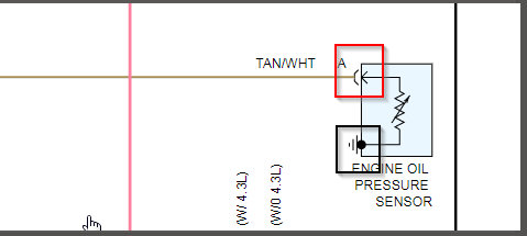

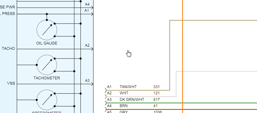

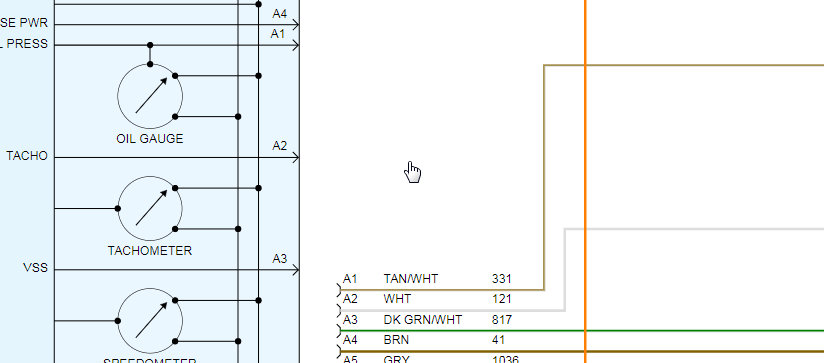

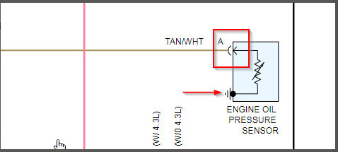

Correct, while the truck is running. You can penetrate the wiring if you are going to fix it. If not then you need to back probe the connector.
Here is a video that shows how to back probe. Around the 1:30 mark is the back probe portion.
https://youtu.be/g2ST8w_0w-Q
You put the red lead on the wiring leading to the cluster, and black on the ground. See the diagram.

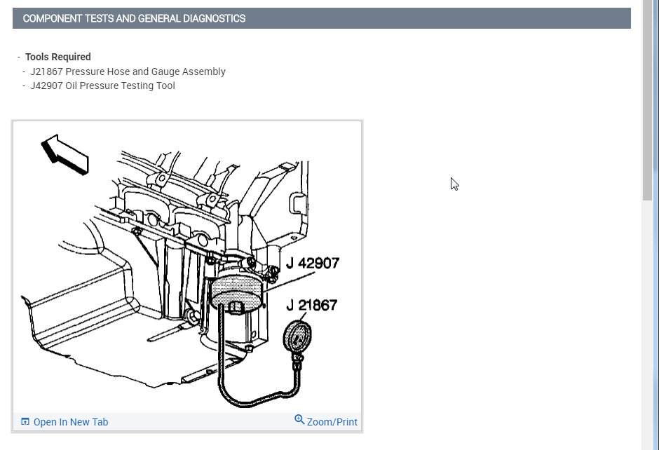

It could be. However, get a mechanical gauge and hook it to the engine and see what it says. If this is the same then you know the gauge is correct.

So I tried to back probe the connector. I got the lead in the positive wire but not sure if it was in there good enough. I shoved it in as far as it could possibly go. The only other wire I found next to it was not connected to the connector. It felt like it was connected to another connector on the bottom of the housing where the sensor screws into to. I tried to probe into the wire but don't think I got in there good enough because there is tape around the black wire. The gauge didn't read anything. Is there suppose to be 2 wires on top of the connector or just the tan one?

So the oil pressure gauge screws on the threads where the filter is?

Yes. There are two components to this. The first is the oil filter replacement adapter and the second is the gauge with the pressure line that threads into the adapter. I put a square around each and an arrow to the pressure line.
