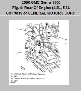

2006 GMC Sierra OIL PRESURE SWITCH
2006 GMC SIERRA
168,000 MILES • V8 • 4WD • AUTOMATIC
BRIAN1969
MY OIL PRESURE GAUGE WHEN YOU TURN KEY ON AND RUN VEHICLE GOES TO 550,SOMTIMES WHEN DRIVING GAUGE GOES TO 0 OR STAYS AT 550 , COULD YOU PLEASE TELL ME WERE THE SWITCH IS LOCATED ON THE MOTOR ?

Wasn't sure of engine litre size? Sometimes you can double-check that you have the correct sensor by looking at the wiring connector, three wires, Tan wire with white tracer-- gray-- black.
https://images.2carpros.com/forum/automotive_pictures/170934_2006_siera_1.jpg
