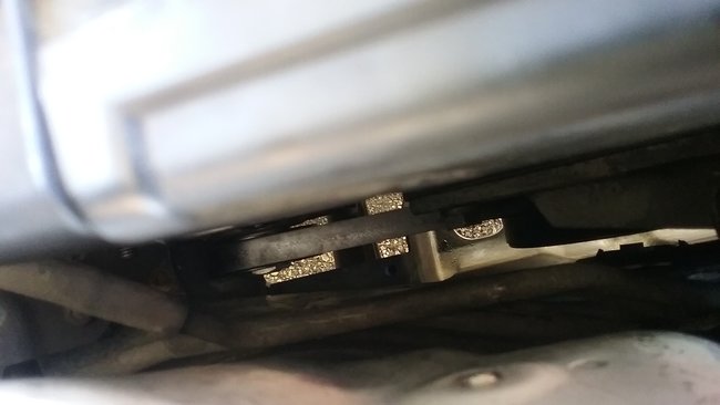

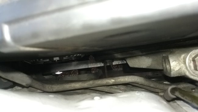

Hey Roy. Since the oil pan gasket replacement there has not been any leaks on the ground for sure and does not appear to be seeping around that area of the front of the engine. I did clean off the grease stains from the lower part of the timing belt cover and there does not seem to be any new run off of oil there. However, I still see some oil or fluid getting on the alternator drive belt only. Could this be it contacting an existing oily surface from the existing leaking seal of the oil pan gasket? Let me know what you think. Thank you again Roy for your time.
Michael
Jun 11, 2018 at 5:30 AM
Can you post a picture?
Jun 11, 2018 at 5:43 AM
MAGSENTONE
  • 85 POSTS
Yeah.
Jun 11, 2018 at 6:00 AM
MAGSENTONE
  • 85 POSTS
I turned the engine to show a moist spot.
Jun 11, 2018 at 6:02 AM
Is this after you washed it off?
It almost looks like power steering fluid.

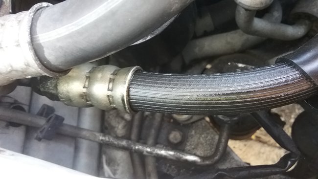

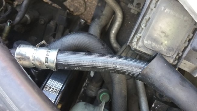

Yeah, I gave one side a mild spray of brake kleen last night but turned it over now to show if there was fluid. Just had a new pump installed but original lines. I noticed the lines at the top get moist under the insulation cover. Here look.
Jun 11, 2018 at 6:19 AM
That is a leaker. It is building up under the cover and dripping down.
Jun 11, 2018 at 6:21 AM
MAGSENTONE
  • 85 POSTS
Yea, I was thinking. I do not think it is motor oil because I do not see any seepage. But the oil pan gasket for sure because no leaks on floor so like you said good move on that. So about the power steering lines you think maybe high pressure lines?
Jun 11, 2018 at 6:24 AM
Yep, absolutely.
