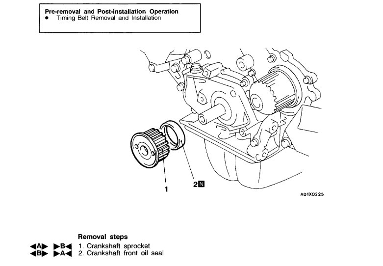

  • 85 POSTS
Hey Roy, I noticed an oily area located on the bottom part of the timing belt cover. I am thinking an oil pump seal but it is just below the drive belt that runs the alternator yet it appears oil keeps getting on it and sometimes causes a noise.. Any idea why? Thanks for your help Roy.
Michael
Jun 5, 2018 at 10:37 AM
That is the front crankshaft seal.
Picture below.
Jun 5, 2018 at 10:58 AM
