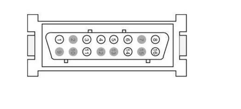

Hello, my name is Michael and I am having an issue when a DTC scanner is plugged into my obd 2 connector. When scanner is plugged in it sometimes powers up and then turns off and then has trouble communicating with the scanner. I was wondering could it be that one of the pins is bent or even clogged with dust or debris causing an unclear reading? Also, where I got the car smogged, the the guy was able to get it go communicate and passed smog but advised me to get that issue fixed. He said he was able to check the monitors without using the obd2 port, how is that done and get the car to communicate without using port? Any ideas to this situation? I highly appreciate your thoughts and ideas. Thanks so much and God bless.
Michael.
Mar 4, 2018 at 12:40 PM
Good morning.
Yes, check the pins on the port for being spread or damaged. From plugging and unplugging, it is common for the pins to spread out.
No, you cannot communicate with the monitors without access to the OBD 2 port.
Mar 4, 2018 at 8:46 PM
MAGSENTONE
  • 85 POSTS
Okay, will do with my multi-meter. thanks a lot.
Mar 5, 2018 at 2:43 AM
Diagram attached. pin 16 is power and pin 4 is ground. make sure they are correct.

Hey Roy, it is Michael. So I tested pin 16 and it reads 12 volts, on pin 4 for the ground I disconnected negative battery and set meter to ohms but could not get an accurate reading. Kept bouncing around and then went to 0. What setting of ohms do I set it to, 20,000 or 200,000? There are like five settings on ohms. Thanks again.
Mar 6, 2018 at 9:07 AM
Okay, to check the ground do this, reconnect the battery and use your voltmeter. Put the black lead in pin 4 and the red lead in pin 16. If you read twelve volts, the ground is good.

Hello Roy, Ob2 port is working as I checked the ground and positive both with the voltmeter and still get 12 volts so that is good, thanks for that. It appears the OBD II port and the power locks are tied into the same fuse because it will not register with the power lock fuse out. I have another question regarding installing a shut off switch to the ignition switch. Do I tie the switch into all four ignition wires which are 12 volts constant, starter, ignition, and accessory? Or? Please let me know plus I think the switch rating has to match the 30 amp ignition switch fuse in the fuse box, right? Please let me know and as always thanks again Roy.

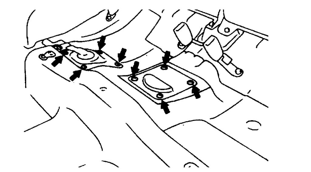

I just looked up the diagram of where my fuel pump and lines are and it appears I would have to drop the fuel tank just to get to the wiring harness.Anyway of just tying up the switch to the ignition wiring instead?
Mar 25, 2018 at 10:34 AM
Okay, no, the pump is accessible from the top. Remove the rear seat bottom and there is an access plate to get to the wiring.

Hello again Roy. So I removed the access plate which is the one under the removable rear seat behind the passenger and found the plug giving the fuel pump power there is a harness going through a rubber boot and then then wires connecting to the plug or socket which the blue and black is power and there is a black ground. should I just wire it into the positive near the plug? not a whole lot of room to splice there with a crimps and I cannot see those power and ground wires further back in the harness that split off to the power plug that connects into the socket. Please let me know when you get a chance. Thanks so much.
Mar 26, 2018 at 6:47 AM
Okay, yes, you can tap into the power or the ground. which ever is easiest for you.

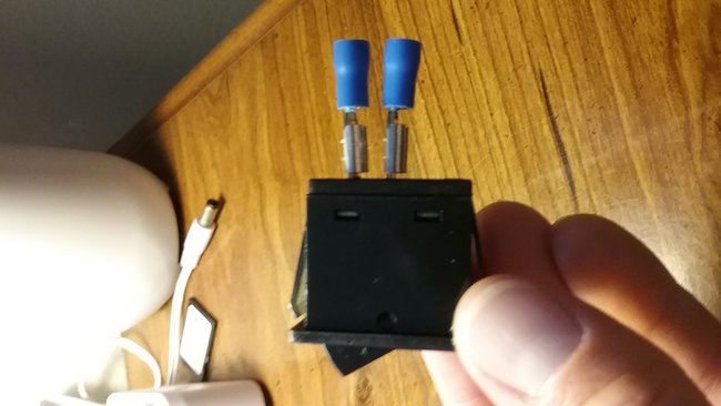

One other thing Roy, I could not find the amperage on my fuel pump and since I cannot find the fuse I guess my car uses a relay which I believe is above the fuse box compartment under the hood. So my question is my switch is, 20A 12v dc 240 watt plastic black on off switch using red 16 gauge automotive wire, is this okay?
Thank you Roy.
Mar 27, 2018 at 3:25 AM
sure, it is good. you can use 18 gauge as that should be the gauge running to the pump.
Mar 27, 2018 at 5:01 AM
MAGSENTONE
  • 85 POSTS
I would have to go buy 18 since I only have 16 gauge on hand. will 16 work or cause a possible fire? sorry to bother you again Roy.
Mar 27, 2018 at 5:28 AM
no bother at all. 16 is good. it is heavier. if you were using thinner then yes, that would be no good.
the 16 is fine.
