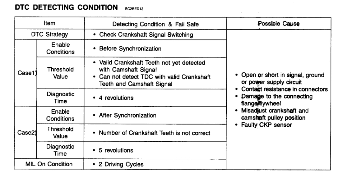

i have a p0335 code once that occur with a hiccup but after that it never shows again. i have checked crankshaft position sensor after that but it didn't seems bad at all.
this problem makes me crazy for longer than one year.
Nov 9, 2019 at 8:57 PM
Seem bad? How did you check it?

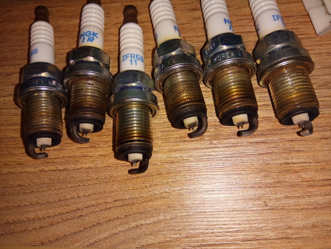

I'm searching every where in last year i can tell i have read almost every forum and topic about sluggish or poor or slow acceleration. but i can't figure it out if it's timing. so why there isn't any rough idle or misfire or engine noise ?
if it's fuel pump why fuel trims are about 0 and why it's intermittent like something regain and lose?
Nov 10, 2019 at 7:46 PM
DANIYALKZA
  • 111 POSTS
it is my spark plugs.
Nov 10, 2019 at 8:02 PM
Timing does not necessarily end with rough running especially if it is off maybe 1 tooth.

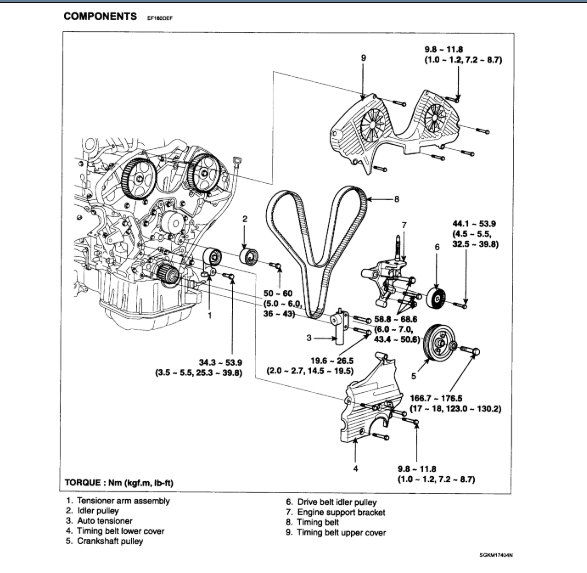

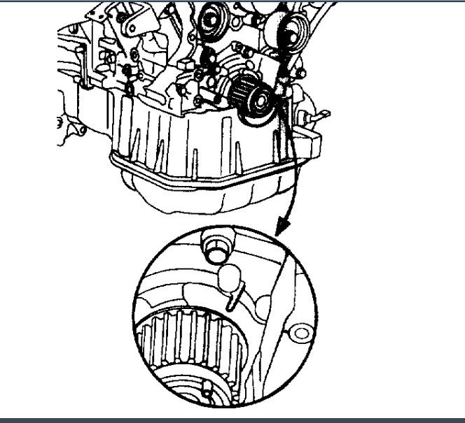

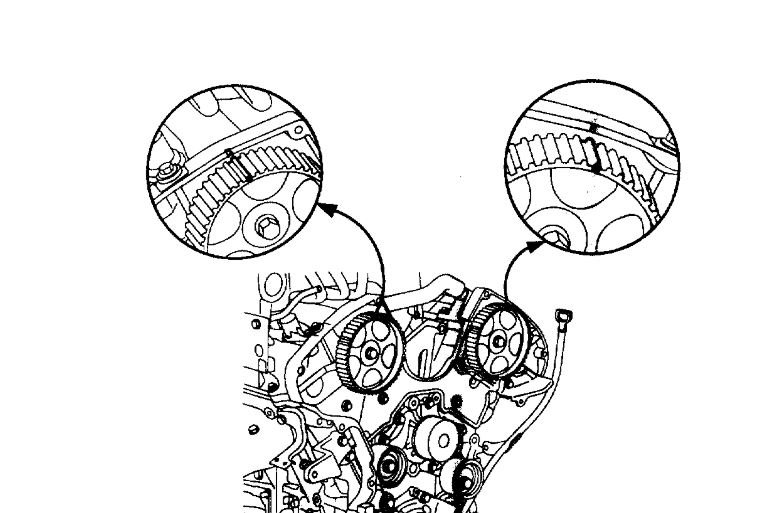

but before that can you help me to check timing mark by myself? because I don't trust the mechanics out there.
do i need to rotate engine?
Nov 10, 2019 at 9:29 PM
Once the cover is removed. hand rotate the motor until number 1 is lined up on the crank pulley as in the photo I attached.
Then look at the cam gears that I attached as well. They need to be exact.
Nov 10, 2019 at 9:36 PM
