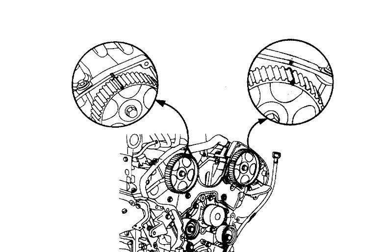

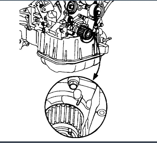

i have checked timing myself and it wasn't off even by one tooth.

Timing is what I am still concerned with. That is why I am asking about engine vacuum.
Nov 29, 2019 at 7:07 AM
DANIYALKZA
  • 111 POSTS
timing checked twice and I'm completely sure it's not timing problem.
