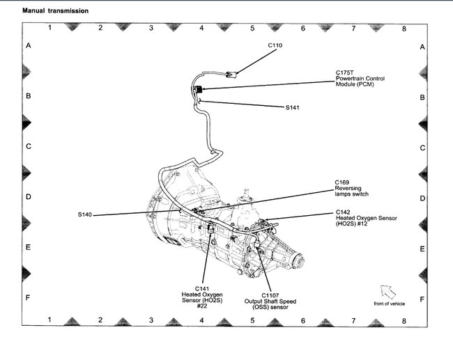

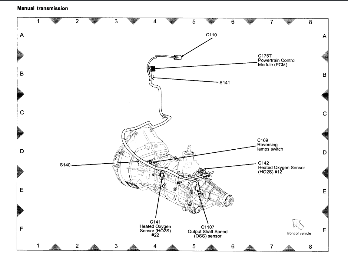

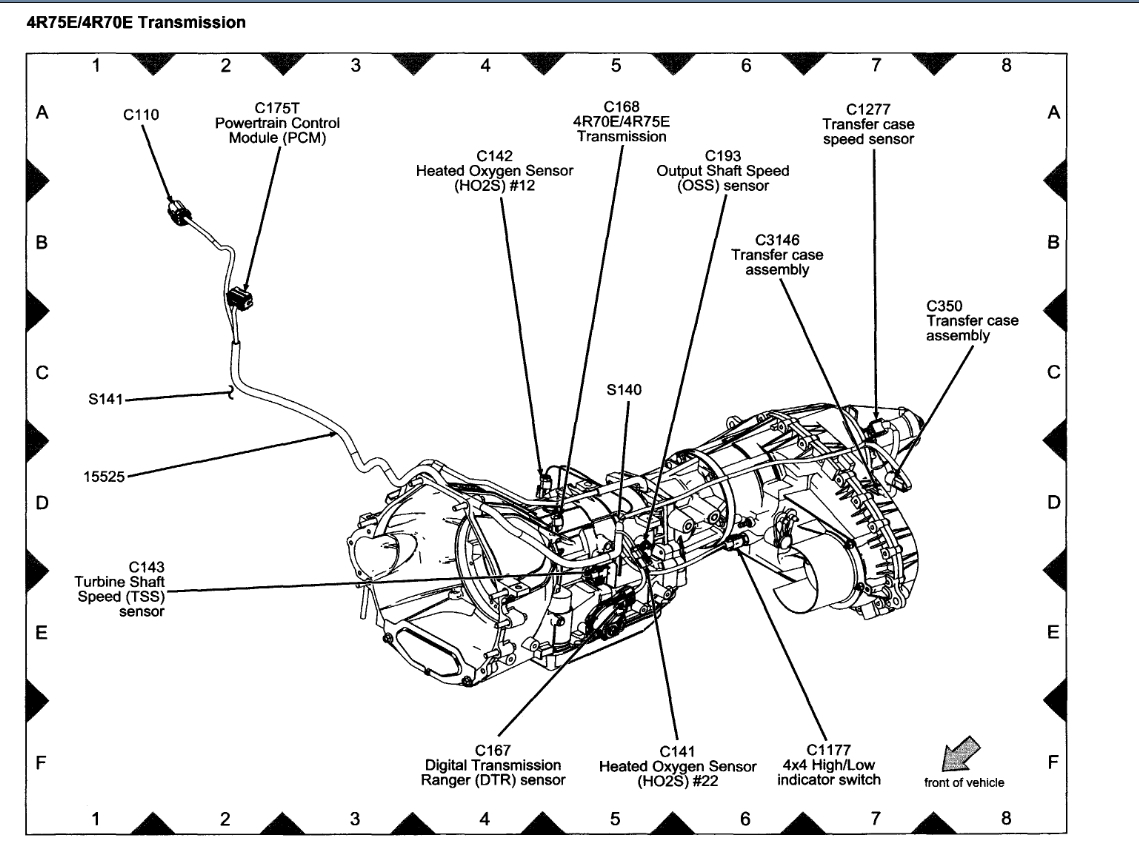

This sounds like you have a shaft speed sensor that is out. Does the speedometer work? If not here is the location of the vehicle speed sensor. If so we should run the codes

Check the speed sensor. It is either located on the tailshaft of the trans or on top of the rear differential housing. If the computer can't sense speed, it won't feed info to the speedo/odometer and it also won't know when to shift. O/D light will probably flash a P0500 code, but check to be sure.
