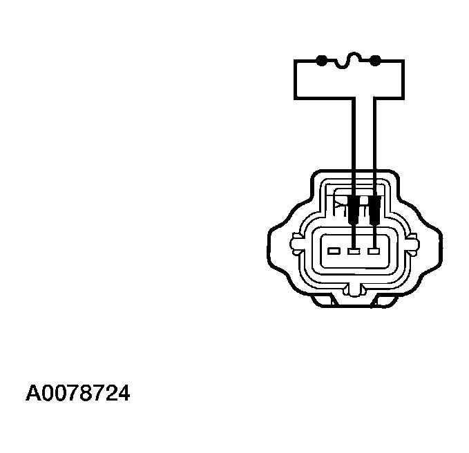

BRAKE WARNING LIGHT ON. INSPECTED FRONT AND REAR, REPLACED PADS, AND ROTORS FRONT AND REAR. FLUSHED SYSTEM. BRAKES ARE WORKING PROPERLY BUT WARNING LIGHT IS STILL ON. HAVE UNPLUGGED PARKING BRAKE SWITCH,MASTER CYLINDER, AND ABS MODULE,WARNING LIGHT STAYS ON. ANY SUGGESTIONS WOULD BE APPRECIATED.

Since you unplugged everything and the light remains on, there has to be a short to power. Have you checked any of the wiring for damage?

It won't let me copy. Listen, I have been looking through the manual to try and figure out what could be causing the issue. Are you aware that by disconnecting the brake fluid level switch, the light will stay on?
Here is a test for the level switch. Disconnect the plug at the level switch. Place a 5 amp fused jumper wire between pin 2 and 3. See pic.
Let me know if the light goes out.

LIGHT HAS GONE OFF. MUST BE LOOSE CONNECTION OR FLUID LEVEL MALFUNCTION. THANK YOU FOR THE INFO FOR TESTING THE SWITCH.
