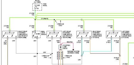

DAVE GIVLER
Electrical problem
1994 Ford F150 V8 Two Wheel Drive Automatic 190000 miles
My door ajar alarm is permanantly on while my Headlamps are on. They belong to the same fuse on the vehicle. How do I deactivate this chime?
Jan 22, 2017 at 11:41 PM (Merged)
DAVE H
  • 13,384 POSTS
https://images.2carpros.com/forum/automotive_pictures/266999_150_8.jpg
