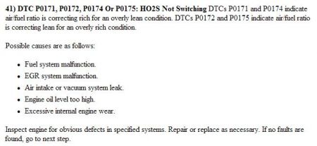

QUACKERSMACKER
My check engine light came on. Mechanic traced it to codes PO171 and PO174, lean bank 1 & 2. Only symptoms of problem is intermittent rough idle. So far we have changed fuel filter, cleaned air intake, checked for vacuum leaks (OK), checked fuel psi (OK). Engine size is 5.4L. Any ideas as to what to look for? Thank you
Sep 9, 2020 at 6:36 PM (Merged)
BLUELIGHTNIN6
  • CERTIFIED EXPERT
  • 16,542 POSTS
Hello Thanks for the donation Some info. about these trouble codes are below..
https://www.2carpros.com/forum/automotive_pictures/261618_Noname_489.jpg
If these inspections all come out clean let me know and I will continue with further troubleshooting. Thanks for using 2CarPros.com!
